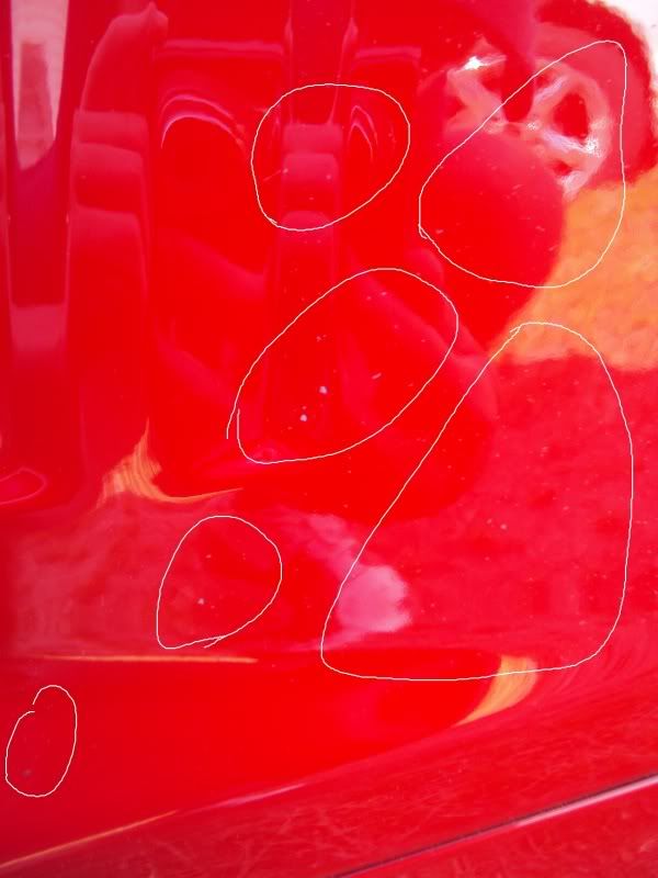

Check out the areas I circled closely and you can really see the "sand blasted" looking pattern with the really small chips.
What area of the car am I looking at in the photo.
Here is something interesting: my first mil test was on my car. I used two different testers one is magnetic and the other electronic. Both had the same readings. I tested areas all over the car. My car has 9.5 mils of paint!!! The brand new Mercedes in our shop had 4.8 I believe my car may have gone through the paint process more than once. Today I am going to stop by the local GM dealer where 3 new ones are sitting and test them. Will keep you posted.
That's the area right in front of the rear wheels the "gills".
Really? Well do you think it may be a prep problem or a bonding issue? I'm just really confused how, if my car also has that thick of paint, it could chip so easily. I'm scared to wash my car as often as I usually do haha dont want to find more chips.
