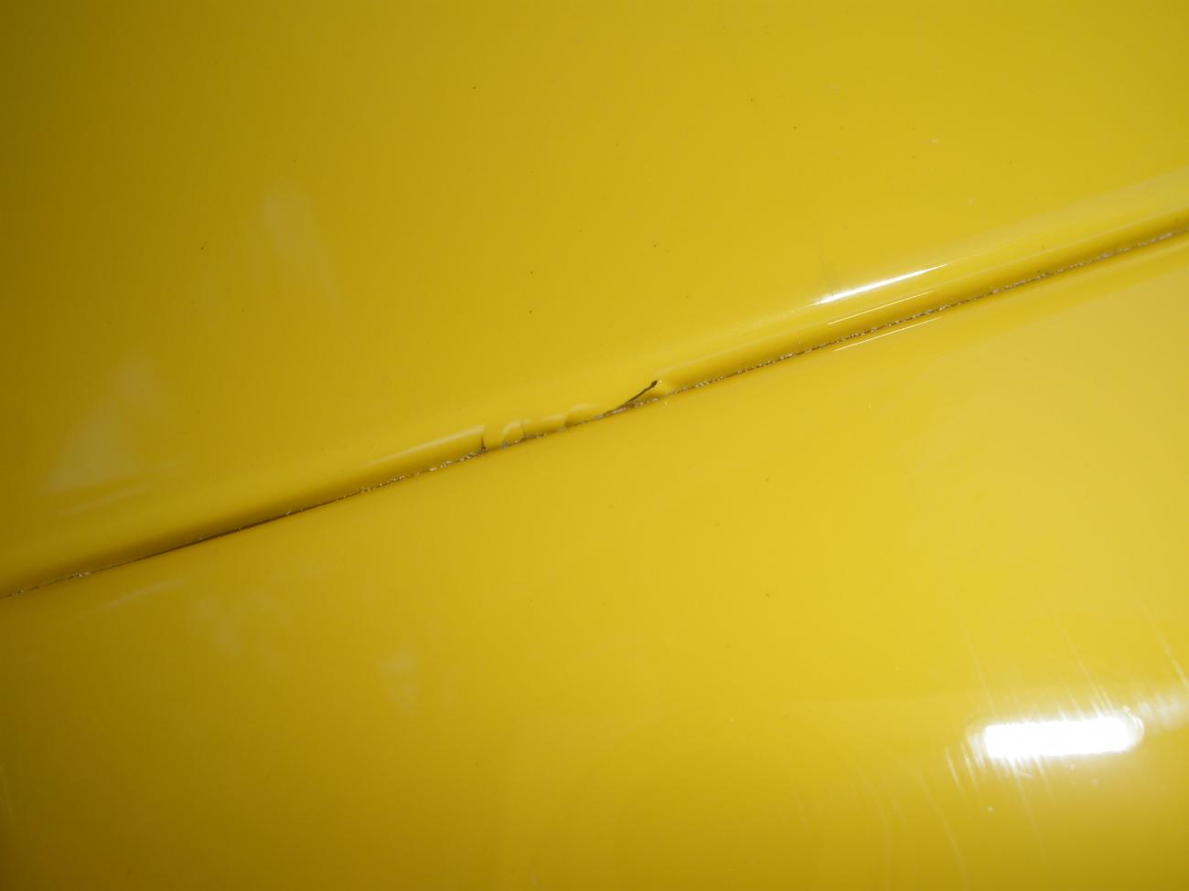

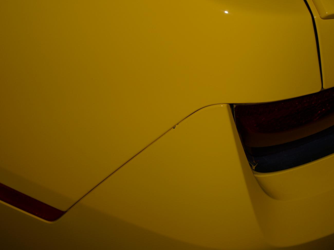

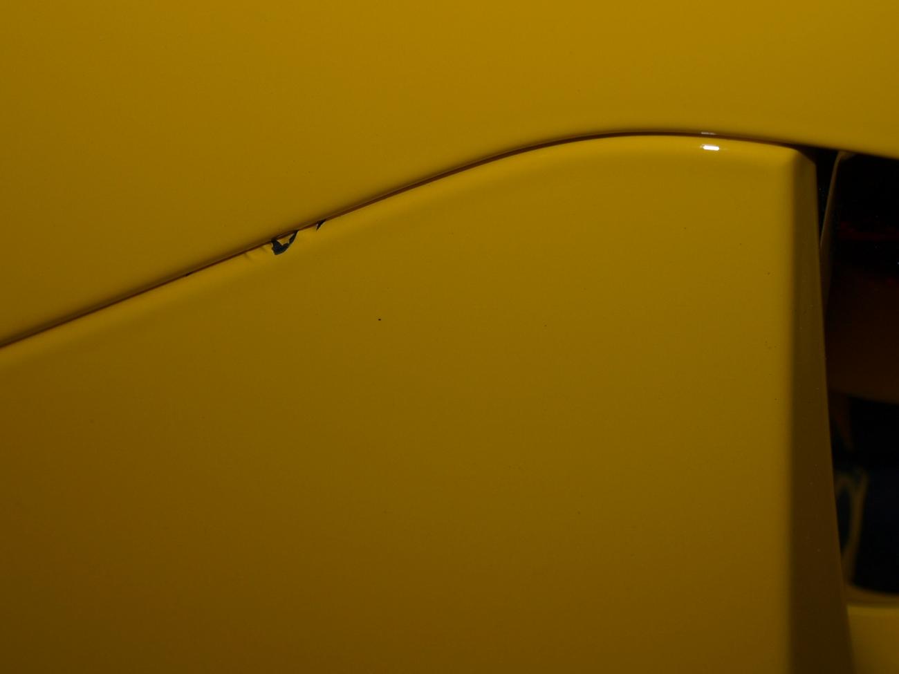

Has anyone else having paint issues. The rear bumper where it meets the car body has a paint chip and peal issue on my yellow. dealership is being wonderful about it but i have to give up my BeBe for the paint fix for 3 days Second one that i know of..

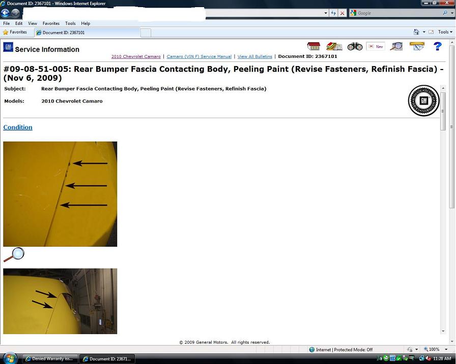

This has been an issue for the Camaro. I believe there is a TSB out. I believe the dealership should know this. I believe they figured out how to put a spacer in the bumper somehow, not sure. I have to have mine done in the spring.

Is there anyone in hear that actually has had the TSB done to fix this problem?

This is where the front bumper and the fender meet

Have you taken it to your dealer they fixed mine up in 4 days, no more problems sense.
Originally it was to be 3 but they took an extra day
Yes. I had it done. My car was Rally Yellow also. The dealer broke some of the tabs on the bumper cover when he pulled it off to paint it, so I ended up getting a whole new bumper cover out of the deal.
When you pop the trunk up top, in back of the tailights there are two plastic push-pins. Push pin furthest back gets replaced with a j-nut and a bolt on each side. This hard locates the bumper cover so it doesn't rub against the quarter panel.

Is it the two panels directly touching, and one happens to shifts a little, which peals the paint?
