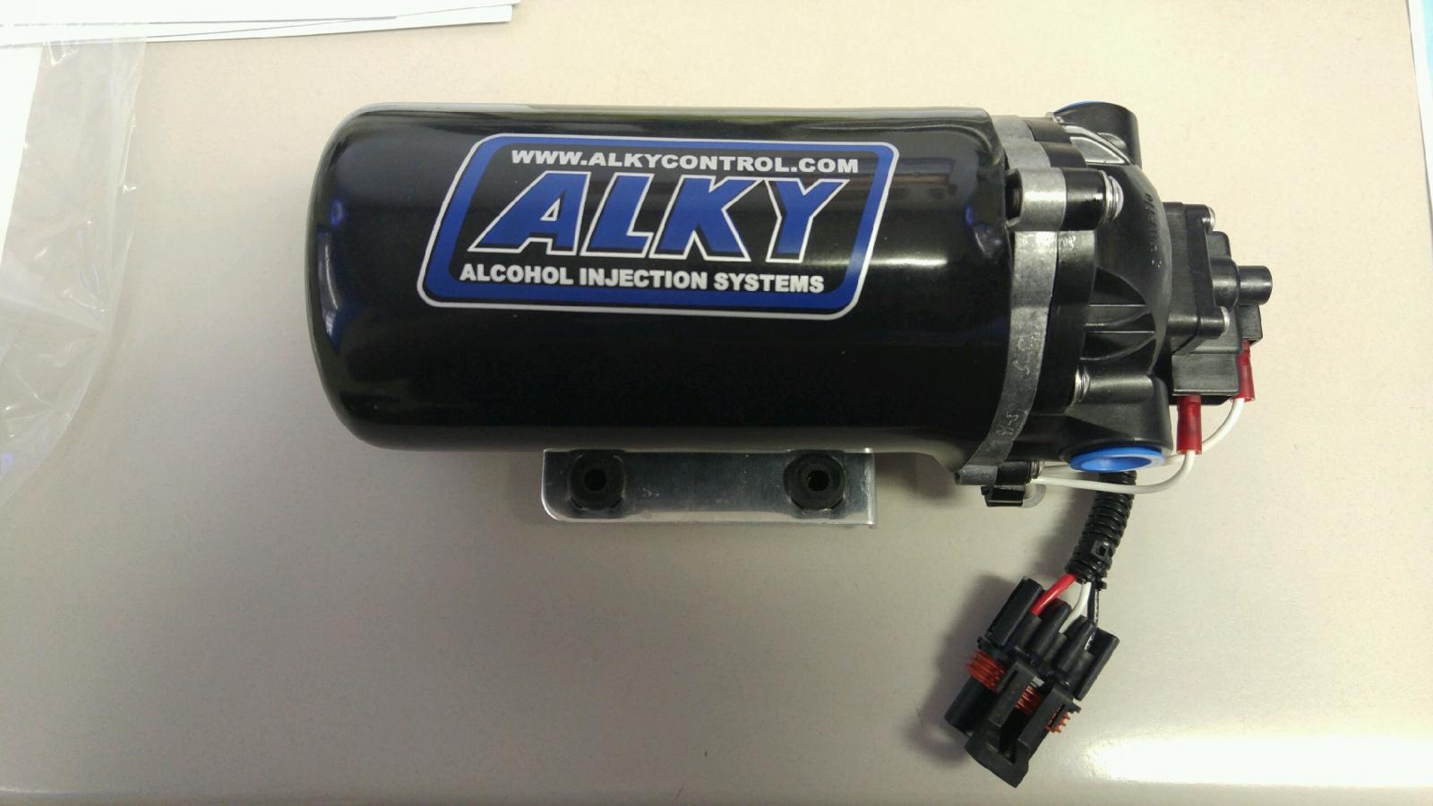

Alky Control methanol injection kit.

Some install pics:
