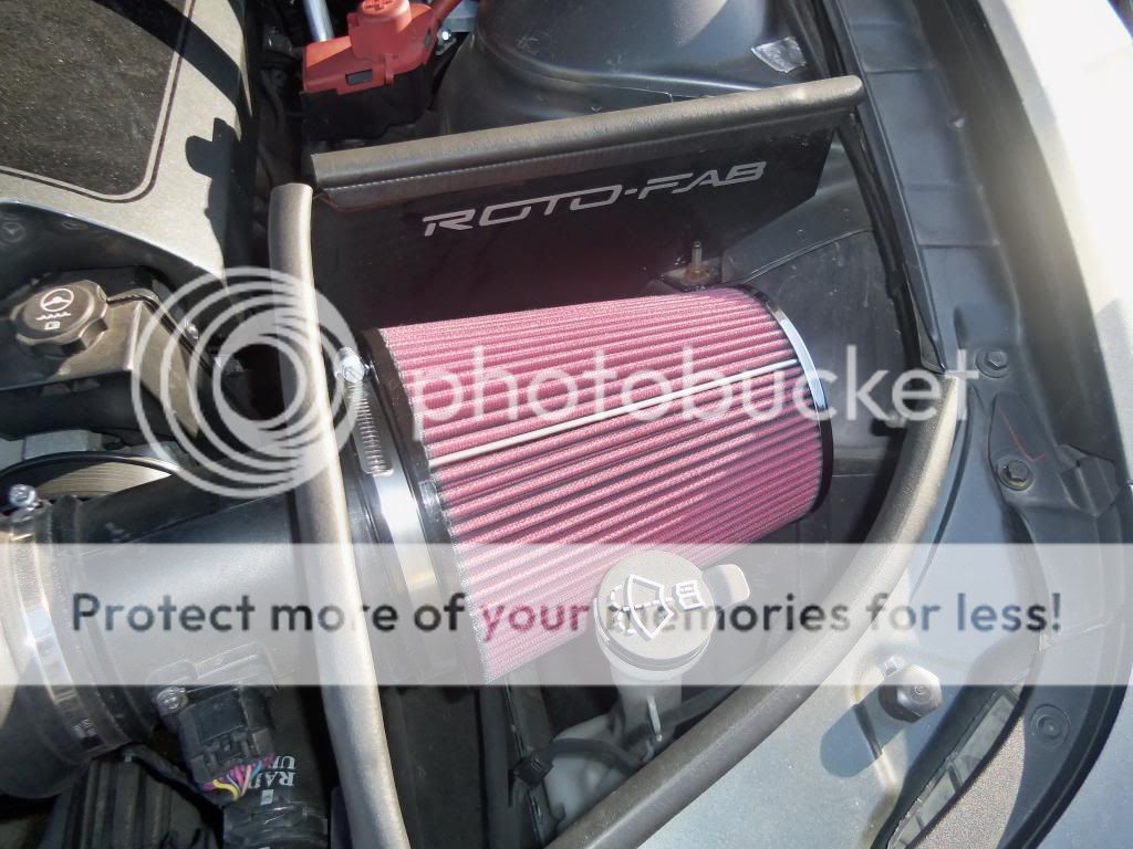

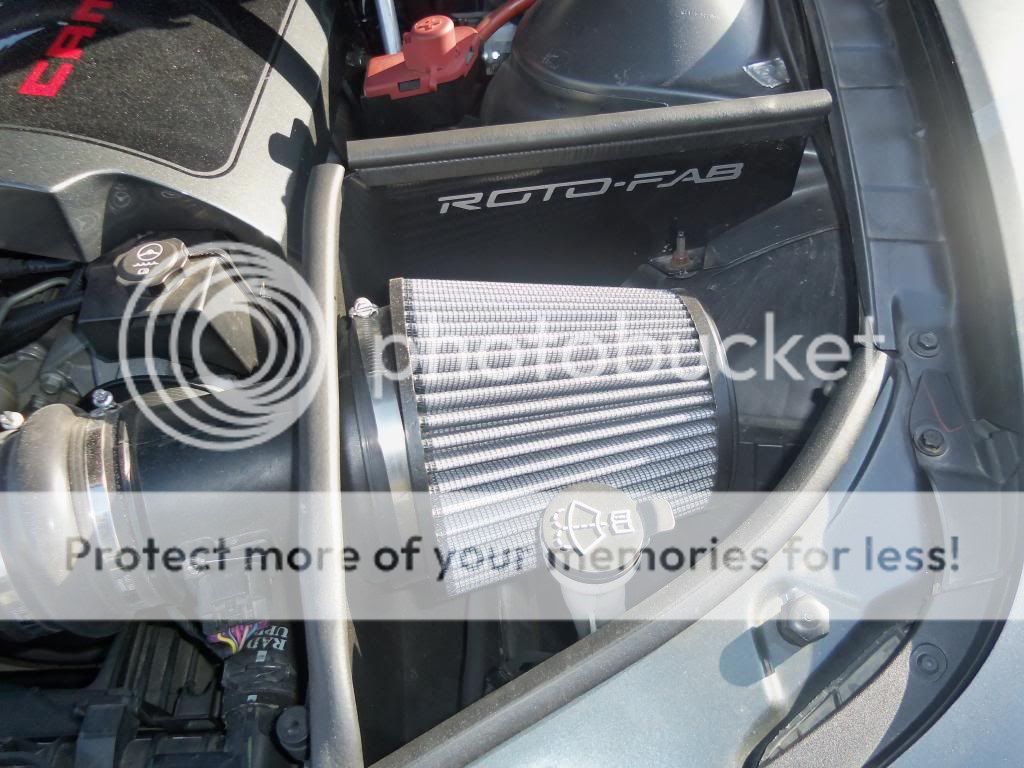

I haven't posted in here in a while, but I have made some modifications. I have since added Solo J pipes (pictures to come) to my exhaust system, and I decided to order a replacement "oil" air filter to replace my "dry" filter from Roto-Fab.
OLD FILTER
NEW FILTER (The new filter is "slightly" bigger than the old one)

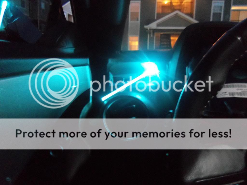

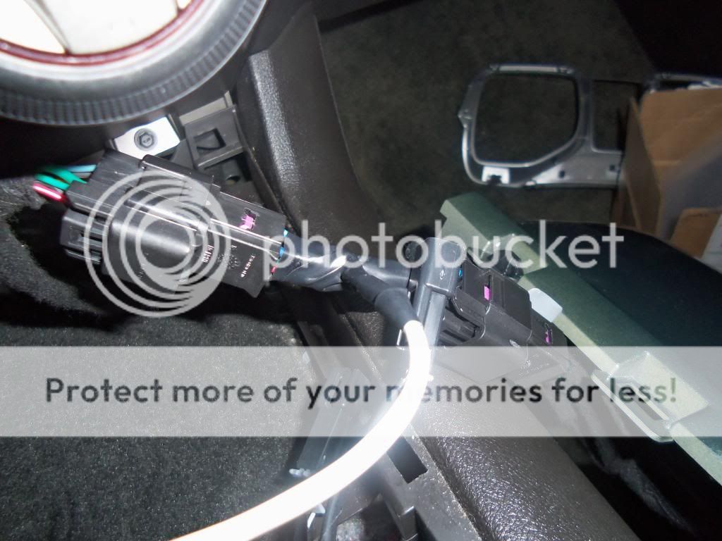

I also ordered the ABL Dash lighting kit from Gen5Diy.com. Ofer's ABL kit with the plug n play harness is one of the best kits I've ever seen on the market.
The Plug N Play harness that plugs into the 4 pack gauges, allowing you to draw power from the ABL wires without tapping into any wires.
ABL Light pipe (ice blue)
Harness plugged in
The female connectors that plug into the light pipe harnesses

So far I only mocked up the driver's side, and fished the wire through the dash to plug it up. I still have to modify the dash panel to make sure the light pipe fits properly and has the lighting effect it's supposed to :

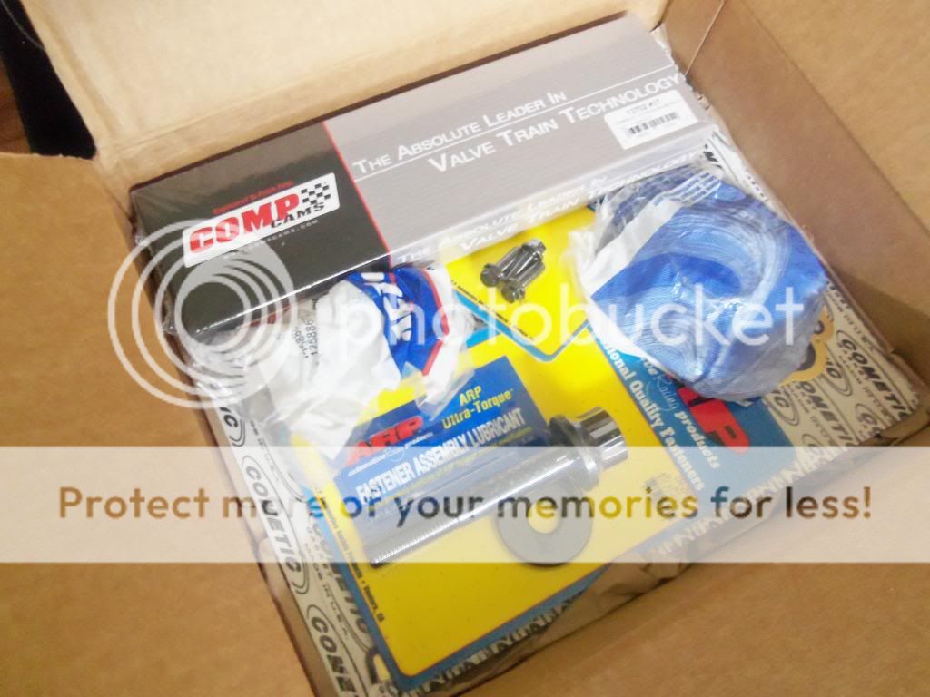

UPDATE : To date this project will be my biggest thus far on the Camaro. It took a lot of deciding and going back and forth on my decisions to finally come to a conclusion on what I wanted to do.
I've always been big on F/I setups on cars, just because of the "power per dollar" factor. But as most of you know, with newer cars, the F/I kits aren't exactly "cheap". I kept having to decide what my goals were if I went with a P/D Blower setup, and was it actually going to be "cost effective" for what my plans are with the car?
After thinking about it, and talking to many forum members, I decided that I would not go the F/I route. I decided I would do something different from 90% of the Camaros in my area (and the areas I've been in) and go with a Mild street cam with Electric Cutouts.
I decided with this setup, because I spend more time driving the car to work and around town, than perfromance driving, and it would basically be a "cruising and fun factor" setup for my car.
Well I talked with Litle88, Nightmare2012, Darth Emma, as well as TSP about a good setup, and this is what I came up with :
TSP Cam 229/236 .624 / 615" LSA 112
BTR Chromoly pushrods
BTR Platinum Dual valve springs
LS2 Damper
3 Bolt Cam conversion kit
Comp Cams Trunion Upgrade Kit
Melling 10296 H/V OP
Cloyes C5R Timing Chain Set
Powerbond 25% UDP
My goals for this setup are 465 rwhp to 475rwhp. I'm only adding electric cutouts for the sound and fun factor of driving around a loud cammed car. So far these are the parts that have come in :
And I also ordered the melling 10296 this morning from BTR (Brian Tooley Racing), as the pricing and free shipping was better when compared to other websites. MORE UPDATES TO COME!

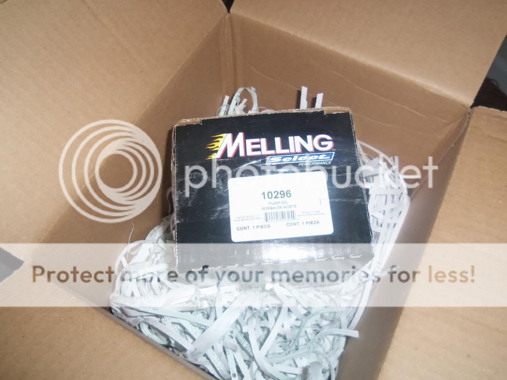

UDPATE : My Melling 10296 High Volume Oil pump came in today from BTR :

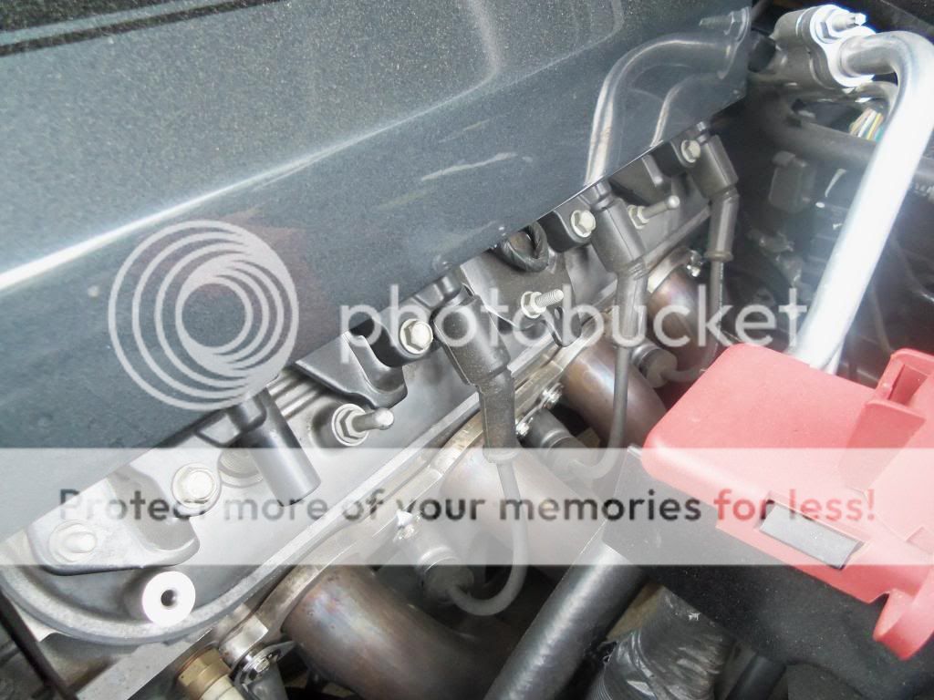

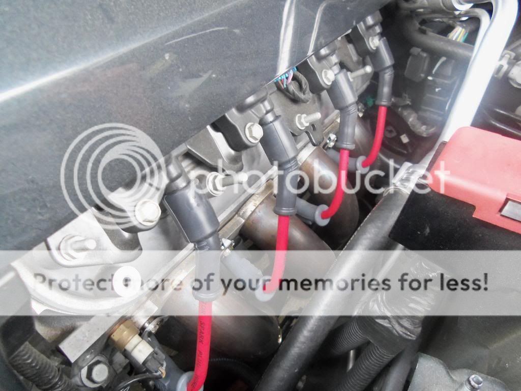

I went ahead and installed the new Spark plug wires, makes the engine bay look slightly better over stock :

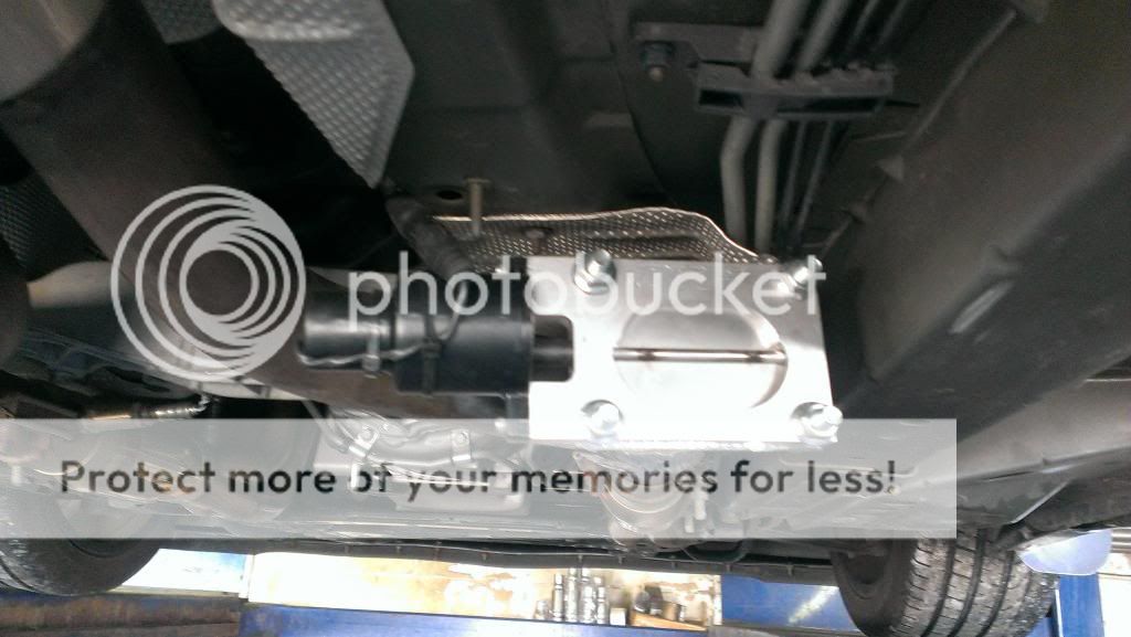

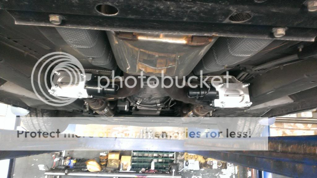

I was able to have my QTP cutouts welded and I did the wiring today, I will have pictures tommorow. I didn't take pictures or video today because the shop who welded them welded them at an angle, and gave me almost zero ground clearance when driving around normally. This is not acceptable, and I will have them re-weld them tommorow morning.
LS3 SS is offline   Reply With Quote
Old 04-20-2013, 12:00 PM   #110
LS3 SS
Drives: 2010 Cyber Grey Camaro SS (LS3)
Location: Clarksville TN
Posts: 2,275

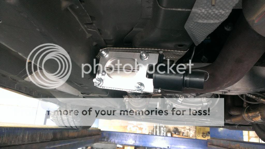

Ok, here is the finished product of my QTP electric cutouts :
These are VERY fun to have. I have the switch mounted right by the side of the center console, next to the shifter.
Here is the rear section of my exhaust setup, custom resonators installed with the J pipes (makes the car extremely quiet for long trips and highway drives) :
