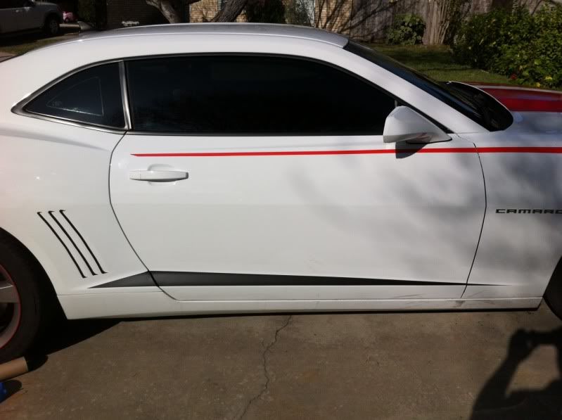

Originally Posted by 73vette View Post
Those roof stripes turned out clean! How'd you shoot it up there? I tried roof stripes, and well.... not good.
Also, did you use the glossifier?
I have an image of him standing on the roof, or doing a tom cruise/mission impossible thing hanging above the car from the rafters in his garage
thanks! it took me 6 hours to tape everything off perfectly. i took the picture standing in my trunk hunched over my deck lid haha and no the standard black plastidip looks identical to the factory rally stripes.

Originally Posted by Archaic2021 View Post
Gonna pick some up from home depot later I have alot of plans for my car. I was wondering you guys that are lining stuff off how are you getting it to peel away so easy. Last time I used this stuff I couldn't get a fine line for anything.
If you need a fine line, you have to put down all your coats down at once. Wait maybe 15-30 seconds between coats then pull your masking tape off while the PD is still wet. Pull down and/or away from the PD coated area.
