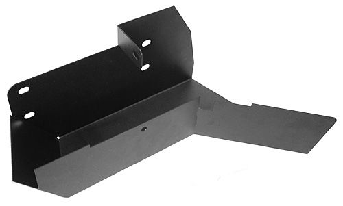

Our scoop mounts behind your lower grill on the far left. This locates it directly below your air intake. If you have an aftermarket air intake with an open bottom (CAI Inc, Roto-Fab, K&N, etc) then it will feed a large volume of cool dense air directly into it. There is a ton of info in this thread.
Difference between scoop/washer bottle's?
Below is a photo of the scoop with our washer tank kit attached.

Got mine today UPS ,Chase....both bottle and scoop - well written instructions - looks like a snap for this weekend install...Did I read somewhere we should cut a bit more than the dimensions you describe in the instructions?
Correct. If you have trouble getting the scoop in place you may need to remove slightly more plastic than the instructions say to.

install scoop and washer yesterday - EZ - tip: cut more vertical as we have been saying here - about 5/8 inch more in my case...

I just went thru two days of 2 inches of rain a day - I wonder if the scoop sends water up and soaks the filter? Does the filter catch he water if it does?

glen e are the holes in the back of the scoop to let water out?? my banks intake system on my duramax has them..

dunno - don't see holes for drainage:

There is no additional risk of water ingestion with the scoop. In order for water to get to the air box it would have to enter the scoop, negotiate a 45 degree corner, make a 90 degree turn upward, and then climb about 12 inches vertically. While the scoop does direct additional cool dense air flow into the intake it does not create a vacuum capable of doing all that. Water vapor condenses against the back wall of the scoop and is drained through weep holes in the bottom rear corners. The only way I can see forcing enough water into the intake to hydro lock it would be for you to hit standing water at least as deep as the fog lights and with a bit of speed. And if you do that you are going to have plenty of other problems too.
You can see one of the weep holes in the bottom rear corner. There is another just across from it but it is concealed by the near side wall in that photo.
