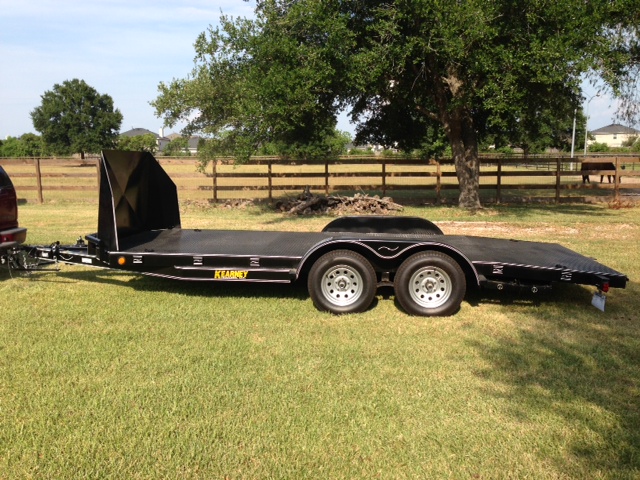

I bought a trailer so when I get my bogarts I'll be ready to go back and forth to the track... I'd include pictures w/my car, but I'm still waiting on my water pump . I hate not driving my car...
The fenders are not removable, but they measure 9" higher than the deck and it looks like my doors have 10" clearance, but it does drop closer to the hinges. This is with my street tires, so I'm hoping for the same clearance with the slicks and skinnies...we'll see.

Old 07-13-2013, 06:53 PM   #103
Supercharged SS
Drives: 2010 Camaro
Location: Sandy Hook, CT
Posts: 11,926
Nice looking trailer!!
Supercharged SS is offline   Reply With Quote

Thanks! I was hoping to w/the trailer i'd make it to Camaro5 fest, but my car isn't going to be ready.

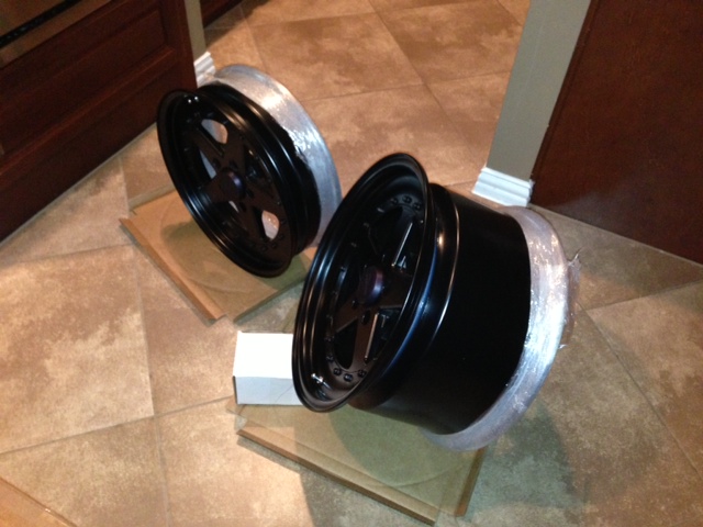

I had my slicks and skinnies mounted on my new bogarts today! Unfortunately discovered one of the rear bogarts were damaged in shipping (dent on the front rim). Talked to Rich and he is going to get it fixed, but if they can't fix the rim, I'll have to wait 2 more months before they get another rim built.
