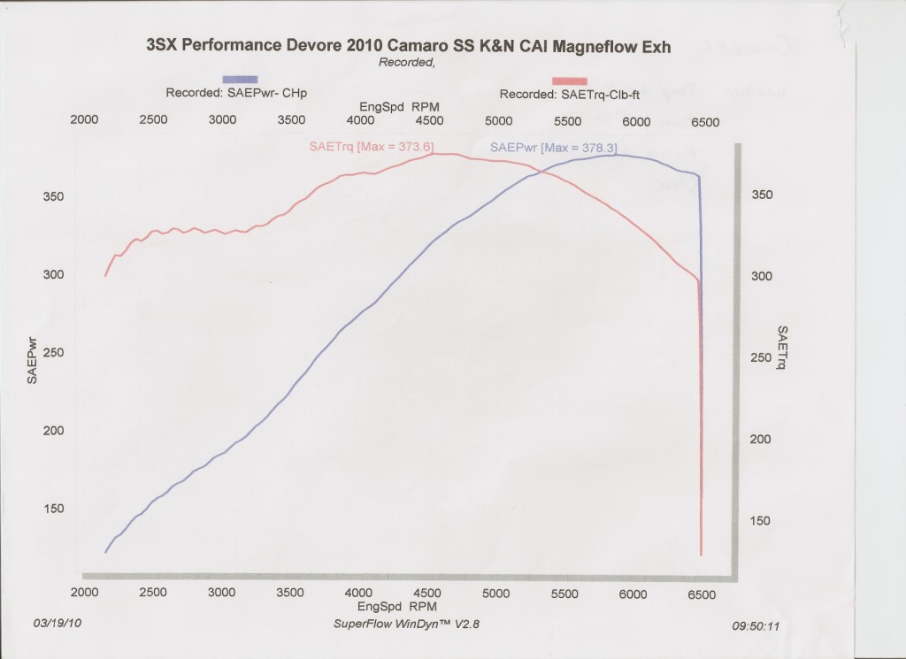

First dyno pull ever 3/19/10 on AWD dyno at 3SX Performance (K&N intake, 3" Magnaflow catback, no tune):
378.3 RWHP
373.5 RWTQ

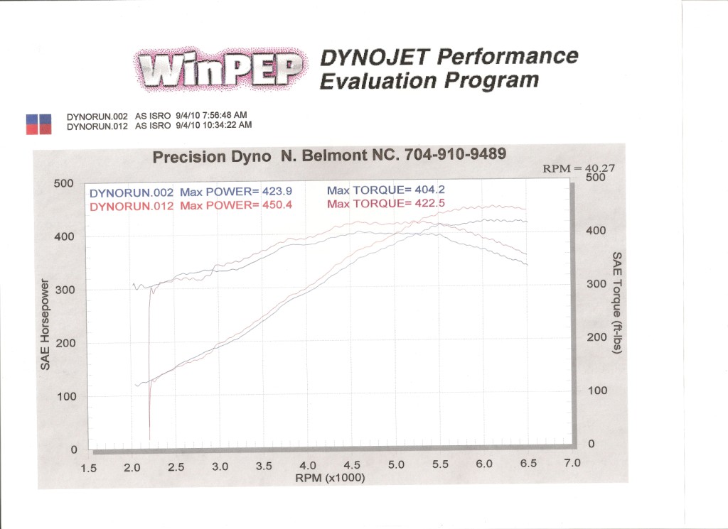

NOW, for today's results: First dyno pull today after warmup 9/4/10 on Dynojet at Precision Dyno (K&N intake, Doug Thorley 1 3/4" shorty headers, SOLO hiflow cats, 3" Magnaflow catback, VMS Stage 2.5 cam kit (LSA Comp Cam 227/239 on 114 .613 .623), no tuning):
423.9 RWHP
404.2 RWTQ
Approx Temp 72F
Gain of 19.87 RWHP and 10.73 RWTQ from previous 6/26/10 dyno run prior to cam.
So after this, we started tuning and doing more runs. I was in the driver's seat which was a blast!! Thomas was tuning on the HP. First main thing was to increase the idle speed, it was idling at 500 rpm. We started high adjusting it to 900 rpm, but was too high, couldn't hear the lope. We ended up bringing it down to 775 rpm and was perfect. We ended up running the a/c later, and ran great, we drove around town, never stalled once. Just the right amount of lope, not shaking nearly as much, alot smoother and sounded awesome (will do a video tomorrow). I couldnt' take but 2 photos and no video since my batteries died in the camera.
Next thing we noticed was that car was running rich. I noticed a stout gas smell after the cam was installed. The a/f mix was at around 11.8. We leaned it out up to 13.8, it didn't really like it and we found the best spot the car liked was around 12.7 to 13.1 a/f ratio. So that's where we kept it.
Next we checked the temps when the coolant fans would come on and adjusted them to come on at 45% power at 175F, up through 90% power at 215F (Thomas, correct me if I'm wrong on this).
We started running into problems hitting the rev and/or speed limiter so we raised the electronic speed limiter to 170 mph. We were getting the car kicking into safe mode after getting the high speed warning and reducing engine power. It would come on right around 6400-6500 rpm. So after that was fixed, we didn't get the dash messages anymore.
Torque management was shut off from before, so no change there.
The last thing was modifying the timing. We started with -2 degrees of timing and the car liked it and responded well. We ended up taking out 1 more degree, total of -3 degrees of timing and that's where we ended up and had our best dyno pull of the day:
450.4 RWHP
422.5 RWTQ
Approx temp 80F
Now based on the actual conditions at that time, it was 460 RWHP (STD), but I know people freak out when you don't use SAE!
That was a gain of and additional 26.5 RWHP and 18.3 RWTQ in just tuning from the first pull earlier in the morning. So overall, from before the cam was installed, we saw gains of 46.37 RWHP and 29.03 RWTQ with the cam tuned! I'm very happy with the numbers. I was hoping for 450 and got it So with an average 15% drivetrain loss considered, I should safely be in the 500 bhp club (~518 hp at the crank and ~486 tq). It's a good feeling.
So with all mods (do not have a run w/o the intake or catback exhaust), based on the 5/7/10 "baseline" dyno, I've seen gains of 73.56 RWHP and 55.12 RWTQ, so likely a few more ponies prior to the intake and exhaust. I can't complain about that!
Overall I'm really happy with the cam tuning results and performance gains. Thanks to Thomas at Precision Dyno for the fantastic tuning job and much thanks to the guys at Vector and Comp Cams.
