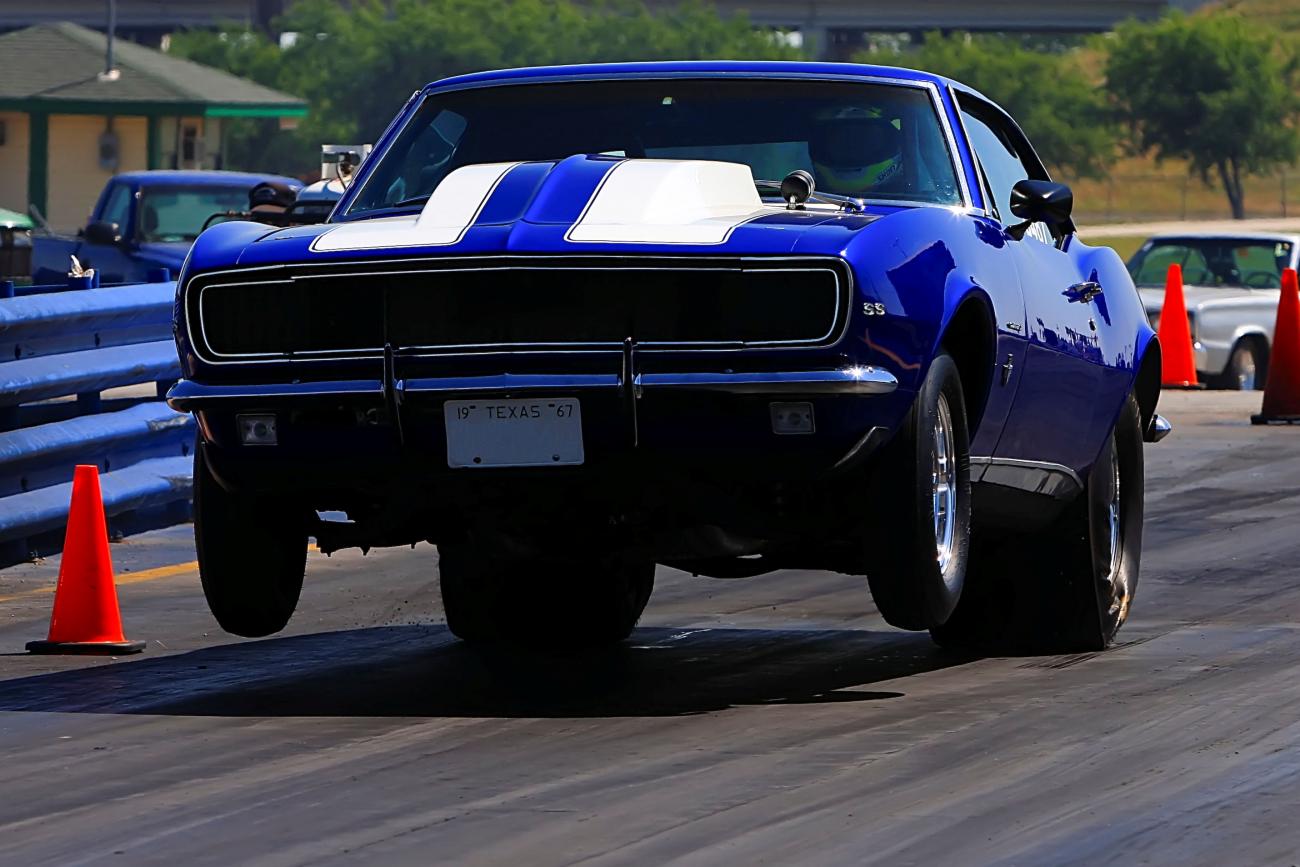

Here is one of ours at the track last May. Little bit different setup that what you have though.
