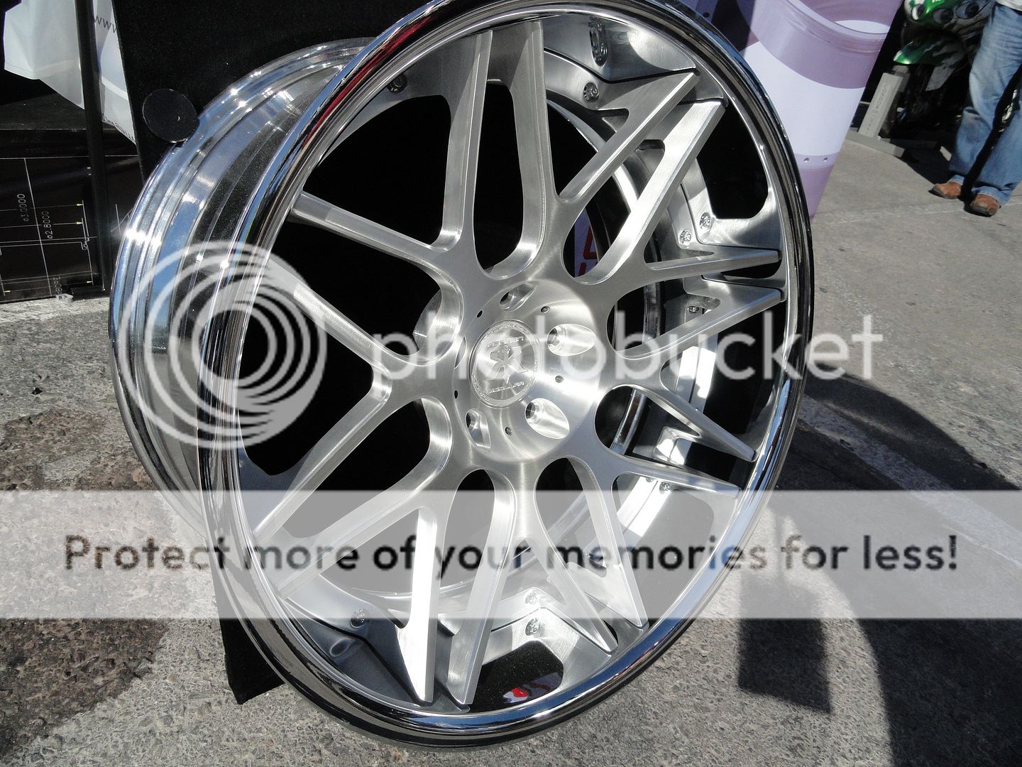

Concave outer face, with deep lip:

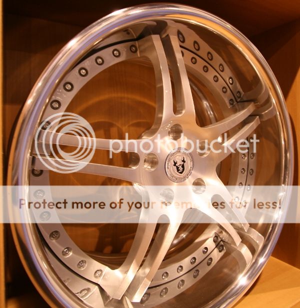

Convex outer face, with deep lip:

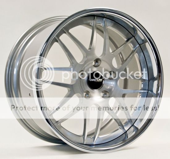

Flat forging:

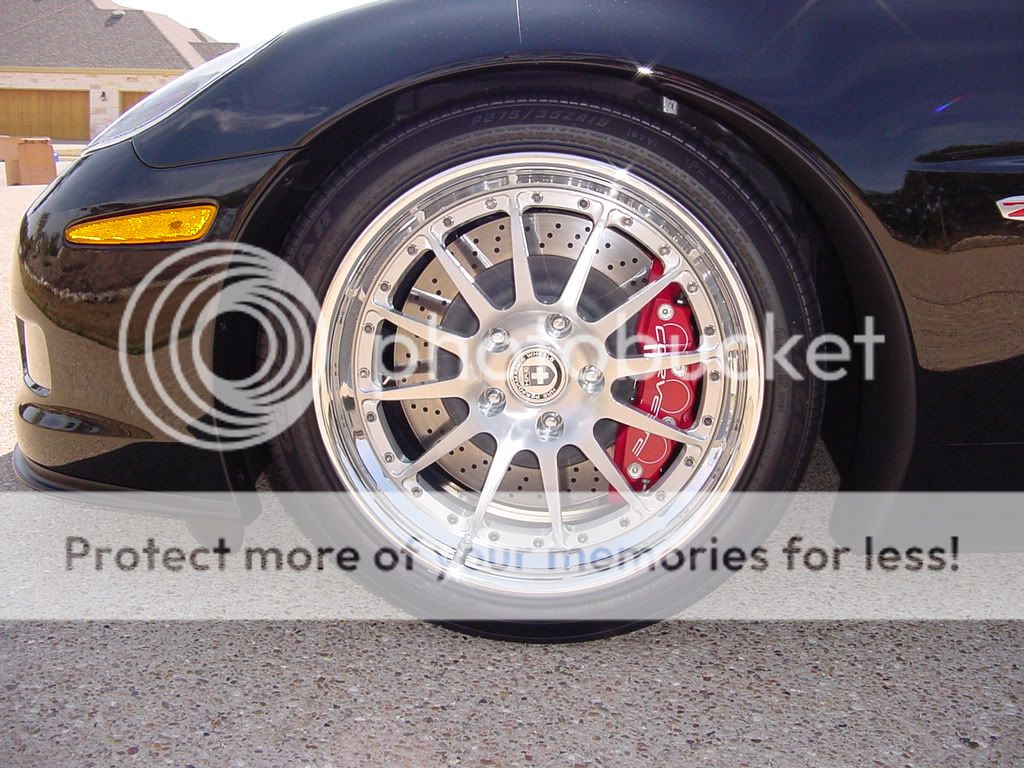

Flat forging, stepped lip, 3-piece:
