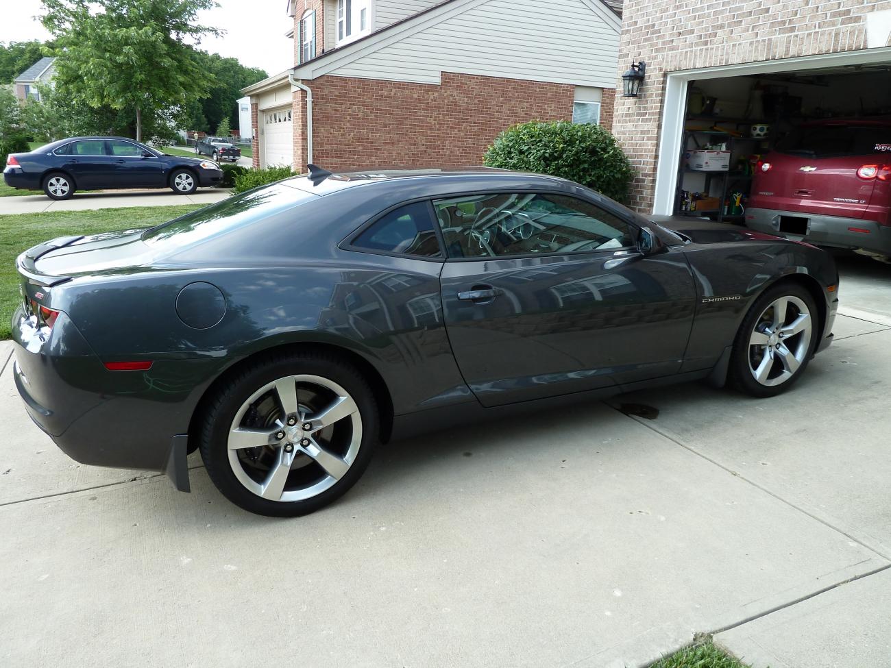

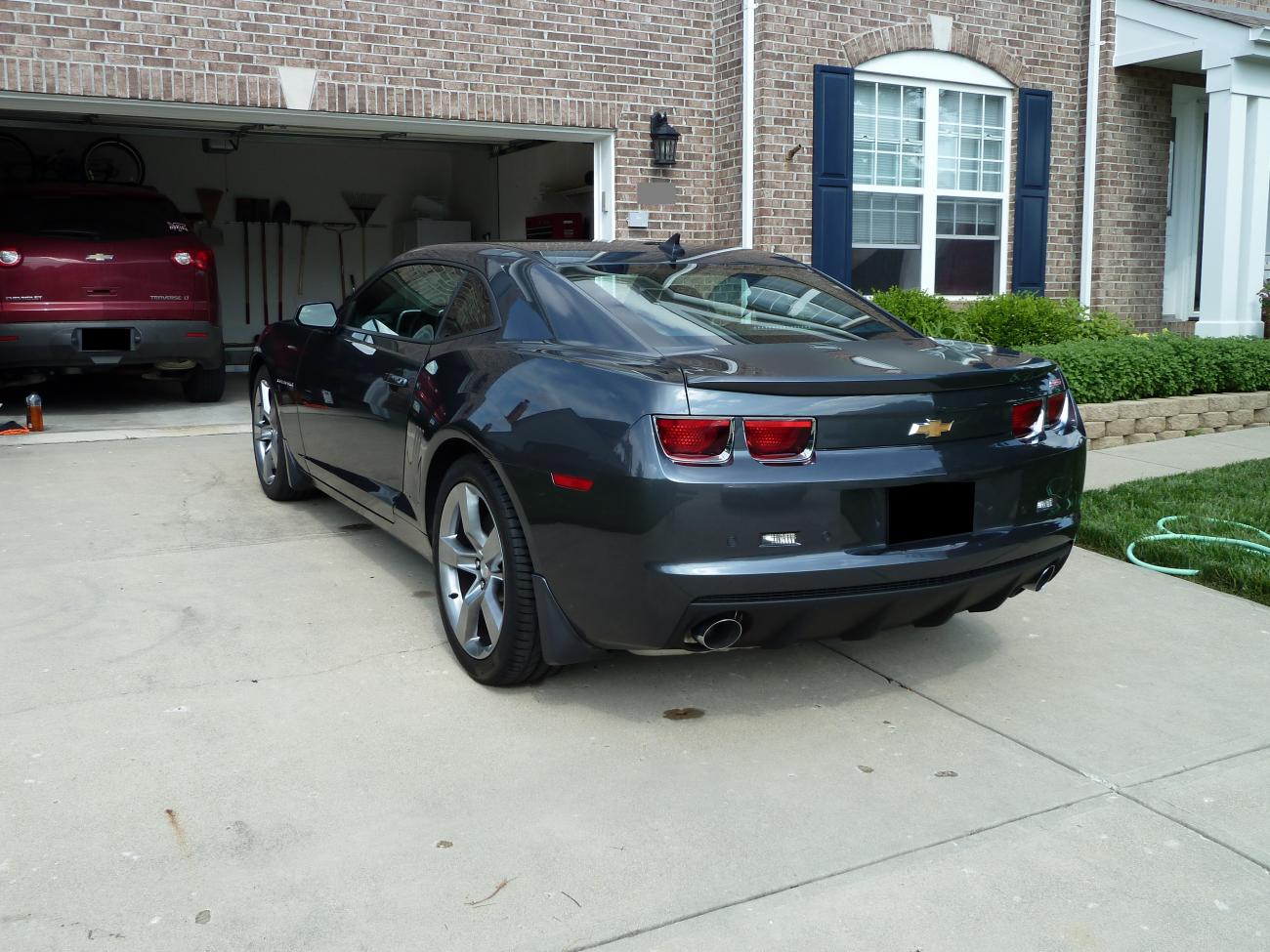

Originally Posted by remdds View Post
I've been kicking around getting these as well. Still haven't decided if I like the look. Anyone have more pics... preferably in CGM. Thanks.
Hope these help you decide... I think they look great and you really don't even notice them.
