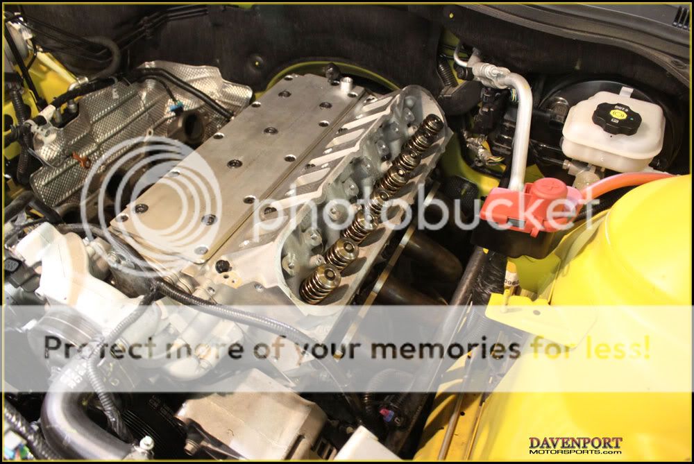

Intake, heads and front cover all removed. 6.2 ready and waiting for a big injection of power!
The old parts put aside out of the way so they won't get damaged.

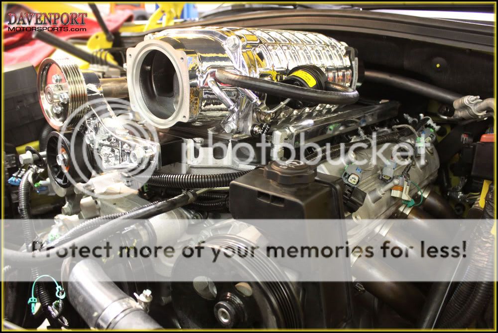

We're porting the lower manifold on the TVS 2300.
Here are a few photo's that show the difference.
Supercharger unit separated.
View of the ports before and after.
Close up.

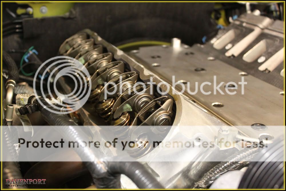

A few shot's of the LPE CNC'd LS3 Cylinder heads.
I tried to take pictures of the ports but the camera wouldn't focus.
I'll keep the pictures coming as things move forward.

By comparing the shape of the ports on the LPE head to that of the ports on the ported lower intake of the TVS2300 its quite apparent that air flow between the two parts will be considerably less restricted and should reduce pressure off the back end of the supercharger. In my opinion this should allow the same volume of air to pass through to the valves with less boost.
I guess what I'm trying to say, is that a non ported system running 8 lbs. of boost will produces less air out the back of the supercharger than a ported system running 8 lbs. of boost. This makes the boost number a relative term and the actual amount of air in "cfm" the important number for tuners to determine the proper AFR.
Bryan
