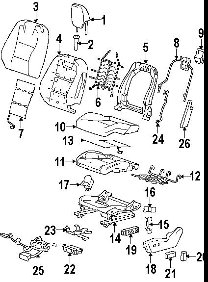

if you are thinking about adding heater to your seats
you will find it in the pic
7. Seat back heater
13. Seat cushion htr
it seem that you have to take off the seat cover

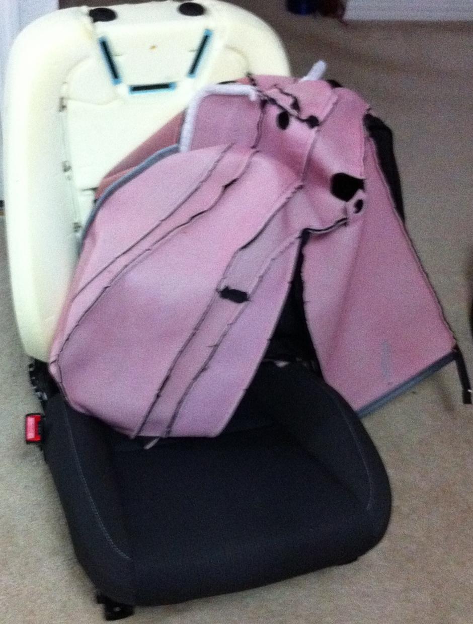

I have replaced my cloth seats cover for my 1LT to orange_leather_OEM cover and it wasn't an easy job, and i don't have the heater

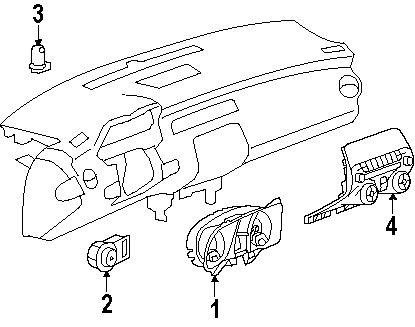

but how can you turn the heater on/off? i belife that the switch is connected to the radio.
seeing the catalog, i think the switch comes with the radio and it is not possible to add it... i could be wrong tho
4- Control panel, W/heated seats $276.82
4- Control panel, W/o heated seats $273.85

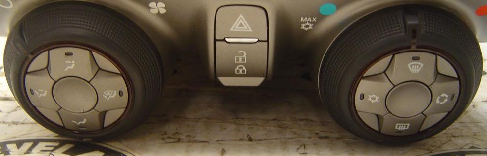

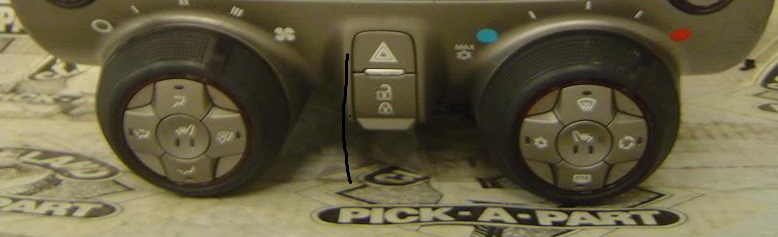

i found 2 pic of radio w/ heated sead and one w/o

I ran down and checked it out and the heated seat controls are located on the knob for the heating/cooling on the head unit, I know you can get aftermarket heated seats, but I would rather spend a little more and get the factory appearance, so I went ahead and bought the head unit with the factory controls off of ebay, going to pull it apart when it gets here and see if I can swap the controls over onto mine, if not I will try swapping the units out. it is fun to try to figure these things out and in the end my wife's back will thank me
