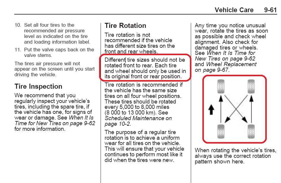

Yeah, there's no directional arrow on the sidewall, only 'outside'. I guess you could flip the tires left and right
The manual however, says no. They say don't rotate staggered wheels and even they were not staggered, not to flip left/right.
2010 CGM 2SS LS3, born: 4/10
Wow, and they still went ahead and did it? Now I just wonder if it's "bad" for the tire, or if tread/grip will suffer because the front tires are being run "backwards" and the rears are being run "forwards".
Attachment 199955
The manual does NOT indicate anything about swapping same size tires from side-side. Just says not to rotate different size tires.
If they didn't re-program the sensors- and it says the right tire is low at 25 psi- does that mean that its actually the left tire that is low? If so, that is just not right and downright incompetent.
