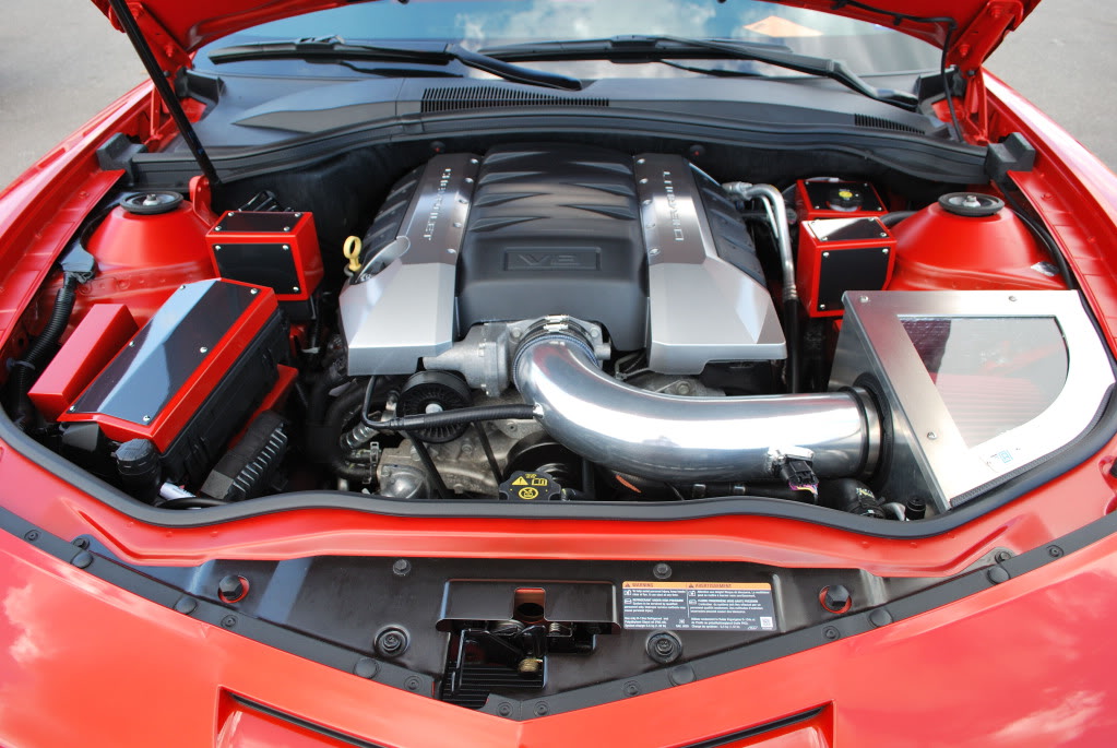

Shot in the dark here...Do the ajustable rubber guards have any thing to do with that?
The ones on either side of the hood latch...with the over sized holes, in the pic:

I sent you a PM with my phone number. This is a simple fix do not take anything off. There are two torque screws on the shroud right next to the latch. These control how far the top of the bumper sits in regards to the top of the hood. You can call me if you like.
