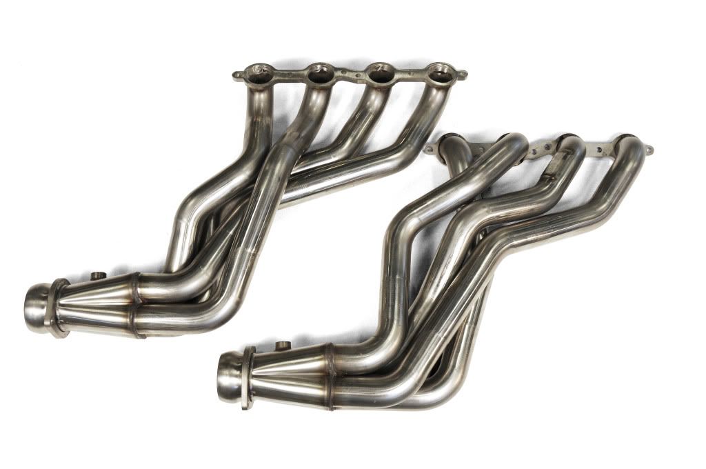

I had my mind fixed on getting the kooks headers along with the Borla ATAK exhaust.
But the guy i'm ordering the parts through is trying to convince me to go with borla long tubes (off-road) instead. His argument is that it wont be as loud (I dont mind it being loud) and that it provides the same quality and power while being a cheaper option.
I am looking for maximum performance along with a proper muscle car tone.
I do prefer to spend less money but i don't want to do that if it means i'll get something not as satisfying as getting a part that is a lil bit more expensive.
how much difference is there between Kooks headers with high flow cats and the same headers without ? very noticeable difference ?

I think he is more concerned with the fact that the Borla headers have 1 3/4 primaries with a 2 1/2 collector. The kooks will be better for power and you can easily add the cats where as the Borla will have to be cut and welded in.

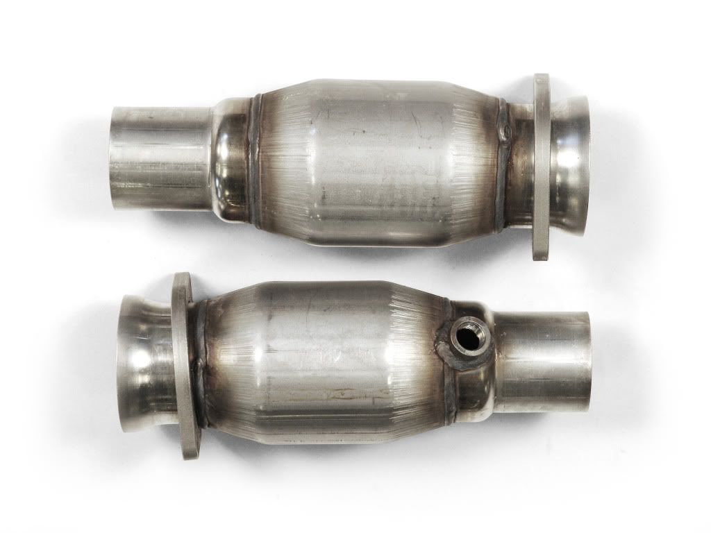

nope it's fine but i think you should have high flow cats

Yes you would need to run Part number 6511 they are 1 7/8 x 3" S/S headers.
Then you will also need our high flow catted connection pipes they are part number 6513-OEMC. That will make the entire system a direct bolt in.
