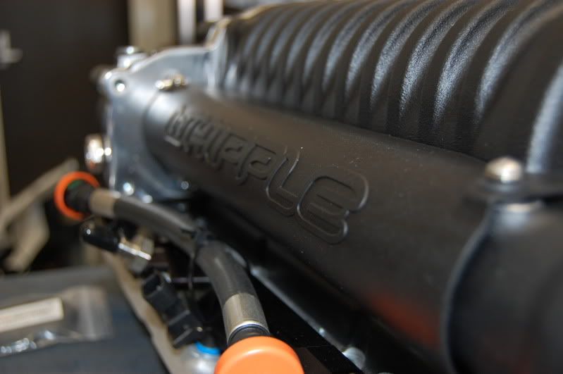

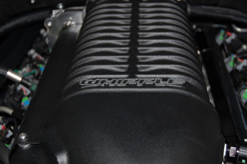

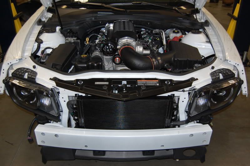

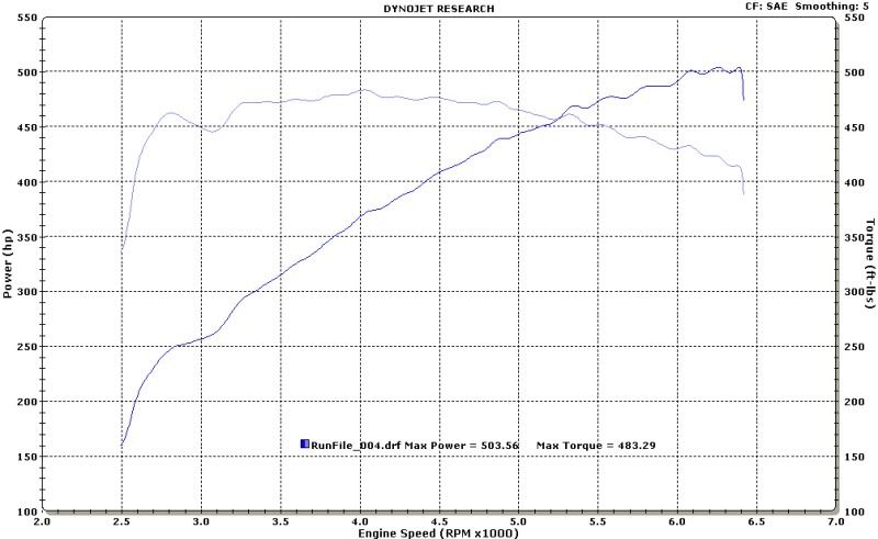

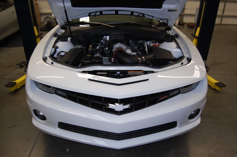

We just pulled this off the rollers this morning. The install is super clean and most all the fittings on the kit were quick connect or AN style. Not to mention the power this thing pushed was pretty amazing for a bone stock car with just the whipple bolted on. The car layed down 503 rwhp and 483 rwtq on 9#'s.
2010 L99 A6 Camaro
2.9L Whipple Kit
MSD Boost A Pump
80# Injectors
RPM Custom Tune
Stock Exhuast

Originally Posted by Detoxx03 View Post
Very nice for it being stock and a auto
Thanks ! I forgot to mention this car has 24" rims also. So that makes it even more impressive.

Please please please install some longtubes onto that! You'll be around 550 then most likely. Stock cats are restrictive, but if you do that it won't be a sleeper.
