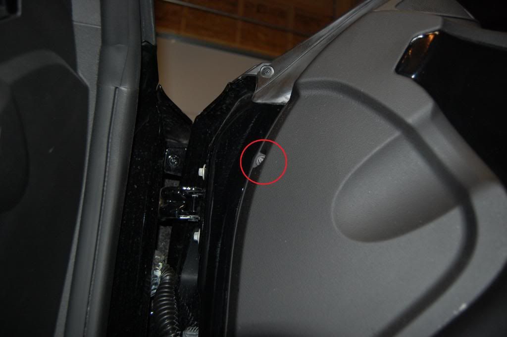

So let's start by taking the door panel off. The first step is taking the little rubber cover out and using a torx bit (sorry don't remember size) and remove this bolt from the door handle area.
Next is the door opener handle. You need a 7mm hex head driver or ratchet to remove this bolt.
You now have 3 more 7mm hex bolts to remove in the following locations.
The top front of the door panel.
Bottom of the door panel towards the front under the speaker.
And lastly bottom of the door panel towards the rear of the door.
Once you get all the bolts out you can pop the panel off. It's easier if you have the window down all the way. You can start at the top rear of the panel and just pull the plastic away from the door. There are several snap locks along the top that you can pull out with relative ease.

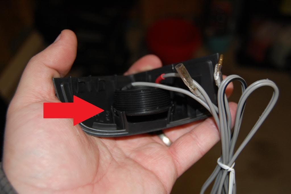

Here is the crossover unit that came with the component speakers. They are Kicker 6.5" with a tweeter. I forget the model #.
I crimped on the appropriate mating connectors to the crossover unit and plugged those in. I also put some double-sided tape on the back of the unit.
As you can see here, the crossover unit fits well on the inside bottom of the door where the speaker goes.
You should prep the tweeter now. There is one screw that you need to take out for access to the tweeter. Once the cover is off, you can pull the tweeter out of the casing.
Here is the Kicker tweeter.
As you can see here, it doesn't fit very well into the housing.
I needed to dremel the tweeter a little bit but then it fit quite nicely.
Although the tweeter fit fairly well, I taped the tweeter in place to make sure it didn't move around. It's now ready for install back onto the door panel.
