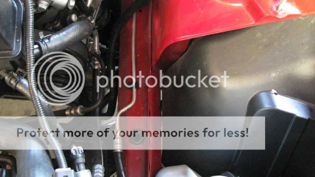

The REAL ISSUE was when I attempted to close the hood after I put it all together. The hood would not close!!!! So I had to remove one bolt and push a little harder in a downwards motion to get the box "lower" into place. The hood is still a little tight, but it does make for a better seal. I don't recall anyone else having this issue, so I can only assume this was my error?
In looking at your picture, I can tell you that the air box is not seated properly. There are two possibilities for this. First, there is a plastic clip right along the frame rail a few inches back from the lower grommet the air box engages. It is a black clip with 2 ears, one on either side to retain the A/C line. It is possible to catch one ear and pinch it under the air box. This will cause the air box to be high. The other possibility is the stud isn't engaged in the lower grommet. This may be easier to see with a flashlight. In either case you will need to remove the nut on the stud that retains your air box. You then should be able to lift the air box upward a little and use a finger pull the plastic A/C clip from underneath the air box. make sure the stud enters the grommet when going back down with the air box.
This picture shows the grommet which the air box stud engages and the plastic A/C line retainer with the ears on each side.

Also, is the grommet that black circle on the frame rail? If so is there a nipple or something on the air box that fits into that grommet?
Yes and yes.
