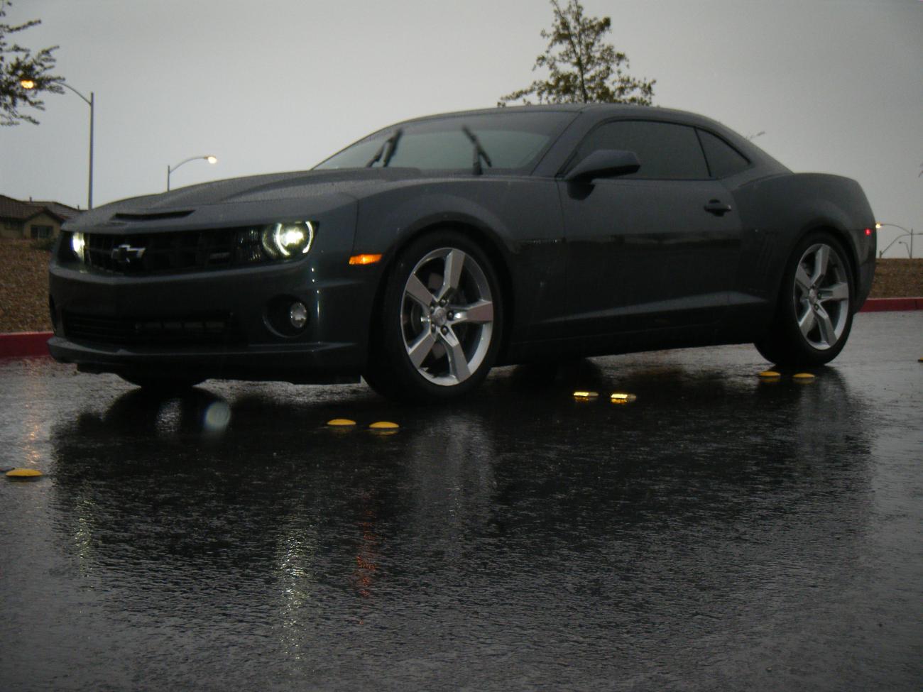

My car is almost all stock on the inside, haven't changed anything and I have a non-agressive tune just to increase the throttle responce and take off some of the warning screens and rev-limiter. Just resently got all new vinyls as well, but I am looking at doing some upgrades to the sound/performance. I am thinking about a CAI (Henessy or G5CR), Exhaust (Borla Attack Wheel Back or Cat back). I want to start somewhere around here, but I was wondering which I should do first and if I should spend the money to get Cat-Back when from what I have seen the axle backs are pretty much all I need at this point.
Let me know what you guys think I should do first > next > last.
