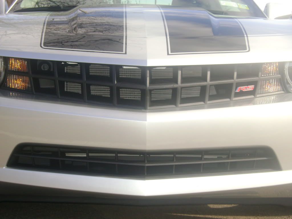

I just finished doing this after my car was backed into over the winter!
Perfect fit, no problems what so ever!
Before>>>>>>>>
After>>>>>>>>>

vetehead,
WOW that looks great. Right color as well

The color is perfect but that's not the whole story!
The fender had a small dent as well so it was totally replaced.
The shop I used was so anal that they painted the whole hood over, plus all stripping re done, blended the door and the top and side of the other fender as well. Sim is impossible to just panel match!!! But I can tell you this...the bumpers never match the rest of the car perfect anyway mine does in the front now because all parts were painted at the same time.
When my car came from the factory it was slightly off do to the fact the bumpers,mirrors and gas tank cover door are painted elsewhere.
If you only have damage on your bumper I would just paint the bumper,because if you look at your front and rear bumpers now I'm sure they are slightly lighter or darker anyway.
There are 3 additional parts needed besides the bumper'
1-mail slot grill
2-lower SS grill
3-lower air dam rubber strip(SS bumper is 2 inches wider)
Hope this helps!
