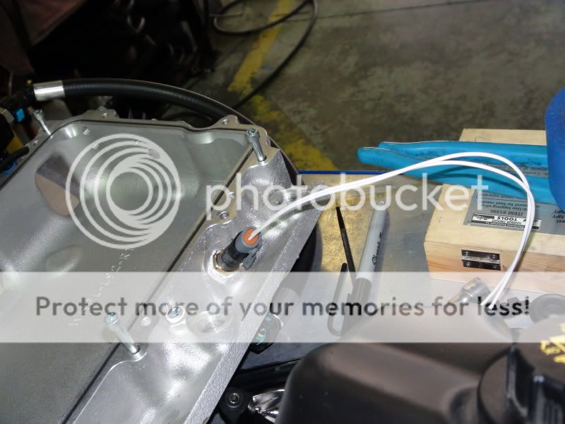

can you tell us more about the IAT relocation kits, pictures would be nice, info On the 3 bar map instalation and special tuning requirements.

We use a ZR-1 MAP sensor, and all of our kits and tunes come with the appropriate adjustments for the mods. If your car is being dyno tuned your tuner should be able to do the necessary adjustments.
For the IAT we use a Delphi sensor, here is a shot of one installed before the head unit went on!
/Erik

Our IAT kit uses the same sensor as Kenne Bell, Maggie etc and we feel it is a safer unit then the Whipple one because if Whipple's brakes (for whatever reason) it's going int he motor. If ours were to brake it's not going anywhere.
We have done a lot of testing and simply feel ours in the the proper location using the proper parts.
