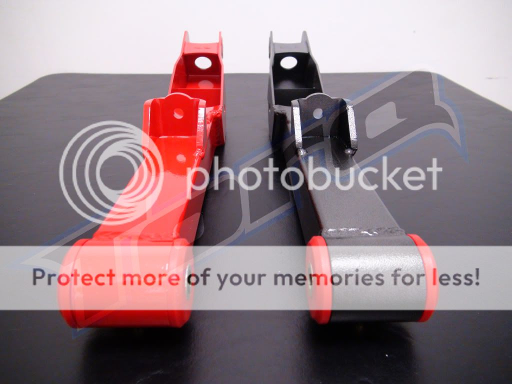

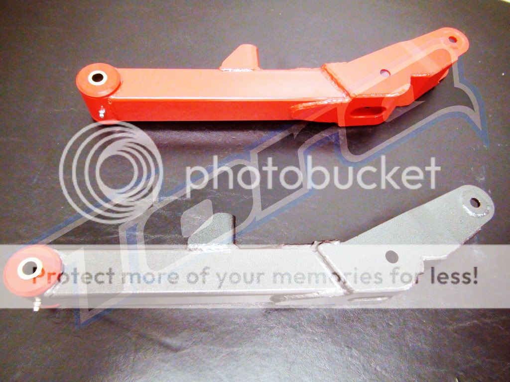

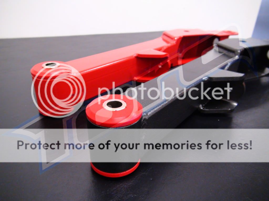

We are very happy to say that we just received our first shipment of BMR's BRAND NEW Lower Control Arms for The 2010+ Camaro and can finally get them out on the track for some serious testing!
These bad boys are just as high quality as we expected from BMR, and are already in the process of getting these installed on our shop car and 2 other customers cars

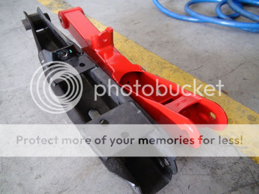

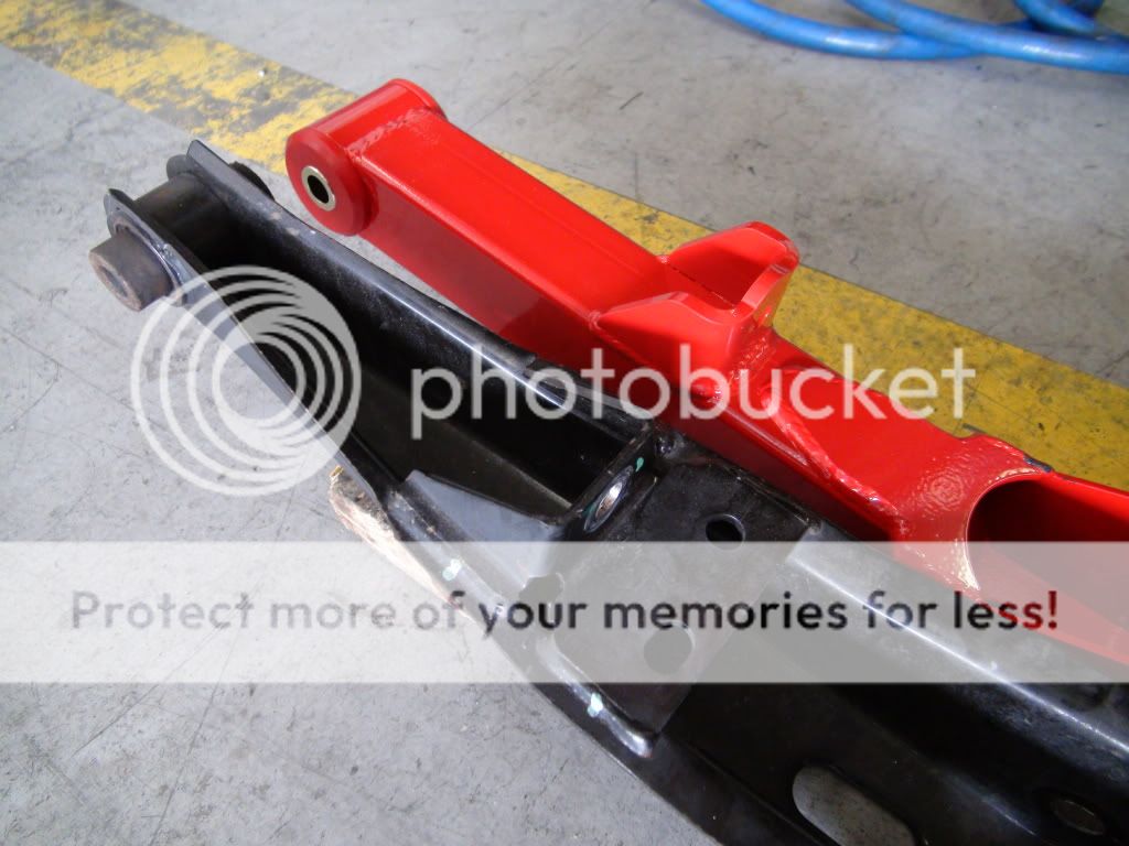

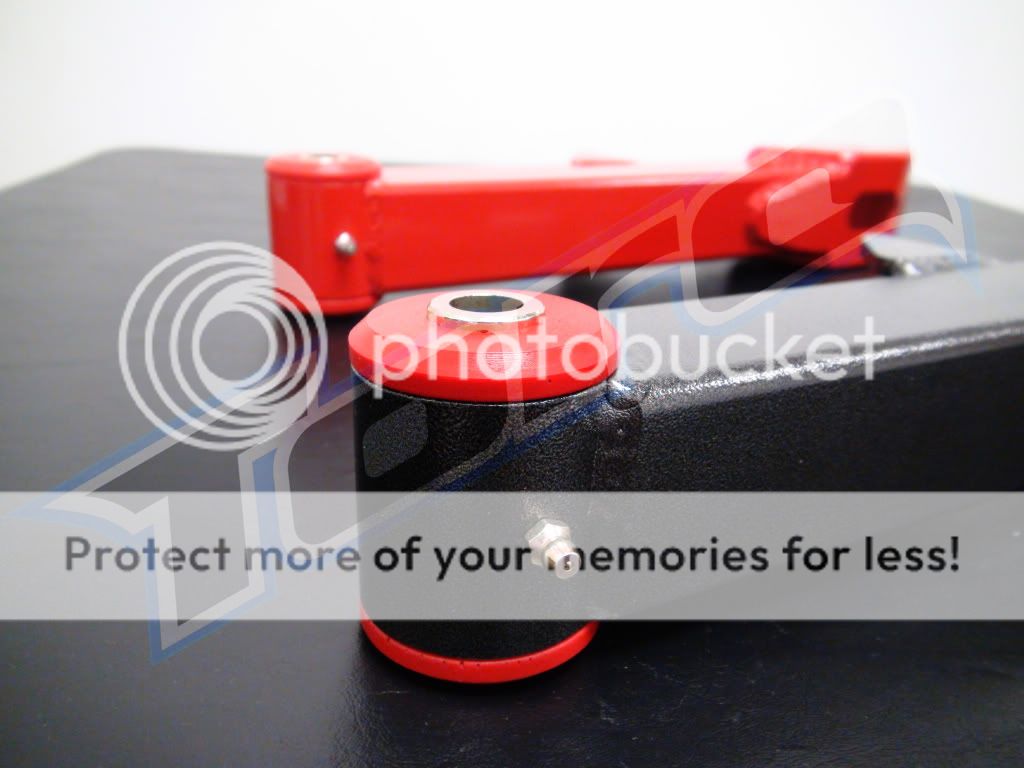

The units are far superior to the factory stamped steel arms, these control are fabricated from 1" x 2" rectangular steel and 3/16" CNC laser cut and CNC formed steel plates. the BMR control arms utilizes fully fluted, greaseable, low deflection polyurethane bushings rather than the poorly supported rubber bushings of the factory design. These will fit both SS and V6 Camaro's! These will for sure solve any issue with snapping the Endlink bracket that a few of have experienced, and will work great in both road racing, drag racing and street applications!
We will also give our own full review once I get them on my own Camaro and as always push it to the limit at the track, but I am confident they will work outstanding.
Give us a holler if you have any questions regarding these control arms!

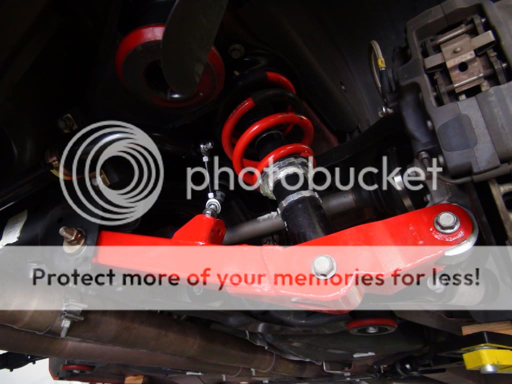

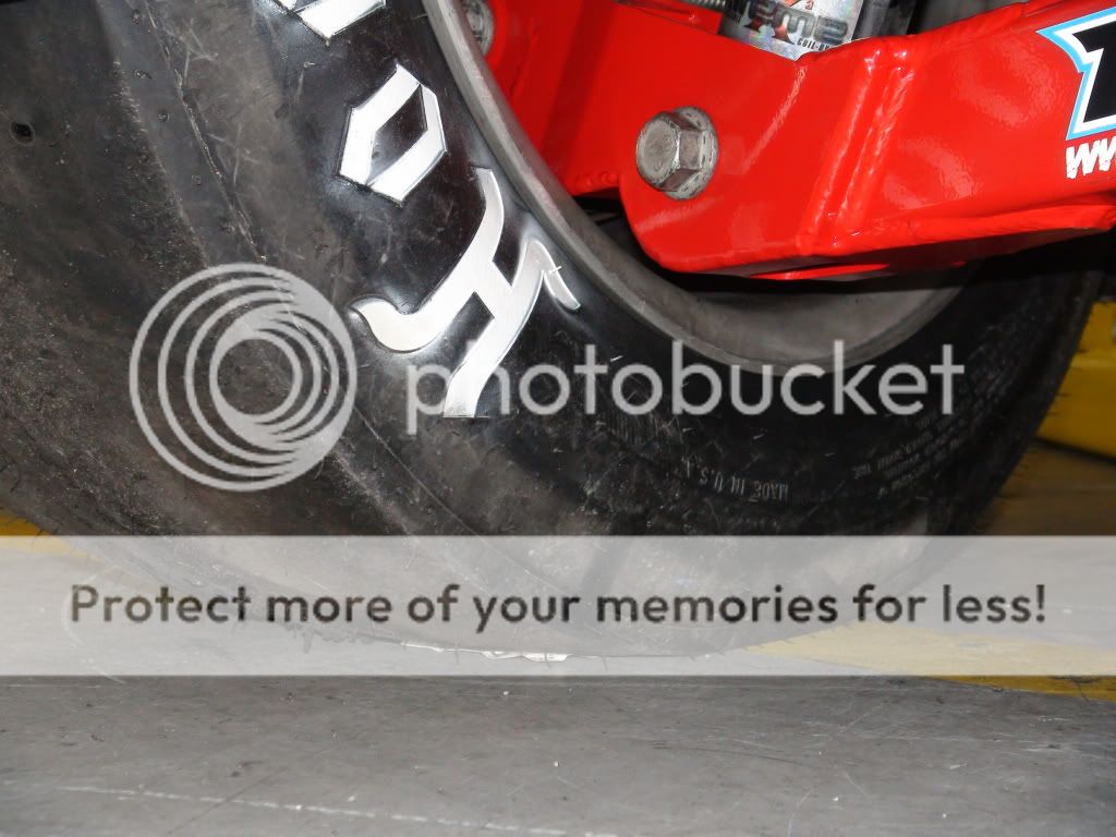

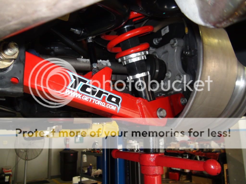

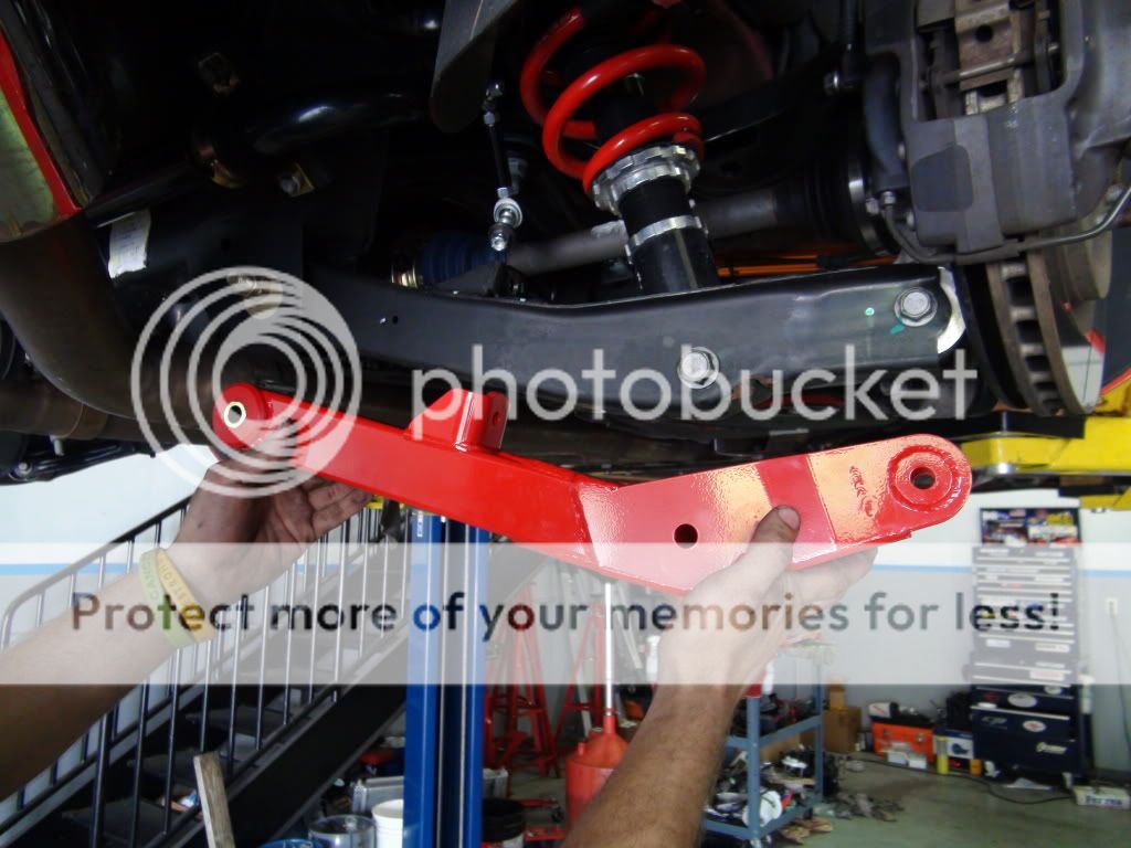

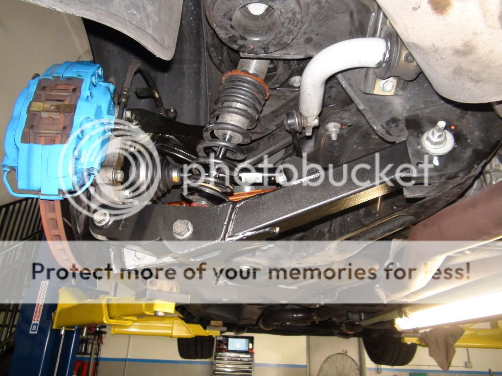

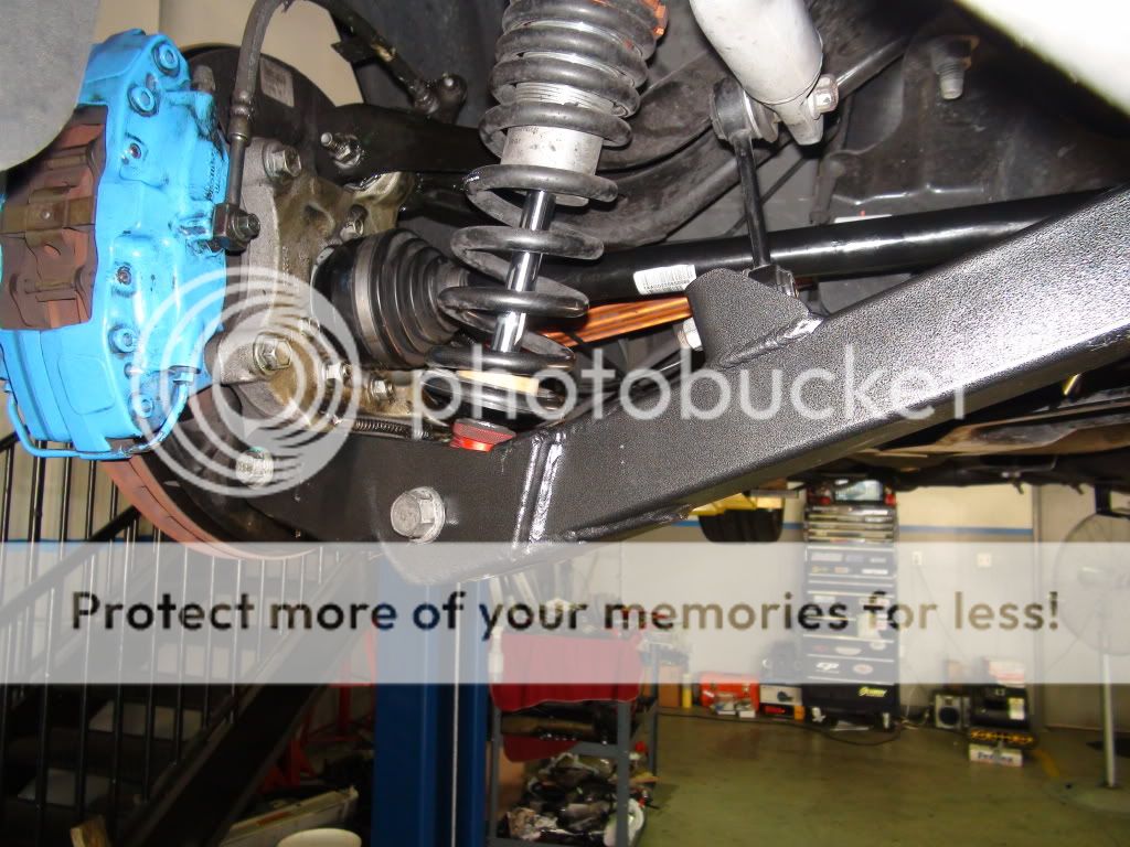

Here are few install photos, time to hit the track!
They installed just as easy as the stockers, and are for sure a huge upgrade. We will do an alignment tomorrow to see how much we can get out of them before we hit the track with the car. We will be installing them on my Camaro this weekend and heading to the road course after that.
No breaking of tabs here!

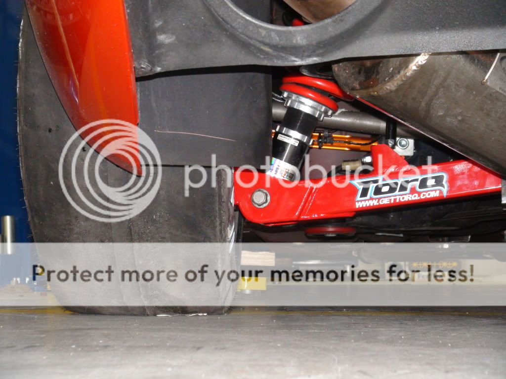

Tried some testfitting with our 17" wheel & tire package, it's tight. We will do some more measurments driving before we say yay or nay.
More to come!

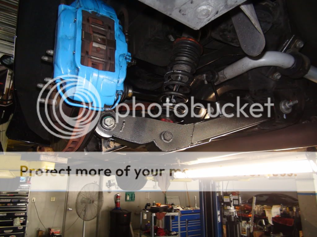

Some more photos installed on my Camaro, this time the black Hammertone! Can't wait to hit the track!
We have now installed them with Pfadt Coil-Overs, Pfadt Sways etc as well as Pedders Coil-Overs and so far no issues.

Looks good, very close fit. Why the stock trailing arms?
We simply haven't gotten around to changing them yet! We just installed the Pfadt Sways, endlinks, Toe Rods and our custom 1000hp fuel system on the car and wanted to the the BMR arms on the second we got them in
Pfadt trailing arms are next!

Another question is why would they put the grease point in a place once installed you can never get too again..
