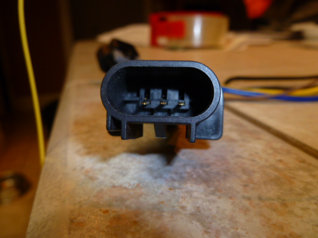

You can not use the RS switch in a non RS, You will need to do 1 of some things, Get a harness with a relay that will cut the power in the day time, or get a harness and cut the spring in side the headlight switch and then have a Manuel headlight switch, There is some one that can reprogram you BCM, But i think you will need a harness any way to go from a 3 pin connector to a 4 pin connector.
here is a pic of what the harness looks like.
