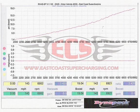

Another ECS Hardcore Package, RHS 427, ECS YSi System - 1066rwhp
This is the same package as our ECS Hardcore Edition Gen V packages. Including our own manufactured ECS Supercharger system featuring the Vortech YSi head unit & ECS 10-Rib kit.
This is using the same brackets as our base kit, only with 10-Rib upgraded pulleys/idlers.
2006 C6Z06
ECS 10-Rib Direct Drive Supercharger System
- ECS YSi Setup
- ECS 10-Rib Overdrive Balancer Made By Innovators West
ECS Built RHS 427CI
- ECS Custom DRP Piston Set
- Callies Dragonslayer Crankshaft
- R&R Pro Billet Connecting Rods
Mast LSxR Cylinder Heads 315cc LS7 Large Bore
ECS Bigger Blower Camshaft
ECS Stage 4A Fuel System
- F/R 83lb Injectors
- Aeromotive A1000 Fuel Pump
- ECS Plumbed Fuel System with Regulator
- ECS Alky Control Centri Methanol Kit
- American Racing Headers 1 7/8" LTs with High-Flow Catted X-Pipe
- B&B Fusion Exhaust

What engines are these LS7 or the LS3? I believe whole heartedly the centri SC's are boss, but your HP / TQ #'s are really high.
Is this on pump gasoline? And is the Y-Si the largest flowing Vortech SC?

They are Z06's, so they have the LS7. And ECS, what type of dyno is that?

The YSi is not the largest that Vortech has to offer. They have other trims in their race line.
As I stated in the original post:
ECS Built RHS 427CI
This is an aftermarket block made by RHS. LS7 blocks won't handle this kind of boost, they have trouble in the 700+ range.
This is on a Dynapack unit.
