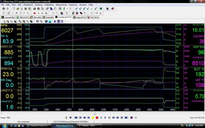

Started with the Trans tuning....
And wow! It feels much better! Whats screwy is how GM is already commanding a 6000 rpm wot shift, but speed qualifiers must be met also, so I was able to bump up the mph in each gear to get my target shift point.
I removed all tq mgt, and bumped the shift pressures up by 5% at first, then another 3%. 0'd out all the sift times, and it feels 1000 times better. Crisp shifts that firm up progressively with throttle input and wot shifts that are instant! I am still running the dealer's 87 octane out and will put a few tanks of premium through before moving on to the engine.
I have my shifts at about 6100 rpm (6000 commanded but tweaked the mph qualifiers). It pulls very good up to that rpm, even on 87 octane.
On the log, you can see why the L99's are sluggish with 87, very low timing and still getting KR! On this log it ran 0-60 in approx 4.9 to 5.0.
0-100 took about 11.7 to 11.8 sec. It's even pulling about 4* of timing from the low octane table PLUS its pulling some timing due to the high IAT's on this wonderful summer day!
Some good gas, and engine tuning and this thing will feel totally different!!
