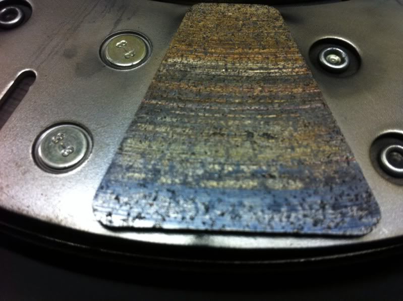

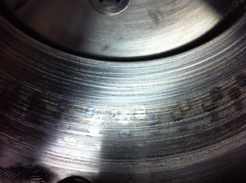

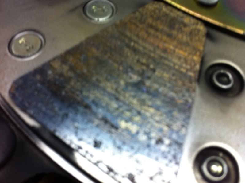

Well, my car has been leaking some oil. Two different dealerships told me it was the rear main, but they couldn't fix it because it's supercharged. So, I pulled the trans again. I figured I'd see oil everywhere, but it looks pretty dry. The clutch and flywheel appear to me to have excessive wear. I probably have around 1500 miles on them.
Clutch discs
Flywheel
The only hard driving it's had was at the LS Fest. I did some autocrossing and took it down the dragstrip twice. Opinions?

Those hot spots don't look good.
I had an RXT In my Mustang (Twin turbo) and only experienced shudder when I let the rpm fall too low.
They don't like low rpm/high load situations and are shameless about letting you know.
Send McLeod those pics. Something isn't right, unless you do 50 burn outs an hour.

Hard to say without seeing them in person but it looks like the drag racers clutches I do that didn't have a proper 800 mile break in.Check the floater plate to make sure it didn't warp.

I received this response from McLeod this morning
If it still chatters after 1500 miles you'll need to take it out and send it back. The wear looks normal but the marcel may be flat causing chatter.

I'm surprised those hot spots are considered normal, though I'm no expert.
