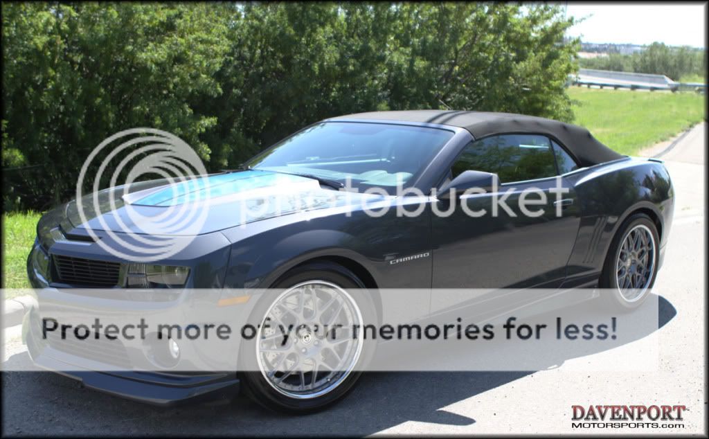

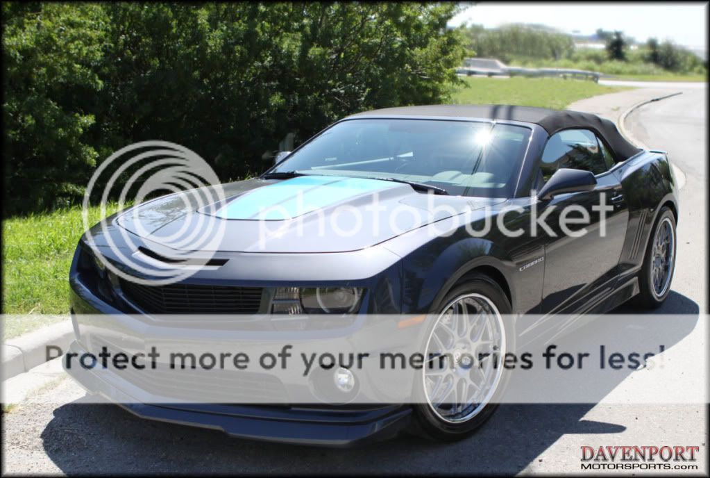

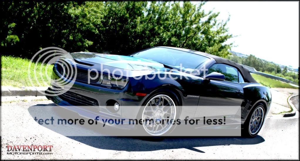

Another Davenport Rocket finished, this one can go topless.
We finished this one up a few weeks ago, just now getting time to post pictures.
2011 Cyber grey vert with a 6 speed Automatic.
Here's a list of the mods.

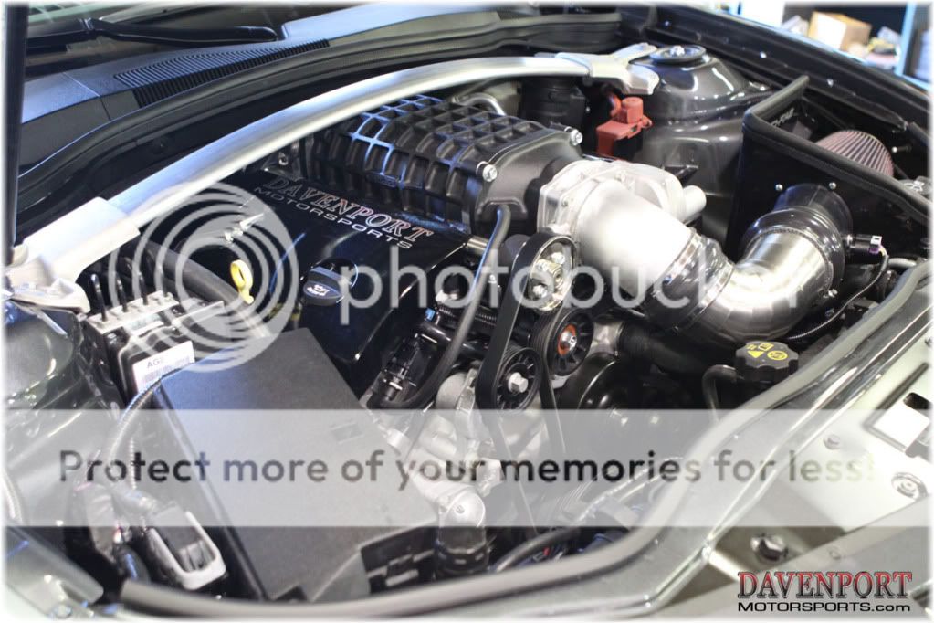

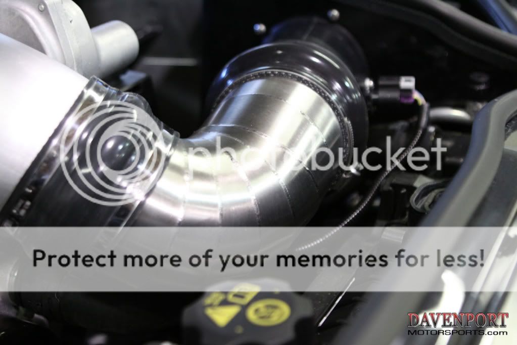

TVS2300 Supercharger, LPE CNC'd LS3 Cylinder heads, GT9 Camshaft, DOD delete, Stainless works long tube headers, high flow cats, and convertible specific cat-back.
Pfadt coil overs, sway bars, differential bushings, aluminum subframe bushings, and trailing arms.

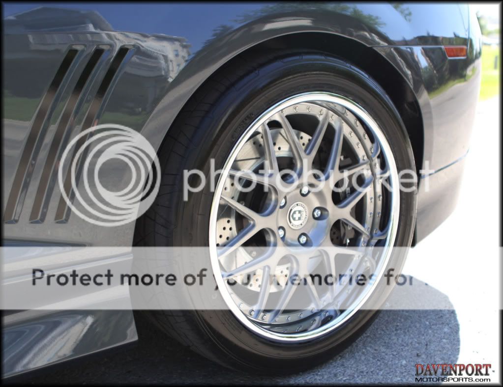

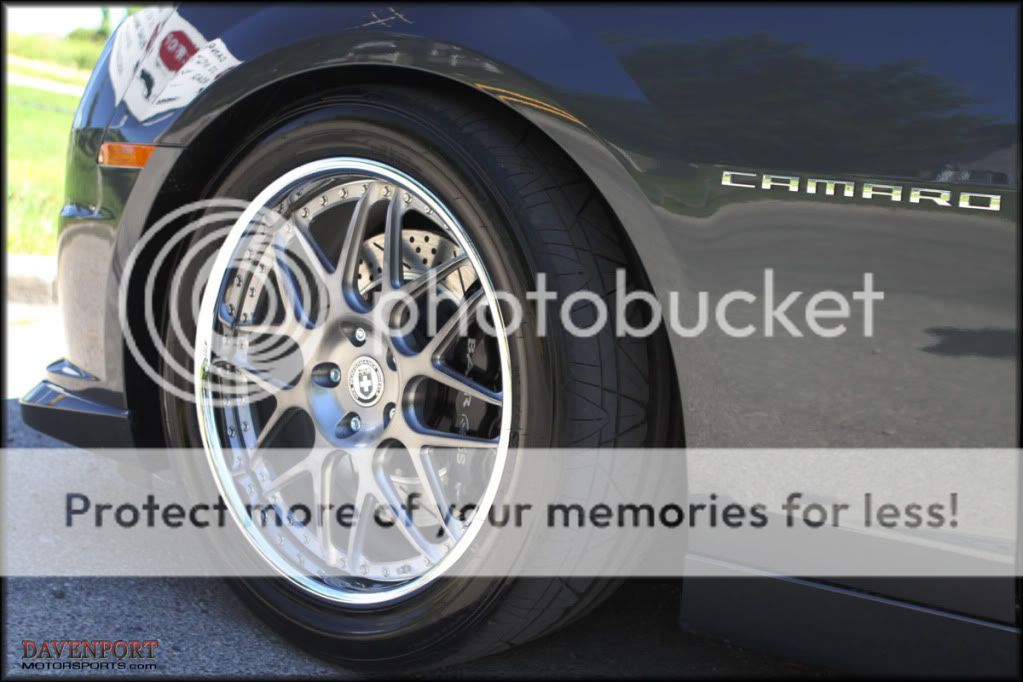

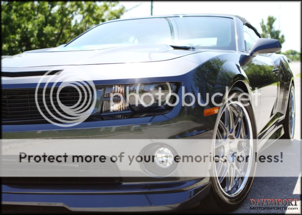

Baer Extreme + 6 Piston forged Monoblok calipers with 15" two piece rotors, front and rear.
LPE 3:90 differential.
HRE 590RS wheels, brushed/tinted centers with chrome outer lips, 20" X 9" front, 20" X 11" rear.
Nitto Invo tires, 275/40/20 front and 315/35/20 rear.
We had to make a custom intake tube to clear the drop in the hood.

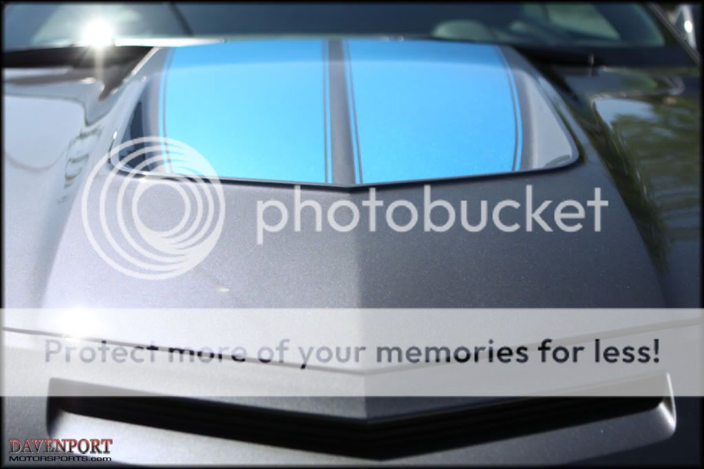

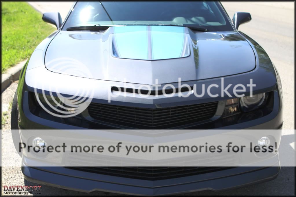

Heritage grill and body kit were painted to match the car.

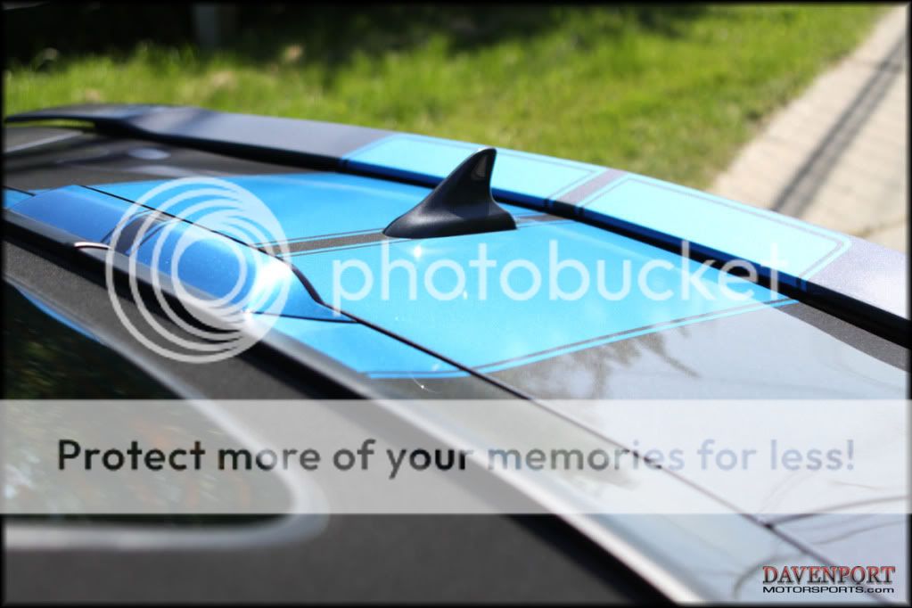

Custom stripes were done by a local shop for us.
Thanks for looking!

It made 560 RWHP and 482 RWTQ, if I remember correctly. 6.5 lbs of boost, 91 octane and we're at 3600 feet.
Didn't go crazy on it as it's his Wife's car! We made sure that it drives like a bone stock Camaro.............. with a bunch more power.

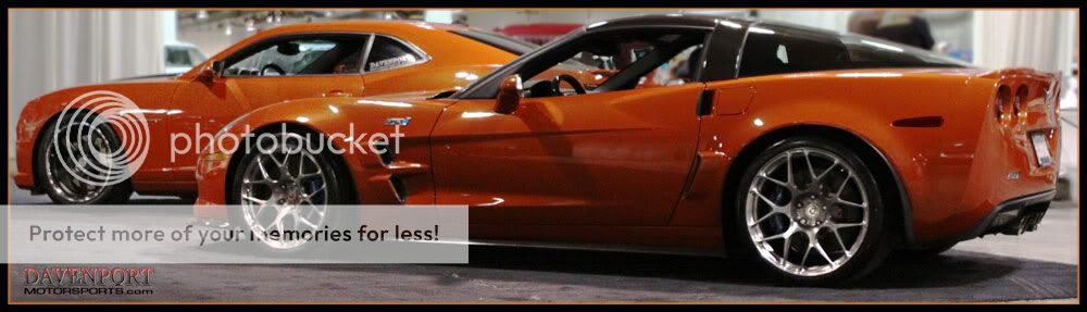

You Bet we would! The first three we worked on were Orange.
Here's a shot of our own Camaro, we used it as a development car. Tried numerous parts on this car so we would know what worked and what didn't.
It's sold now, and is being replaced with a 45th Aniv vert. It will be similar to the Cyber grey car in this post but will have a truck load more power!
And here's a shot of our development ZR1 along side our Camaro.
We like Orange.
