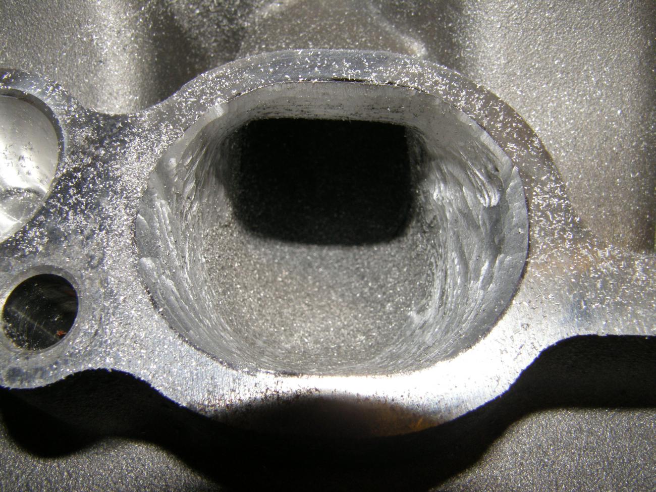

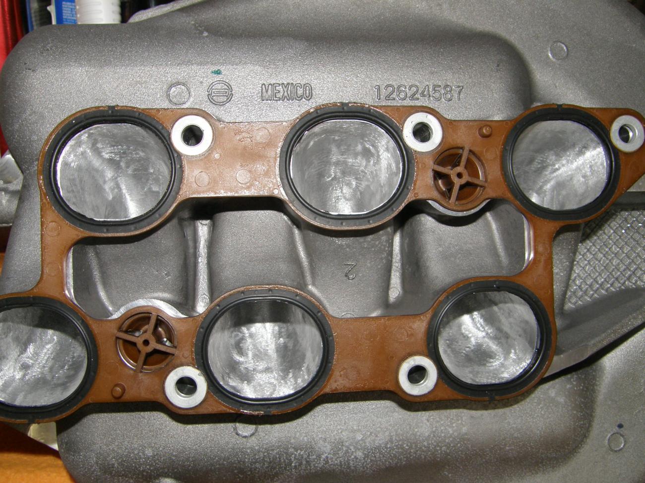

I thought some of you would be interested to see what our stock intake manifold is like on the inside. Most of us have only seen what is revealed when swapping out the throttle body and some haven't even seen that.
Here are a few pics, one showing the gasket fit. Note the extra material around the gasket area.

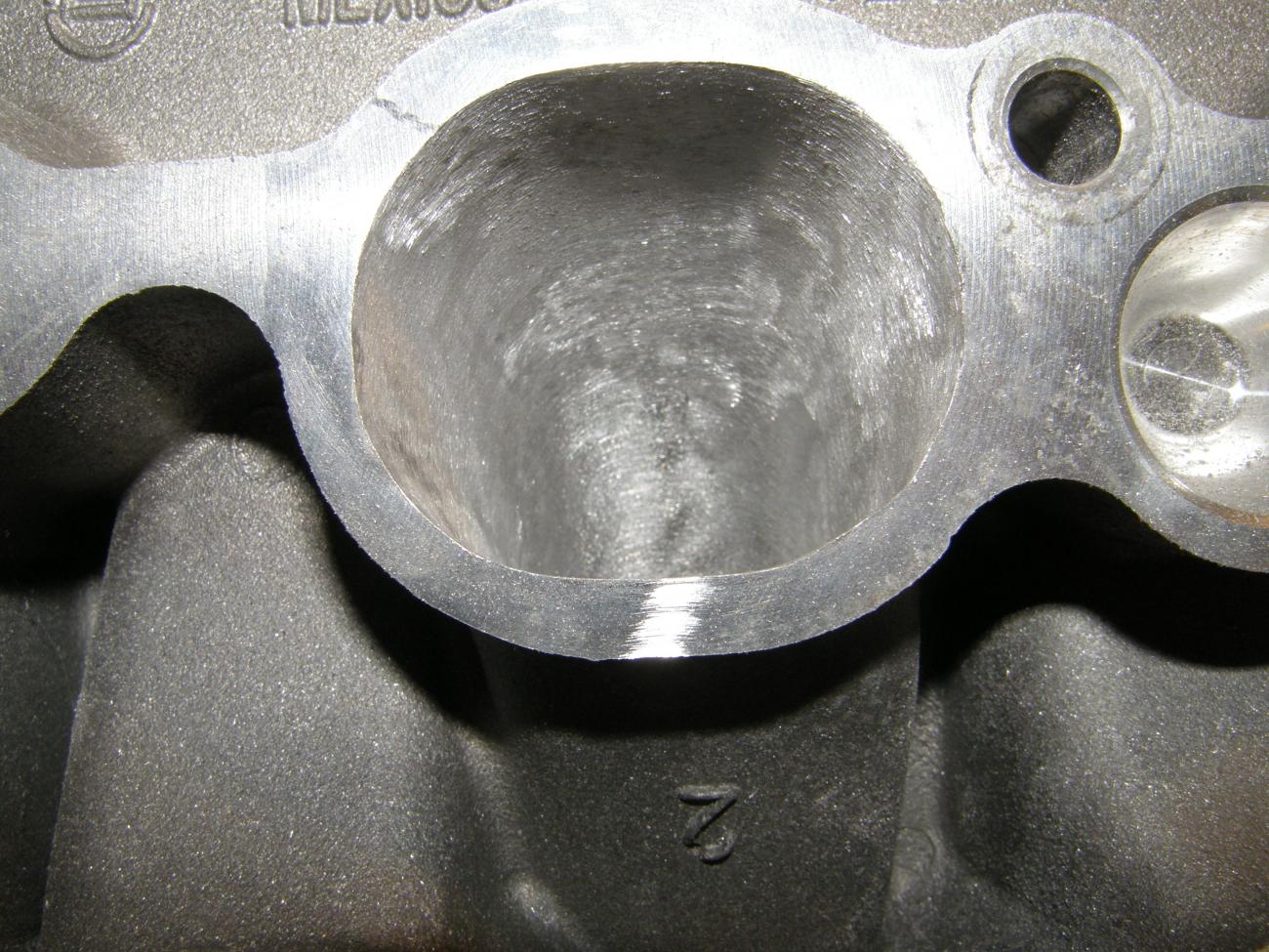

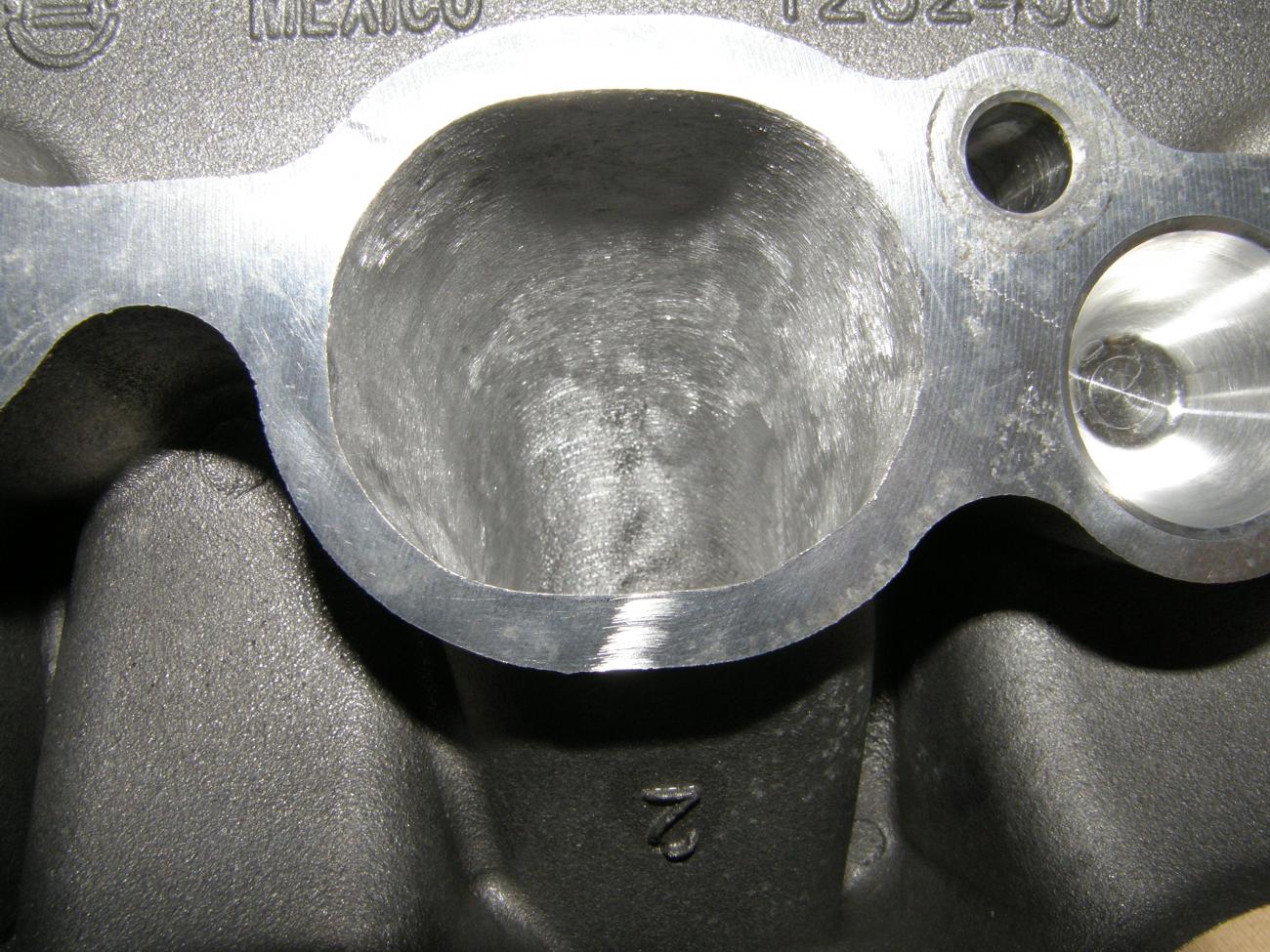

Never being able to leave well enough alone, I decided that I should take over where GM had left off.

While I didn't end up with a "perfect" job, I think that I did what was needed.
The sad part is that I ran out of time to install it tonight and I have to work overtime tomorrow.

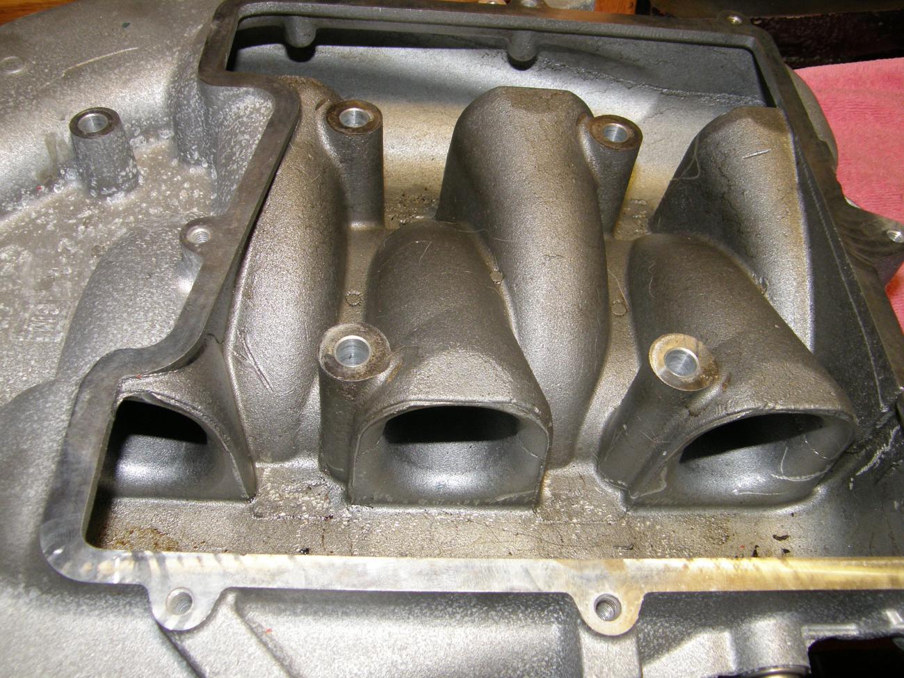

My family owns a metal fabrication shop, and my close friend works their for us. Recently he started getting some jobs with a local auto shop and he ported out a few VW manifold as I'll post below. These had to be cut open, but still the same concept.
Where did you get the extra manifold from? I'm going to get one and have him do it for me, as I want to still have the original manifold not tampered with. I want to get the ported throttle body as well, but I wanna keep my original also... I had plans of maybe getting a new car next year, but I now have no plans of getting rid of mine and modding has started up again, shes a keeper
