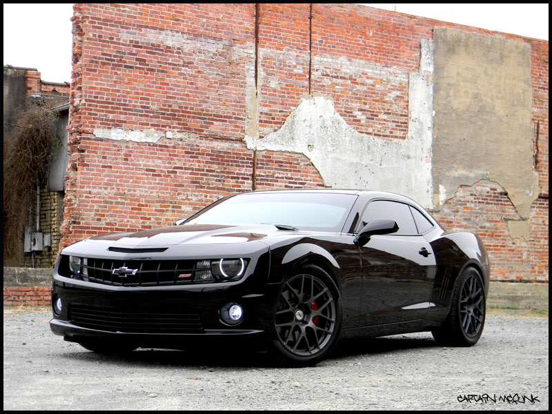

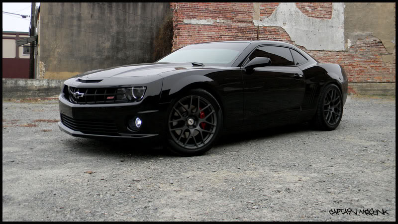

The TSW Nurburgring in 20x9.0 front +20 and 20x10.0 rear +35 with a 275/40/20 and 295/40/20 combo is a perfect set-up with a really nice stance. You can use Pfadt lowering springs with no problem. Here are some pics of this set-up.
Attachment 295992
Attachment 295993
Attachment 295994
Attachment 295995
What's the widest that you can go in the front? I want to do 19" with 295's in the front. Is that possible with a 1.4" drop?
