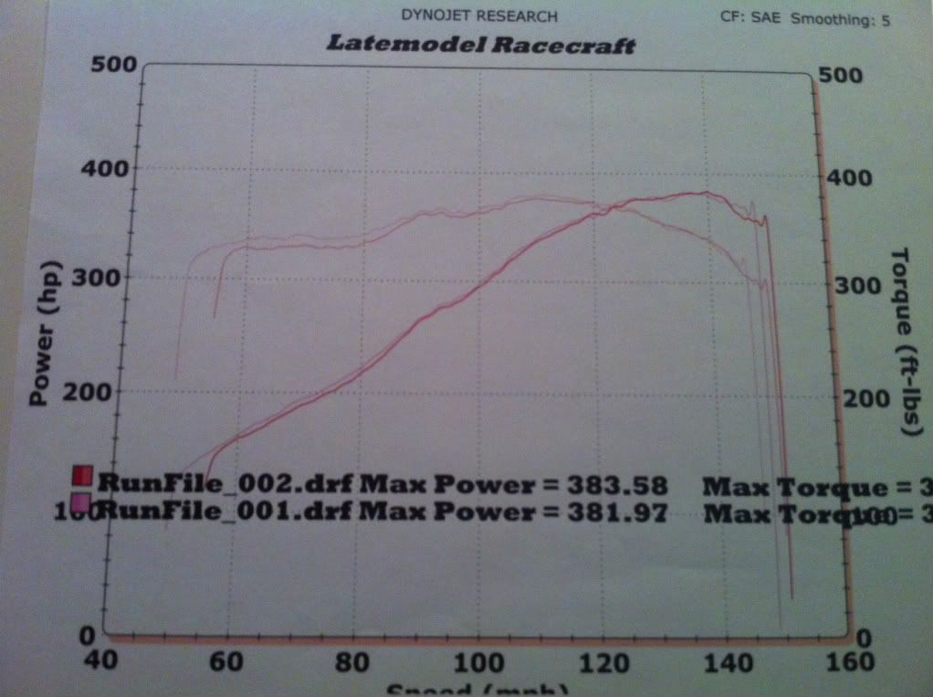

1st dyno (“Baseline”) – 384 HP/378 TQ (CAI only, on 93 octane, at LMR)

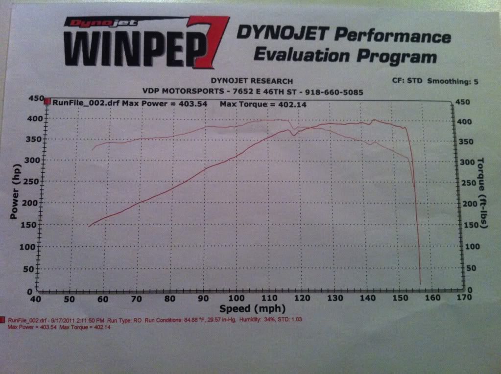

2nd dyno – 403 HP/402 TQ (CAI, Headers, Exhaust, No Tune, on 91 octane, at VDP)

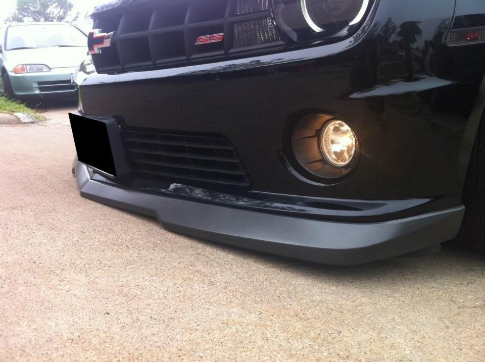

OEM GM GFX Installed:

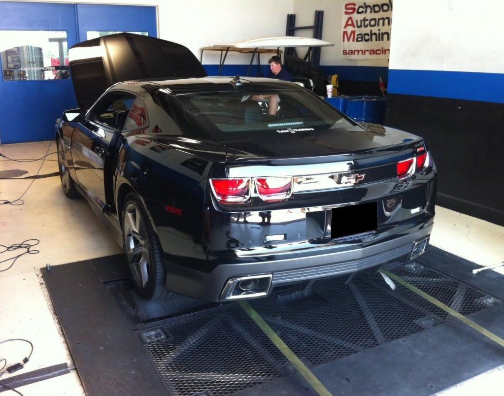

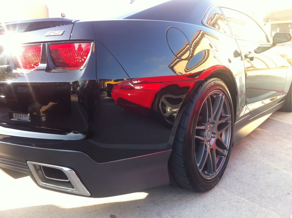

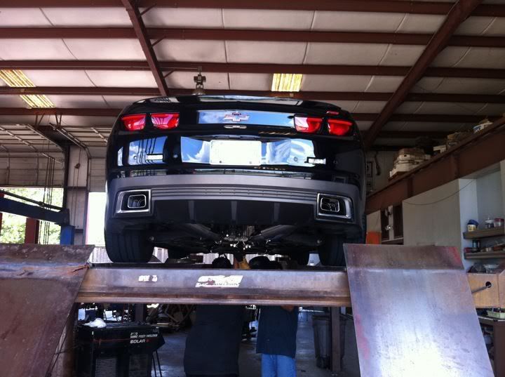

So a local car forum (Houston Performance Driving/HPD) was hosting a dyno day at Late Model Racecraft after Coffee and Cars in June. Out of curiosity, I decided to have the Camaro dyno'ed to see what it would make with just a cold air intake installed. On a nice and cool 105 degree day, it put down 384 HP and 378 TQ! Much higher than what my friends had guessed, lol. I was pretty happy with it, but knew I wanted to break 400 eventually... then 500.. then... you know the rest! On the dyno, I also got to see the 4th gen Camaro LMR built that went 243 mph in the Texas Mile.
Coffee and Cars – June 2011
A friend of mine owns a 3rd gen Camaro, a 91 Z28 to be exact. My dad also used to own one not too long ago. So I decided to add a little bit of the 3rd gen touch by adding a dash badge that came off of a 3rd gen.
3rd Gen Badge – 7/14/11

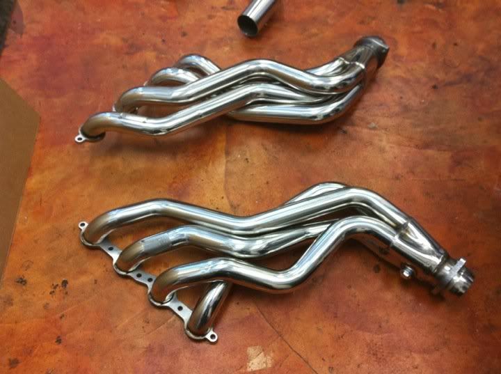

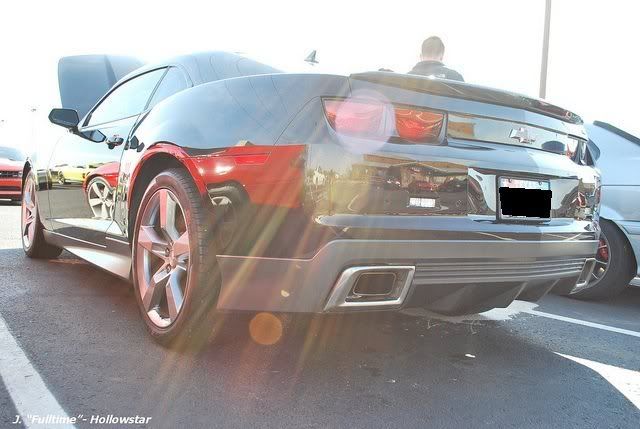

So, I happened to be browsing the For Sale section and stumbled upon a thread by Oversteering where he was selling some XS Power Headers and Catback for a great price as a tax refund special. After asking a couple of my friends what they thought about the deal, I went ahead and bought a set. A couple days later, a 2 big boxes showed up containing nice and shiny piping! I kept them in my room for a couple months until I finally got tired of waiting and looking at them sitting there, so my dad and I installed them. I remember how excited I got after the first crank. It sounded amazing! (and still does!)

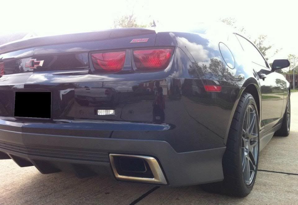

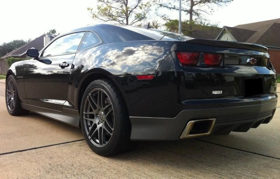

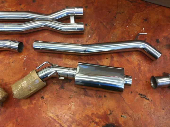

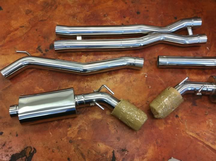

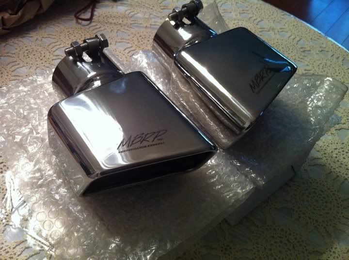

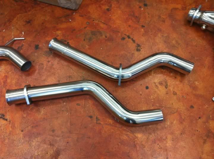

Headers and Exhaust + MBRP Tips – 7/28/11
Alot of people commented that one thing my car really needed to make it look better exterior-wise was to tint it. So, I got a quote from a local shop that specializes in working on high end cars. After agreeing to a price, I dropped it off at EVS Motors to have Huper Optik Ceramic 40% tint installed. Now, my car not only looks great, but also is cooler temperature-wise inside. My A/C no longer has to work as hard to fight off the Texas heat in the summer.
Huper Optik 40% Tint – 8/2/11

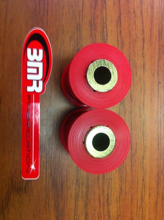

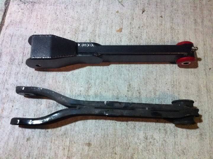

After taking my car to the track a couple times and feeling the "oh-so-great" feeling of wheel hop, I decided it was time to do something to get rid of it. So I ended up buying some BMR rear trailing arms and outer polyurethane bushings. Despite the instructions saying it would only take a few minutes to complete the installation, it ended up taking my friends and I a couple hours because of the bushings being hard to press out with our homemade tool. Plus we had to run to Walmart to buy a grease gun at 2 in the morning... cashier kind of looked at us weird when we walked up. 3 AM, and Im out testing everything out. Wheel hop was greatly reduced and I was happy

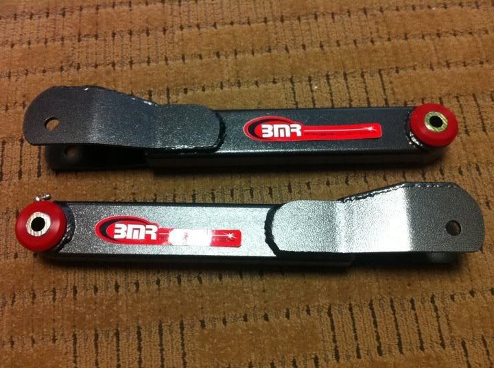

Trailing Arms + Bushings – 10/9/11

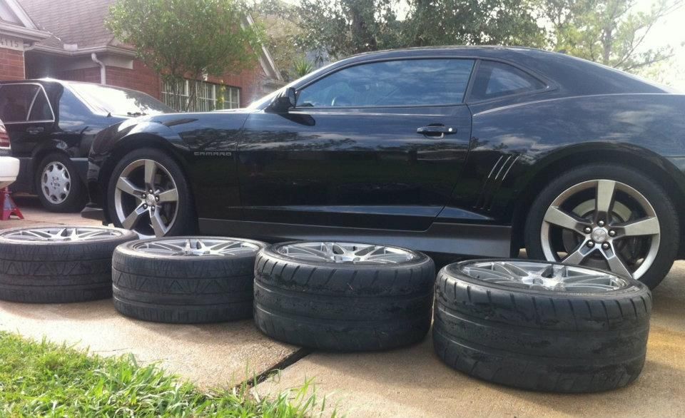

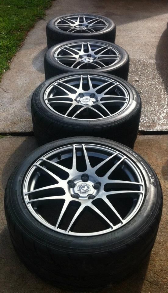

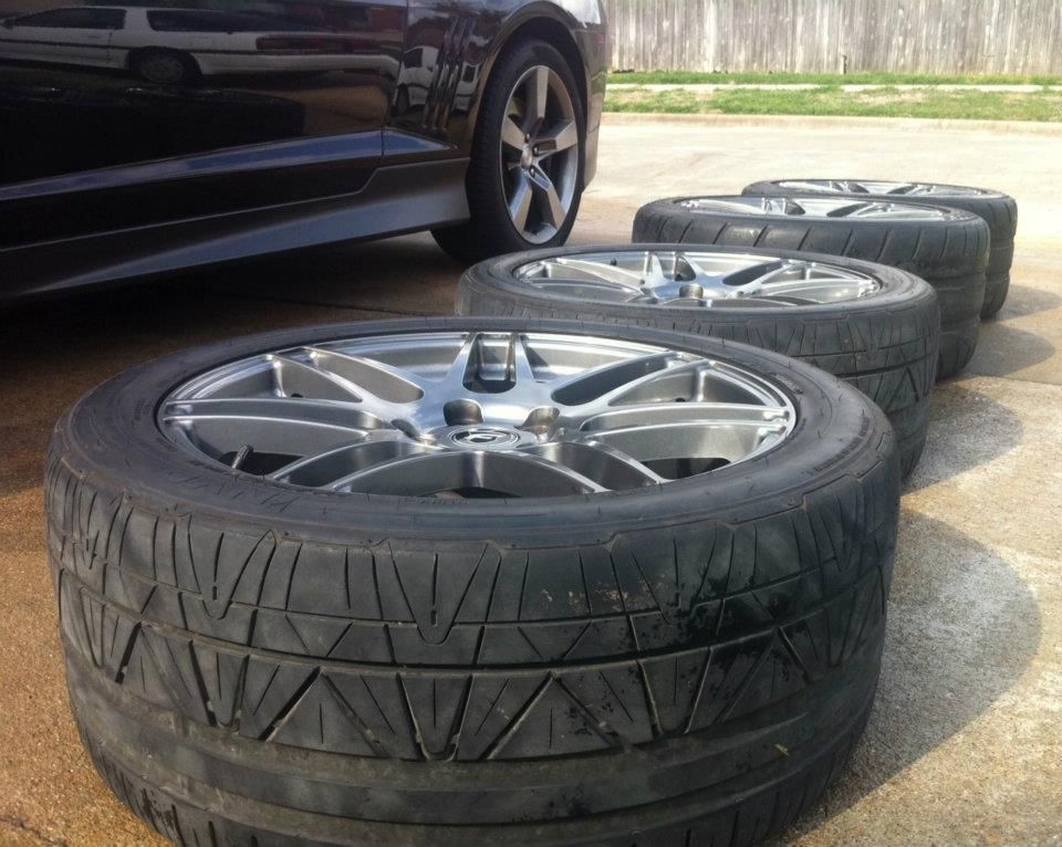

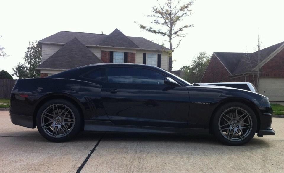

I was surfing the classifieds one day and saw an ad for some BMR lowering springs down in Dallas. I was planning on coming down to Houston the next week, so Dallas was on my way down. I asked the guy if he would hold the springs for me until I could come down to pick them up and he did. I also saw an ad for some Forgestar wheels down in Houston. So the next day after I got back, I went to go take a look at the wheels and bought them!
Here are some pics of the last time my car would be on stock wheels and springs:

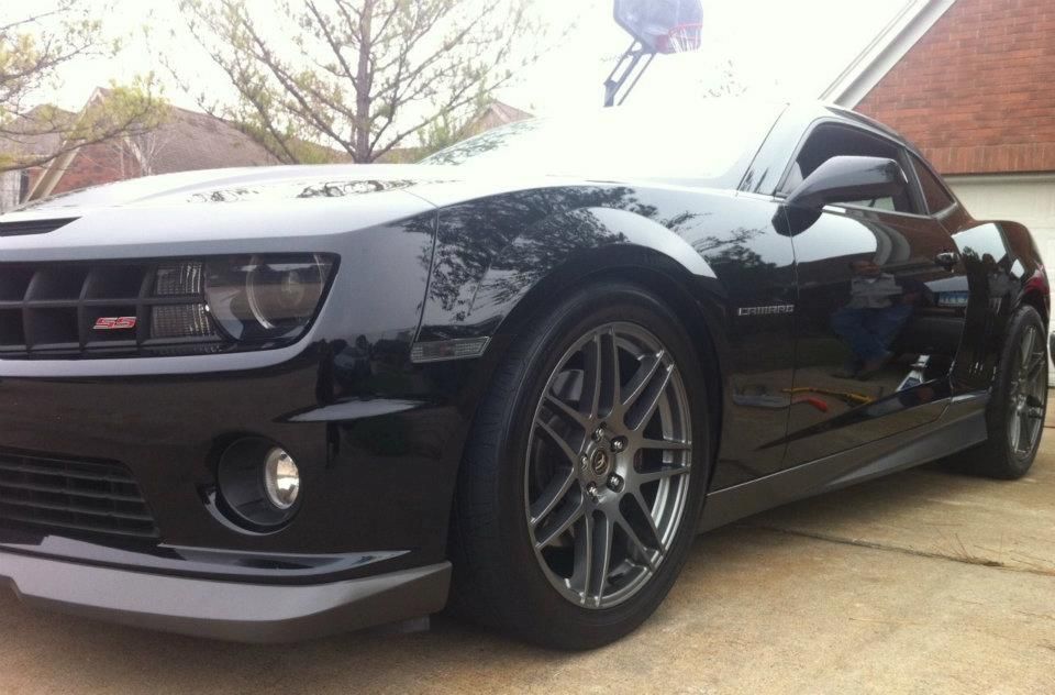

New Forgestar F14 Wheels!

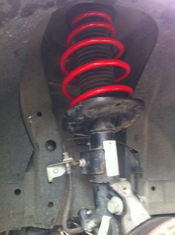

Springs installed (only have pics of the fronts installed for now, still finding time to take some good pics)
Lowering Springs Installed:
^ Fronts only installed, rears still OEM

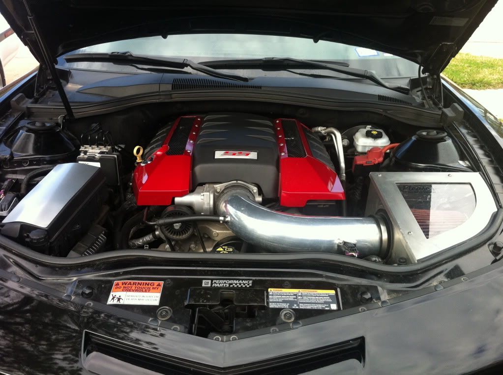

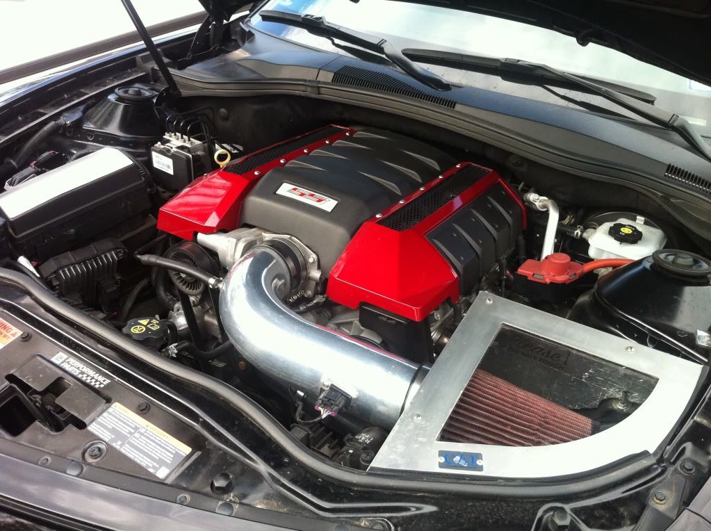

Well, a lot of things have happened since my last update in here, lol. I've been bit with the mod bug hard, so I've been looking for new mods to put on my car, while still keeping my budget intact.
Since the last update, I have bought and installed:
- VMAX Ported Throttle Body
- Taylor 10.4mm Spark Plug wires

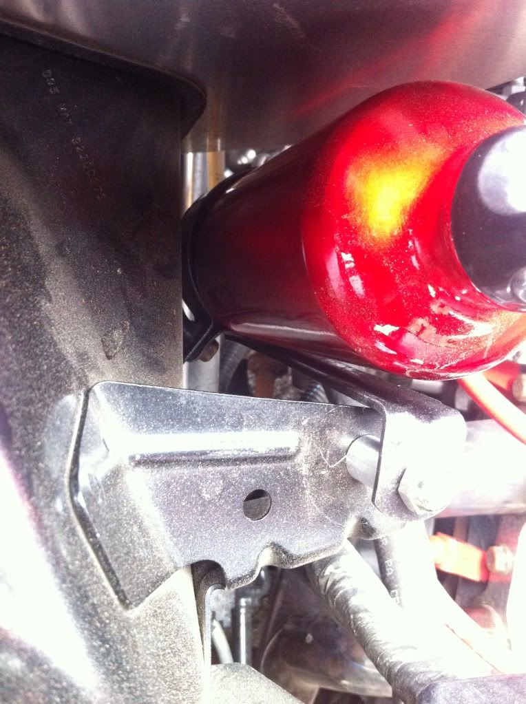

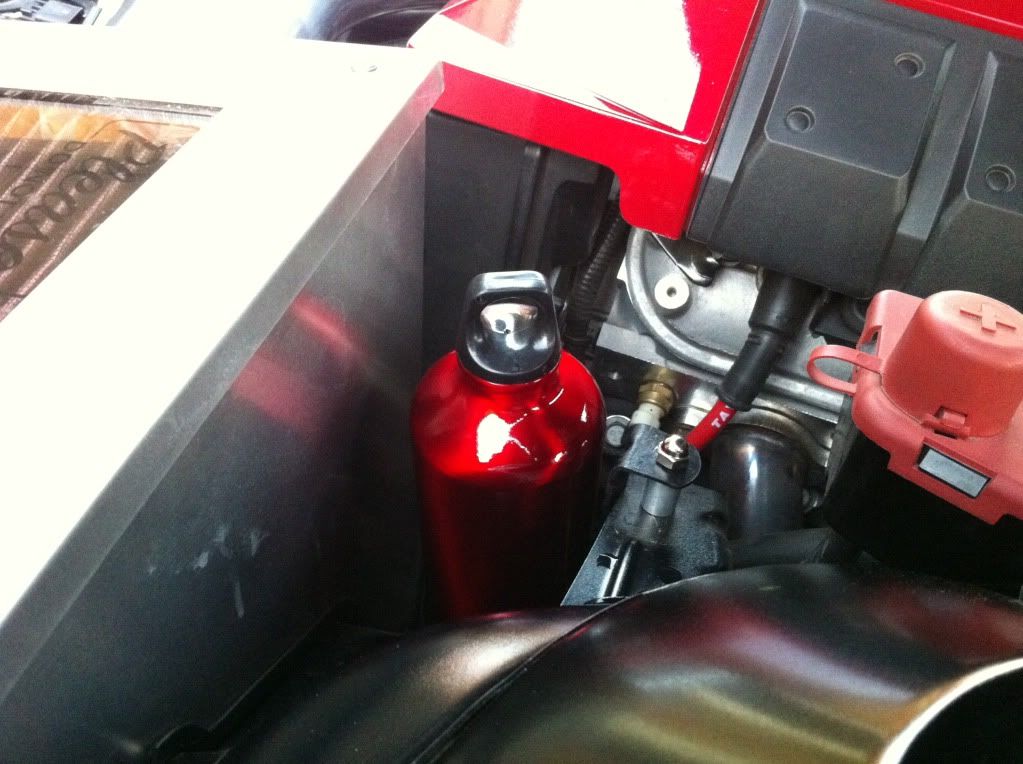

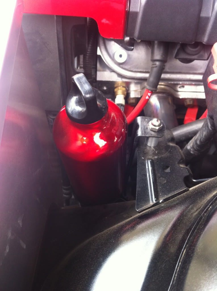

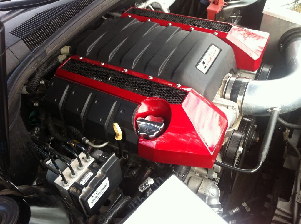

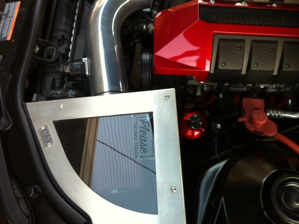

- ADM Race Intake Scoop (Big thanks to ADMPERFORMANCE!) with a homemade washer reservoir relocate (done thanks to members of the forum, specifically Caverman)

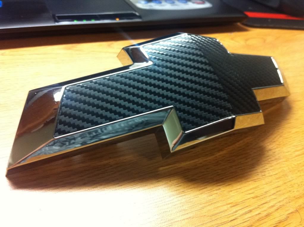

- Stock Bowtie that I wrapped in Carbon Fiber Vinyl (Thanks to DirtNMyTeeth for sending it to me!)

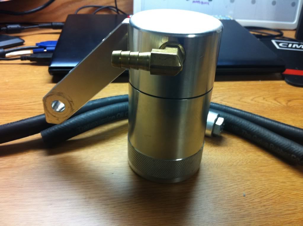

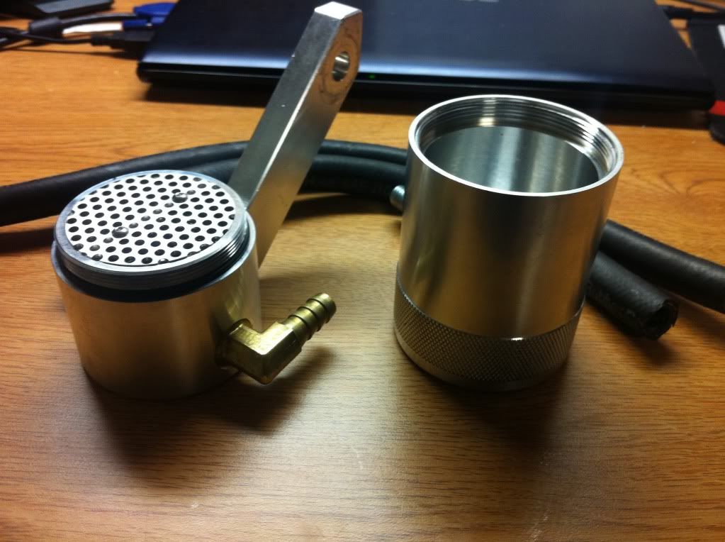

- Billet Prototypes/JamesBiz Billet Oil Catch Can

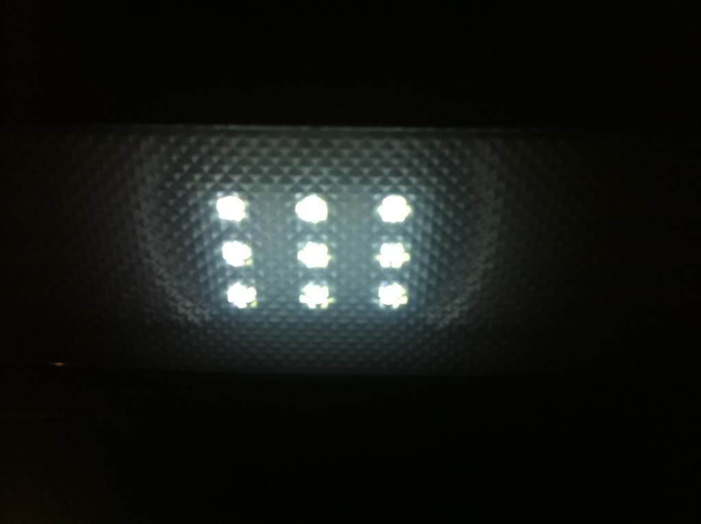

- 9 LED light board from JWMotoring for the dome light. It's really bright!
- License plate LED's and LED strips for the trunk from VLED's
I have also bought other items, but have not installed them yet:
- Gates Heater Hoses for the relocation of the heater hoses from the top of the intake
- SLP 160 degree thermostat
- LED strips for footwells
- LED for glovebox light

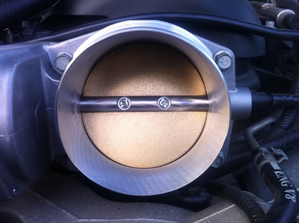

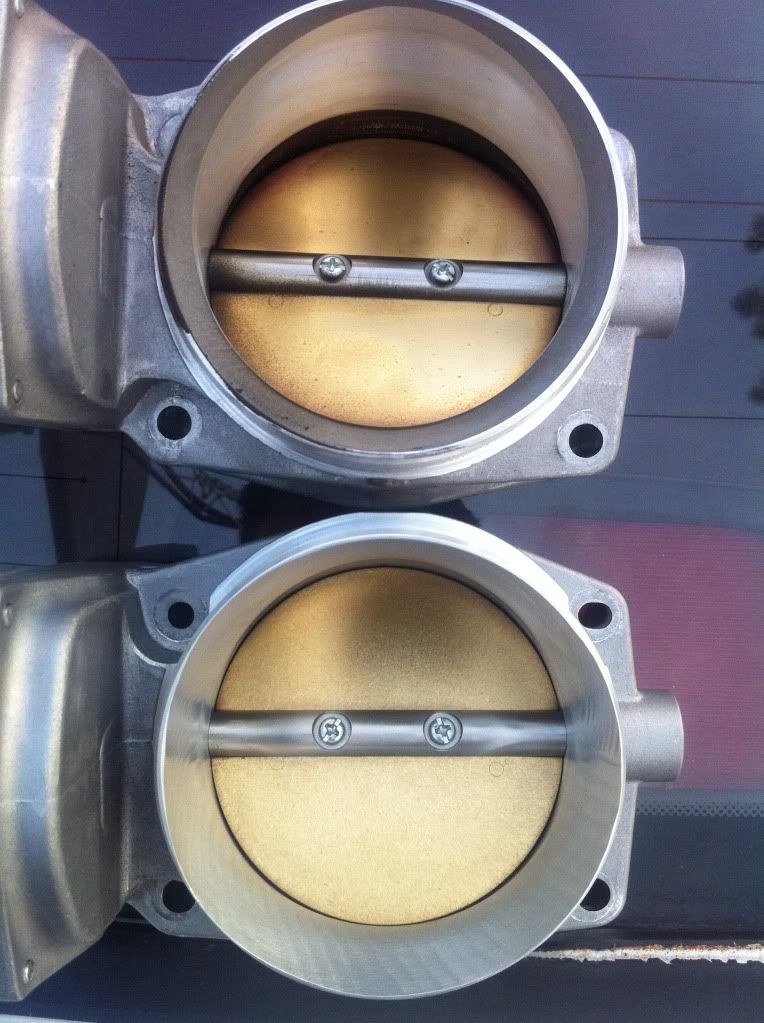

First off, we shall start the updates with the VMAX ported TB. Bought it here off the forums from a member on Christmas Day. I was planning on buying one from a vendor, but saw this one in the classifieds section, so I picked it up! Very easy to install. After taking off my stock TB, I was convinced that a catch can was needed. The inside of the intake manifold was coated in oil and there was oil build up on the inside of the TB and blade... it was nasty. I change my oil every 3500 miles too, so I was surprised at what I saw inside. Therefore, I started searching for a catch can.
Stock vs Ported VMAX
VMAX

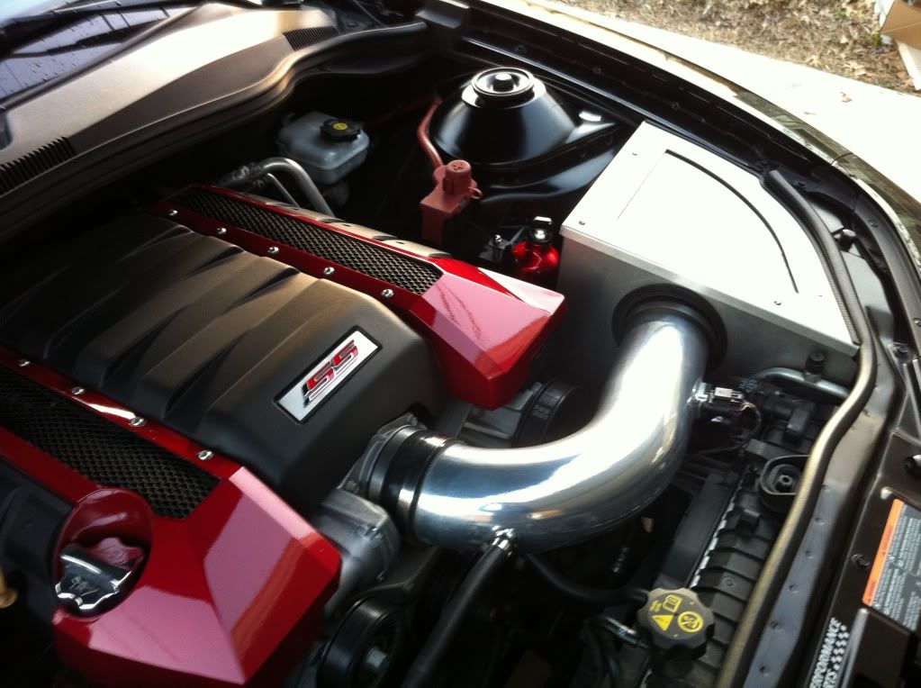

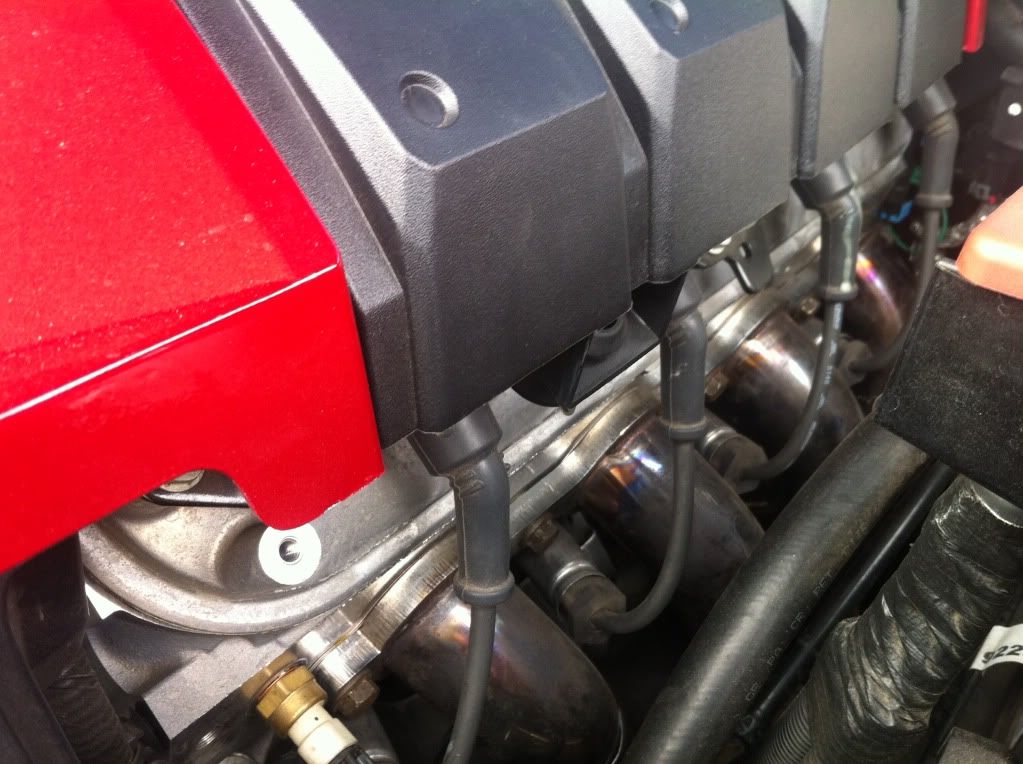

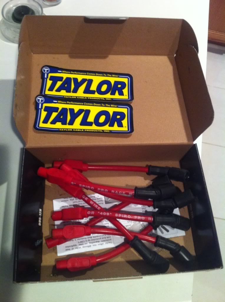

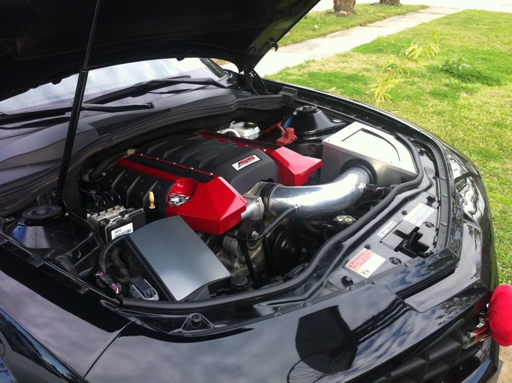

Next, I bought a set of Taylor 10.4mm Spark Plug wires. I bought these more for looks to compliment the engine bay. I have read threads on here about gains from plug wires, but I'm unsure if I really gained anything... they do look good and that's all I wanted, lol. If I did gain something, WOOOO!
Stock wire set up and engine bay shots:
After getting the wires and TB installed, I went ahead and got a tune to get rid of the CEL and to fully utilize the power of the mods I had installed. So, I paid a visit to the guys at Auto Adrenaline Performance here in Stafford, TX. Wally tuned the Camaro and was it was able to make 426 HP! Wally and the guys at the shop are great guys and awesome people to hang out with! I would definitely recommend them for working on and tuning your car if you are in the Houston area. I will probably be going there for a cam install in the future.

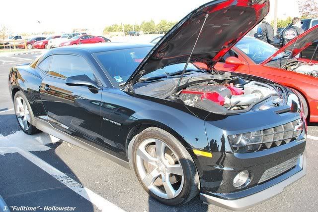

Before I left Houston for Tulsa, I stopped by Coffee and Cars at Vintage Park. Lots of clean and awesome rides out there, including a custom T-Top 5th gen! Maroon with an Edlebrock S/C. Here are some pics I took of my car:

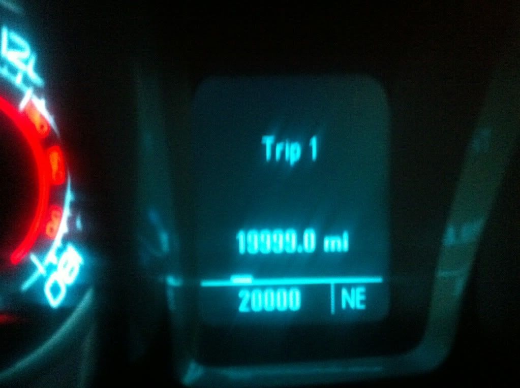

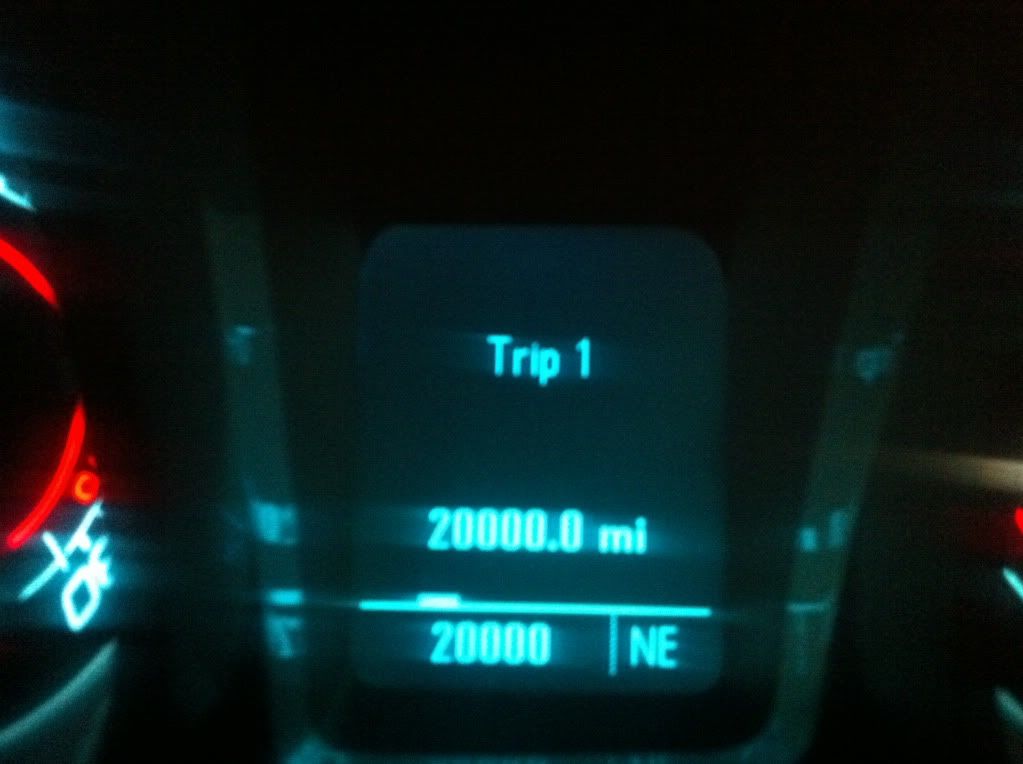

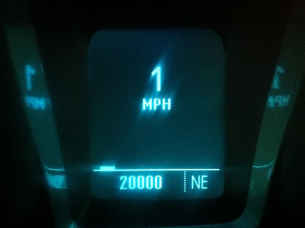

On January 7th, 2012, the Camaro hit 20,000 miles! I was on a road trip with my buddies and gave them a 5 mile heads up before I hit 20,000 to expect pulling over or something. Luckily, we were passing through a small town and a traffic light turned red right when I hit 20k! So I took pics of this exciting moment... yea Im a loser, hahaha.

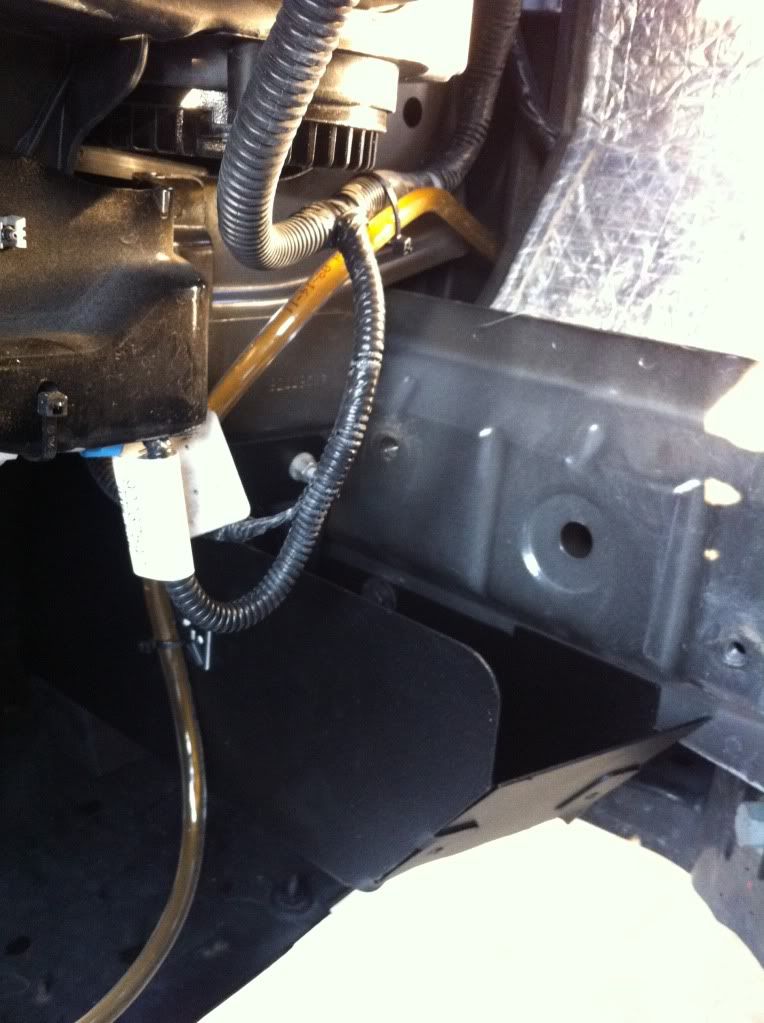

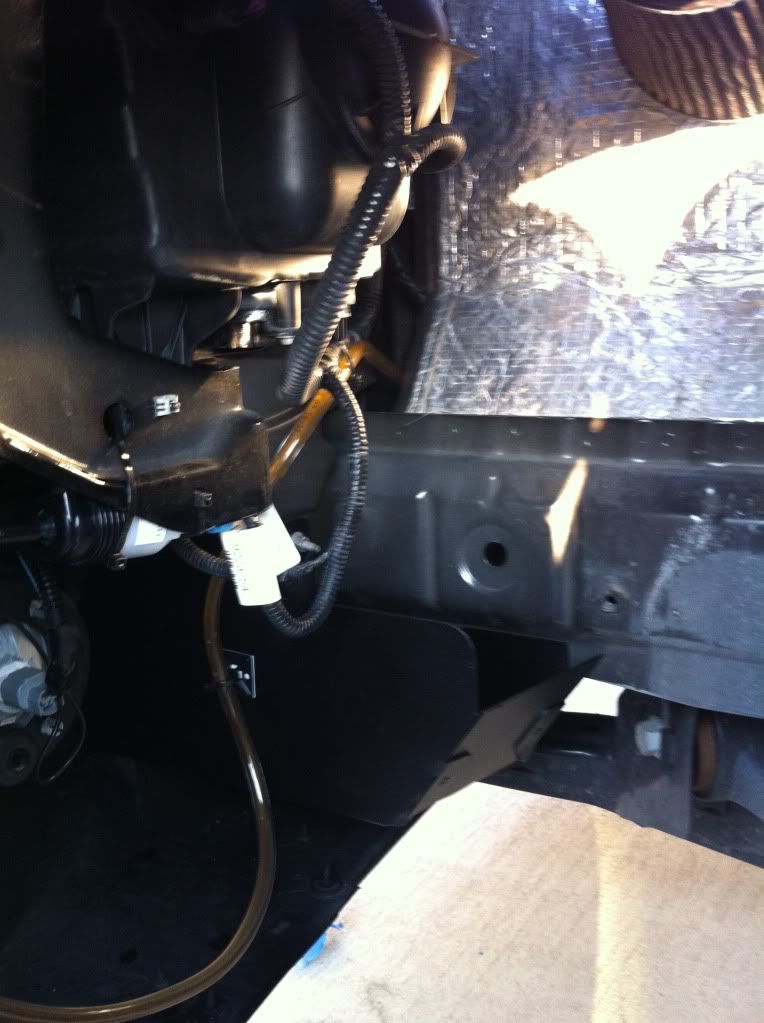

For the washer reservoir relocate, I pretty much did the same thing that Caverman did in his thread (http://www.camaro5.com/forums/showth...ighlight=scoop). I used a metal/aluminum drinking bottle, 5' clear tubing, and the same fittings he used for his washer bottle mod. One thing to remember is that you need to drill a hole in the cap to serve as a breather, or else the backpressure will starve the pump and it will just pump out air... it took me a while to figure that one out, lol. Other than that, it works great and holds 24 oz of washer fluid.

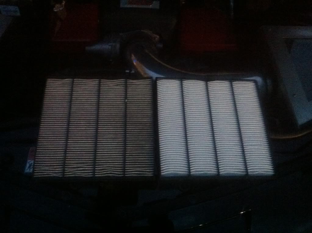

After stumbling upon a thread about changing the cabin air filter a couple months ago, I planned to change the filter. Months went by, and I still hadn't changed it... until this month, lol. So with 20,5xx miles on the OEM filter, I replaced it. The old one was DIRTY! If you haven't replaced yours, do it!

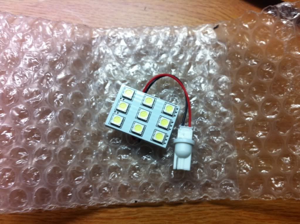

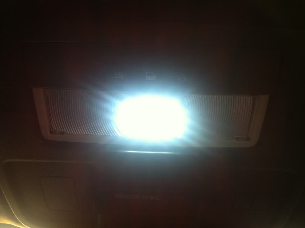

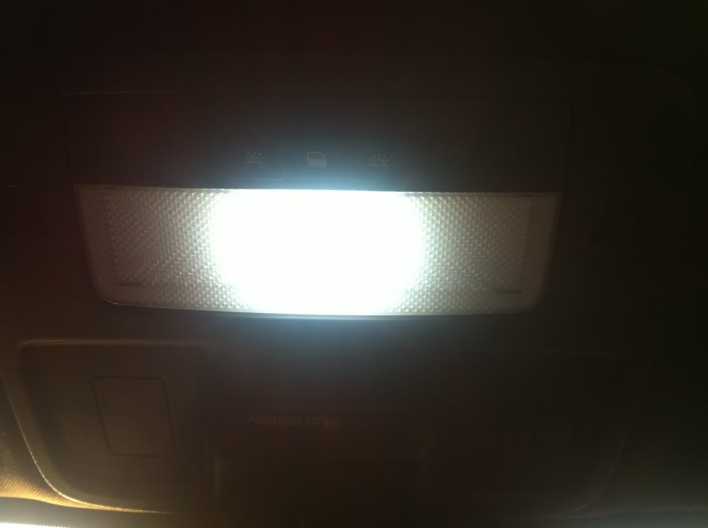

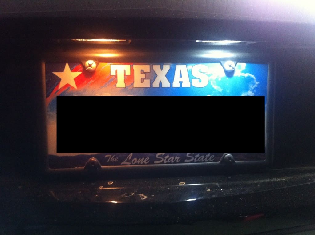

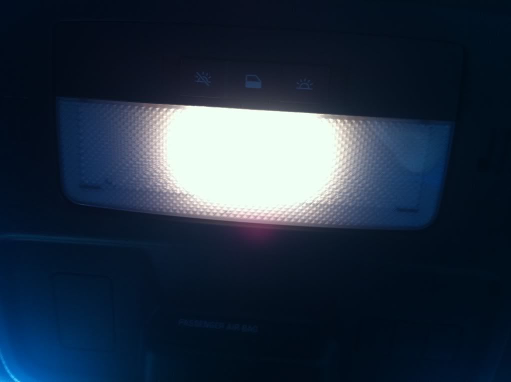

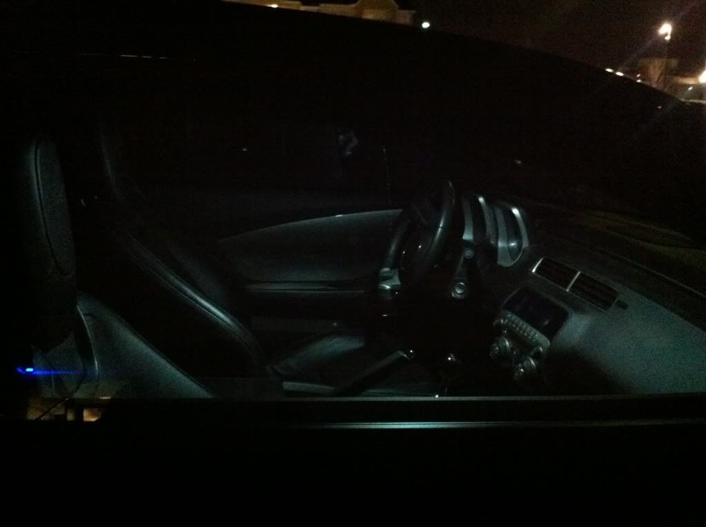

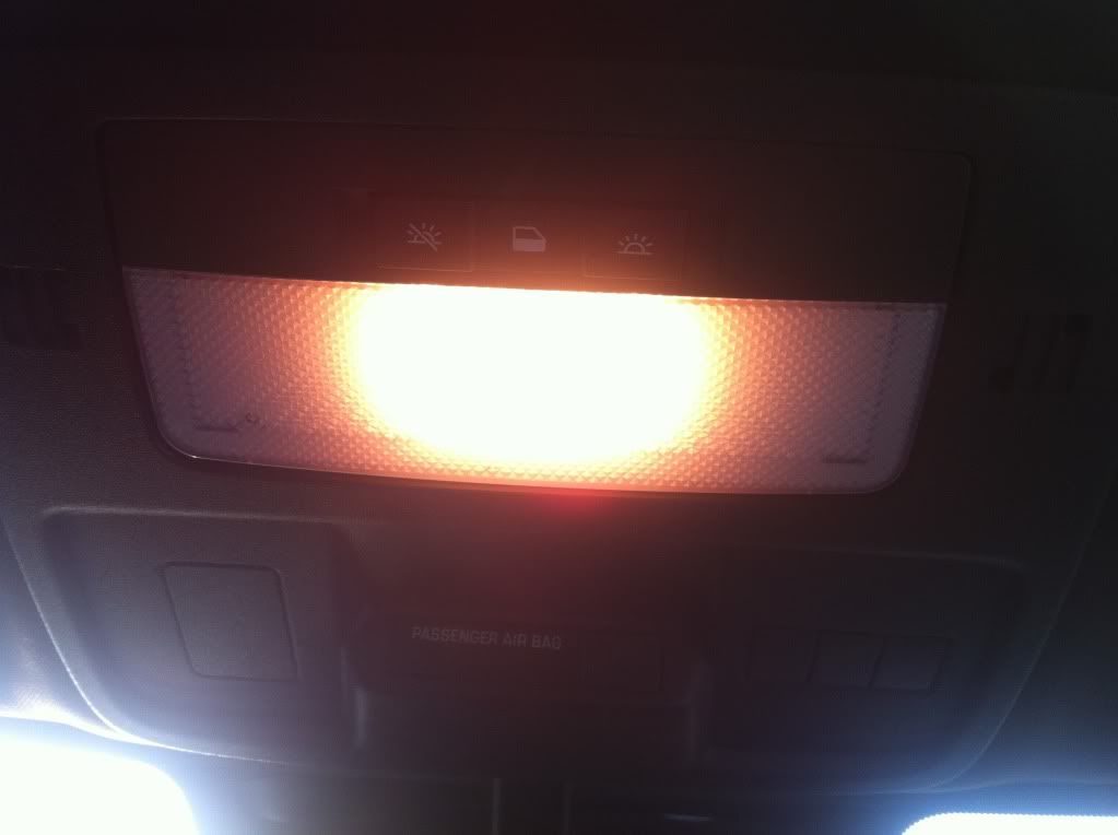

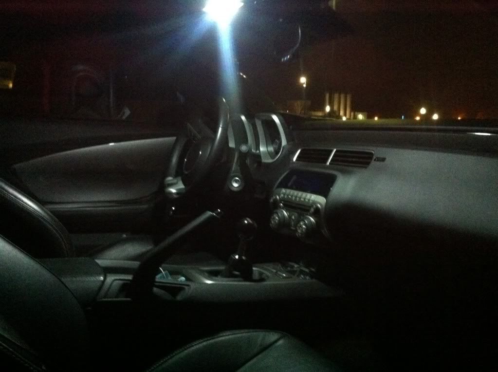

Next, I decided to improve lighting both inside and outside the car. So, I bought the 9 LED pod from JWMotoring and installed it for the dome light... man this thing is BRIGHT! Pictures below are from the outside of the car that has the windows tinted 40%...
OEM bulb:
LED:

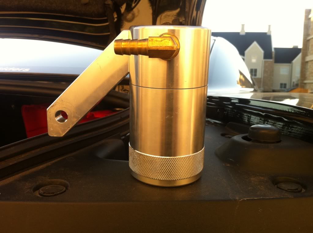

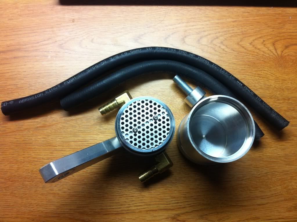

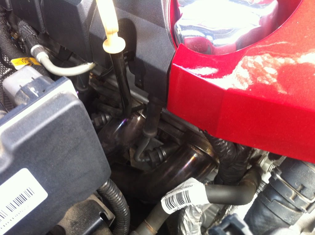

So, after seeing what was inside my intake and stock TB, I decided to search for a catch can. I was choosing between the Elite and DREV catch cans because of their removable canister assembly, but I really was on the lookout for a JamesBiz/Billet Prototypes catch can since my buddy had one on his supercharged GTO. Luckily I found one on the GTO forums and bought it! Polished it up and installed it. No current pics of it polished and installed, but I do have pics of when I got it!
I also decided to buy the Gates heater hoses for the heater hose relocation for the 2010's. I got the part numbers from yet another thread by Caverman (this guy is awesome, haha... http://www.camaro5.com/forums/showthread.php?t=107304) Since the coolant needed to be drained out anyways, I went ahead and bought an SLP 160 degree thermostat. My tune was already set up for one, so I figured why not?

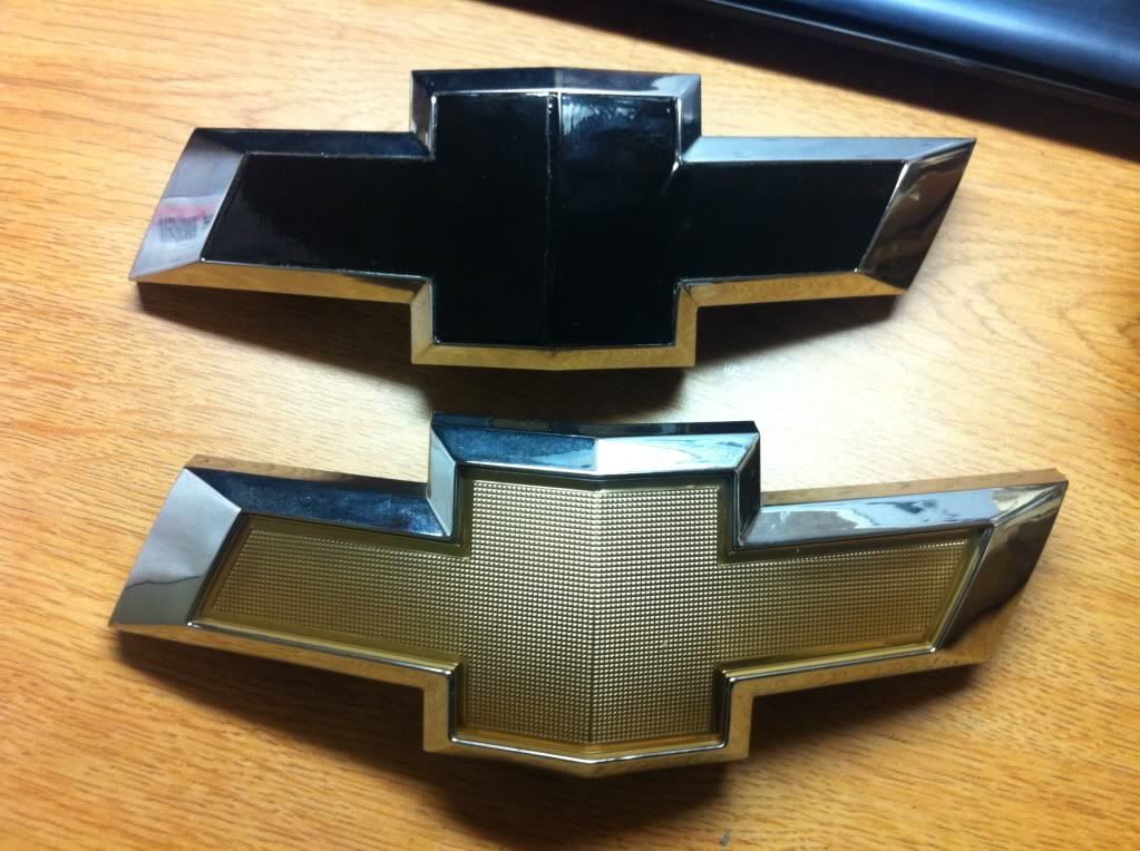

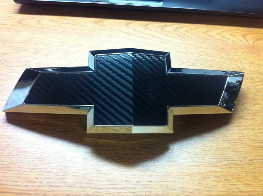

While changing out my vinyl on the front bowtie, I found out mine was cracked in 3 spots from road debris/rocks... so I searched for a stock bowtie as a replacement. Luckily, I stumbled upon the Pay it Forward thread and found someone who had one! Couple days later, the bowtie arrived in the mail along with the carbon fiber vinyl to wrap it! I would like to thank DirtNMyTeeth for sending me the emblem!

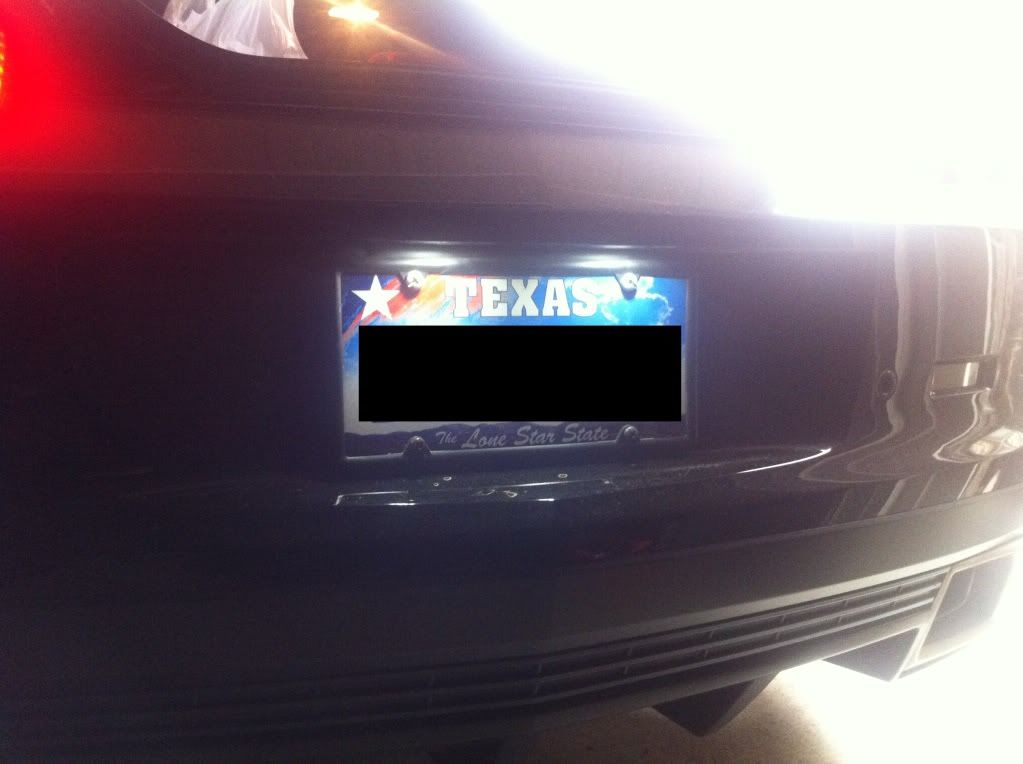

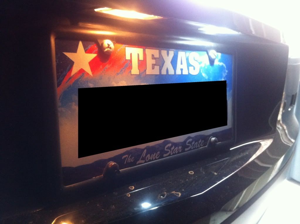

To make changes in lighting, I ordered a bunch of LED's from VLEDs. They were having a 20% off sale, so I bought lights for the license plate, strips for the trunk and footwells, and other misc. lights/parts.
Stock Halogen LP lights vs LED ones
Both LED's on
No pics of the trunk LED strips, but they are pretty bright. I'll probably take some pics when I do the footwells too.

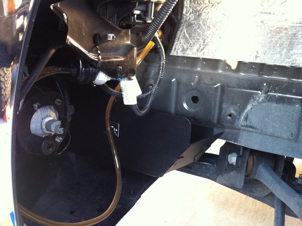

Thanks guys! Haven't gotten much attention in here, haha. I am working on putting up more updates soon though! Been really busy lately.
Upcoming updates include:
- ADM Race Intake Scoop installed (with a homemade washer reservoir relocate done thanks to members on the forum)
- VMAX Ported TB installed
- Taylor 10.4 mm Spark Plug Wires installed
- Couple more pics of the car with new wheels, drop, etc
Stay tuned!

Car looks outstanding...It simply takes time.....oh and cash...
