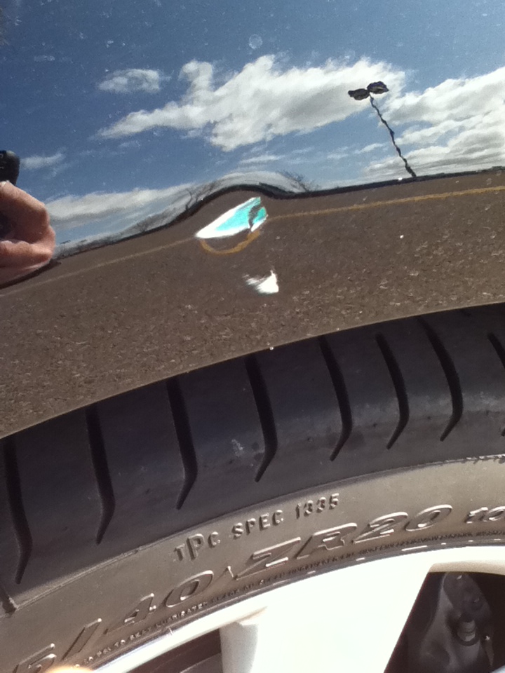

Old 03-27-2012, 06:30 PM   #4
ledeof01
ledeof01's Avatar
Drives: 2011 Camaro 1LT
Location: Cherry Hill, NJ
Posts: 9
Sorry about the poor photo quality but this is the location of the dent.

Location: Dfw, Texas
Posts: 898
He is telling you the truth, my friend does paintless dent repair, and usually toward the end of the panels they are double walled, which makes it harder to access the dent. But he could try to glue pull to make it look a little better, which they pull from the outside of the panel with glue, instead of using tools behind the panel and using leverage. That's a tuff spots, it' it was above that body line it would be an easy fix. Have to paint to get it done perfect.
