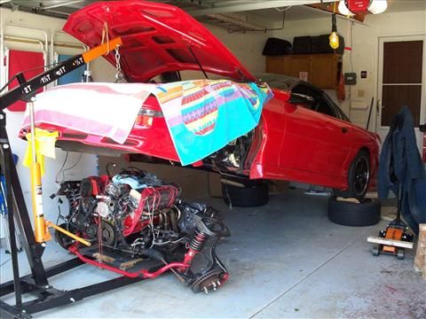

Has anyone removed and ls3 out the top with the trans still attached??

yes, but it is not fun. You need about 4 feet of clearance under the car to remove it this way with a hoist.

And the risk of damaging a fender/nose/fender well, etc. NOT the ideal way to do it but if you have no 2 post lift available it can be done.

leave the tranny in and take the motor separate, Not worth taking both of them out together, I did both ways and dropping the tranny out separate was so much easier

Engine load leveler works like a charm w a hood removal cones out throught the top even w the headers on

Here's another way of doing it.
