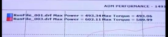

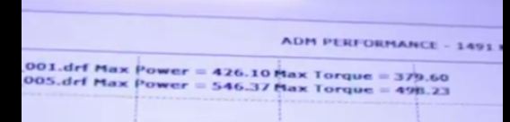

Solid package... and I like that the stock exhaust is kept in tact...
Why are the numbers so much lower for the Blue car? The gains are close to the same... Surely an auto can't be that much different.
Red Car
Blue Car

The blue car predyno was N/A built by another
Company prior to us.
We just did our ZL1 blower package with stock
Pulleys from LSA (8psi).
Red car is a real manual ZL1 with more boost due to
Pulley change.

Ahhh makes sense now... Great gains for both...
