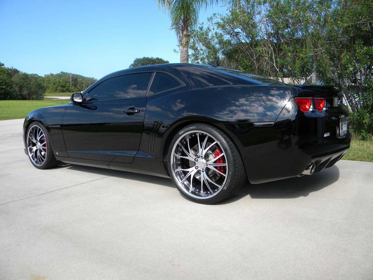

To the experts:
I have a new set of 22" rims and tires I'll be installing when I get home (currently deployed oversees). My question is can I install drop springs with that size of tire without having clearance/rubbing issues? Would it be recommended to lower the car with 22's? If anyone else has, can you post a before and after pic for me...I want to make the decision now...If I can I'll order the spings now so I can get everything done at the same time.

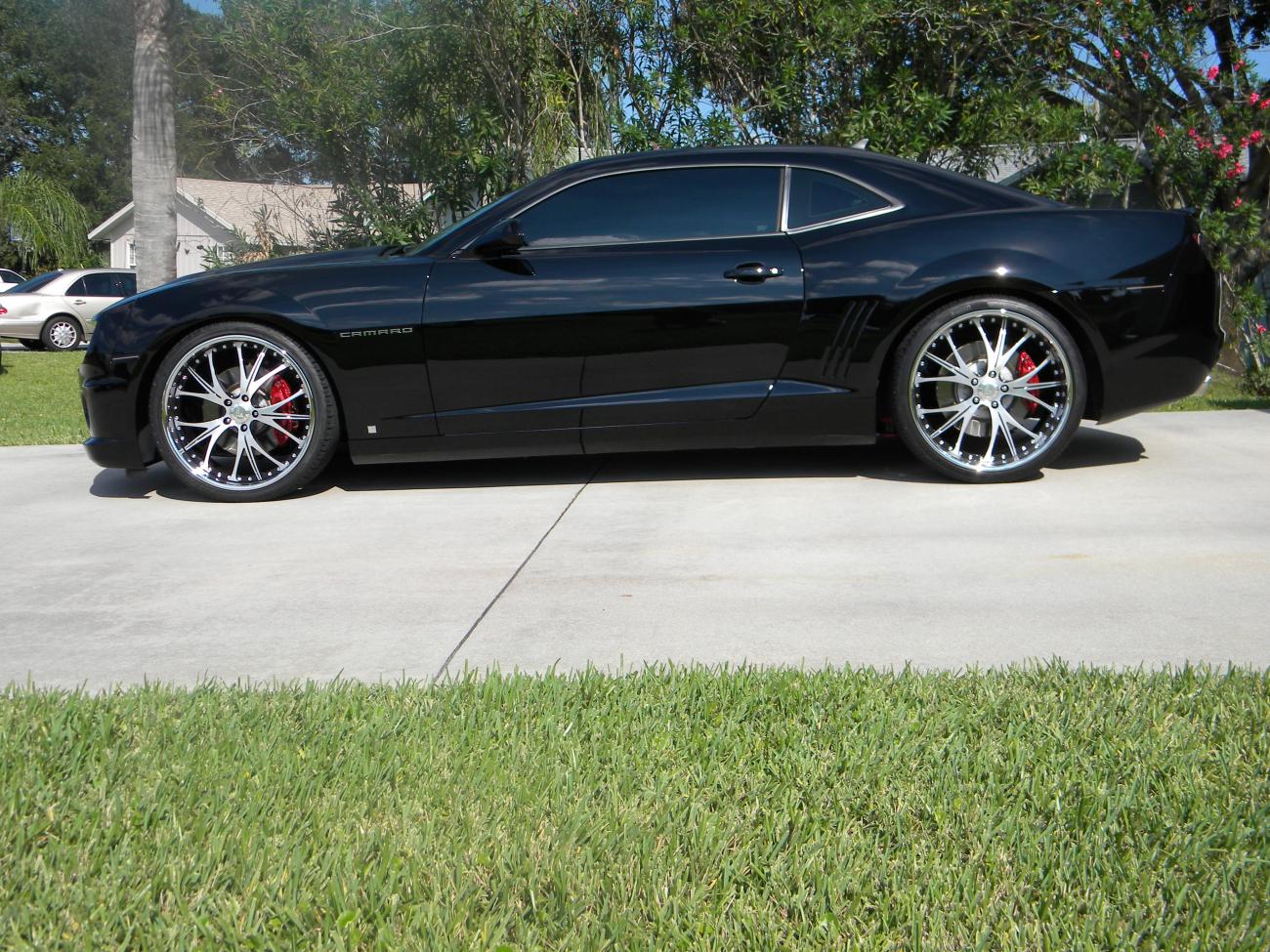

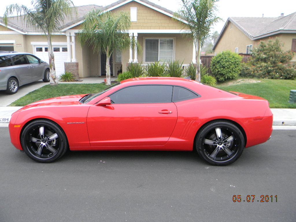

It is going to depend on what size tires and offset you will be running. I waited about 6 months before I pulled the trigger. I really thought my tires would rub. After lowering I have not had any problems. I'm running 265/35/22 on 9 1/2" rims on all 4 corners.

Are both these 1" drops or did you do a 1.25"?
I'll be riding on 265/30 in the front and 315/25 in the back...and looking at BMR or PFADT springs.
Thanks for the pics
