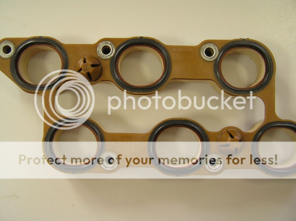

here is a pic of the gasket sitting on the head ports, i will be fixing this myself, stay tuned for that.

i am using 2 oem IM gaskets, one below the spacer, and one above. you have to trim off the little cone shaped alignment bosses on the gasket going below the spacers. i used a side-cutter to snip the little legs off and an exacto blade to trim the flash away so the cones would separate. i used an exacto miter saw to trim the alignment nipples off the gasket that goes above the spacers.
