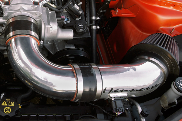

After looking at the Fastlane performance "true" cold air intake and comparing it to the ones like the Hennessey. From an engineering standpoint, I have a feeling there has been ducting work to direct air right behind the driver side headlight, but the lower CAI makes sense too- so, what is everyone's opinions and experience about the PERFORMANCE- keep the "omg the true ones suck water into your intake horror stories" out of the conversation.
Picture of conventional CAI-

A true cold air induction system needs to be a minimum ove 24"(Thats right 2 ft) off the concrete.
We have done countless testing of this in the hot summer and cold winter here in Tx and found that the heat off the concrete or asphalt is 10-18 degrees hotter on the same vehicle at 2 ft off the ground.....If I could make it look right I would get my air 20 ft up...but not possible and keep it clean looking.
BTW-I challenge anyone here to run the same test we ran..Our test was a TRAILBLAZER SS WITH THE FILTER BEHIND THE LOWER FASCIA AND GRILL AT RIGHT GRILL .

Hennessey's setup is a hot air intake, not a cold one. Without something to shield it from engine heat it is a shiny waste of money.
looks good though, and for some people thats enough. not me though. when i replace the stocker, i will get one with a shield.

I've wondered about trying to pick up air from off the pavement, and now that's been answered - thanks. It makes sense to me. Personally, I'll be looking for the system that introduces the coolest air and has the least amount of bends/restrictions. Hennessey's set-up looks good, and though I remember him commenting on getting a heat shield on production systems, I think I'd like to see a filter pull air in from outside the engine compartment. I can just see idling at the line, just after a burnout, heat bleeding off the headers/manifolds and just soaking a metallic (or even plastic) shield where that particular filter is. I'd prefer a system that relocates the filter below-behind the headlight, even though it'll introduce more bends. I suspect if the tubing is large enough restrictions from the bends will be minimal.
if u read the add for the product it says it comes with one not pictured aboove. it DOES come with one

Some thing else to consider guys, Cold vs hot air perfomance gains are minimal, and as ADM has said there is a optimal height at which you need to bring in the cold air. The real benefit to these systems is the increased air flow. That is where 90% of the horse power these parts create comes from.
There is minimal difference between cold and not cold Air intakes. especially on a DD car.
