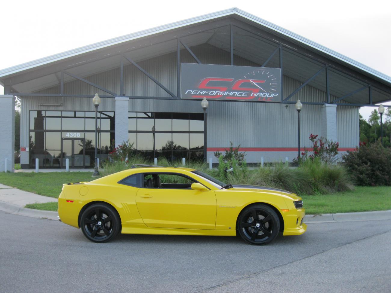

our new motor
Just came back and hoping to have by next weekend!!!!!!!!

here it is.

As far as a rundown of the major components of the build:
Engine:
Total Engine Concepts 376 CI
Factory Crankshaft
Oliver Connecting Rods
JE Inverted Dome Pistons (approx 9.2 -1 Compression Ratio)
Custom Camshaft (231/248 duration .617/.596 lift)
BTR Platinum Dual Valve Springs
BTR Pushrods
LS9 Headgaskets
ARP Headstuds
ARP Rod bolts
ARP Mainstuds
Power Adder:
Whipple 2.9L Polished Supercharger with Heat Exchanger
4.000" Pulley making 7.5-8 #'s of boost
Roto-Fab Polished Cold Air Kit
Exhaust:
Stainless Works 1 7/8" Headers
Stainless Works Full 3" exhaust with X-Pipe
Transmission:
FTI Billet 3200 rpm converter
Hayden Transmission Cooler
Tires:
275/40R20 Nitto 555R Drag Radials
Tune:
SS Performance Dyno Tune
I think that about covers it. Anything you guys need dont hesitate to let me know

What's it putting down for power? It looks like it's an absolute beast!

they been dynoing some but takeing it easy till the break in on the new motor. we are changing one of the pulley to a smaller one to get more power. hopeing soon to have the dyno numbers. and yes it's a beast and can't wait for the track.
