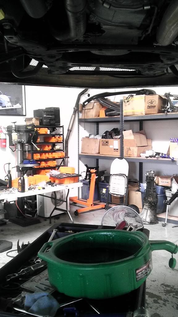

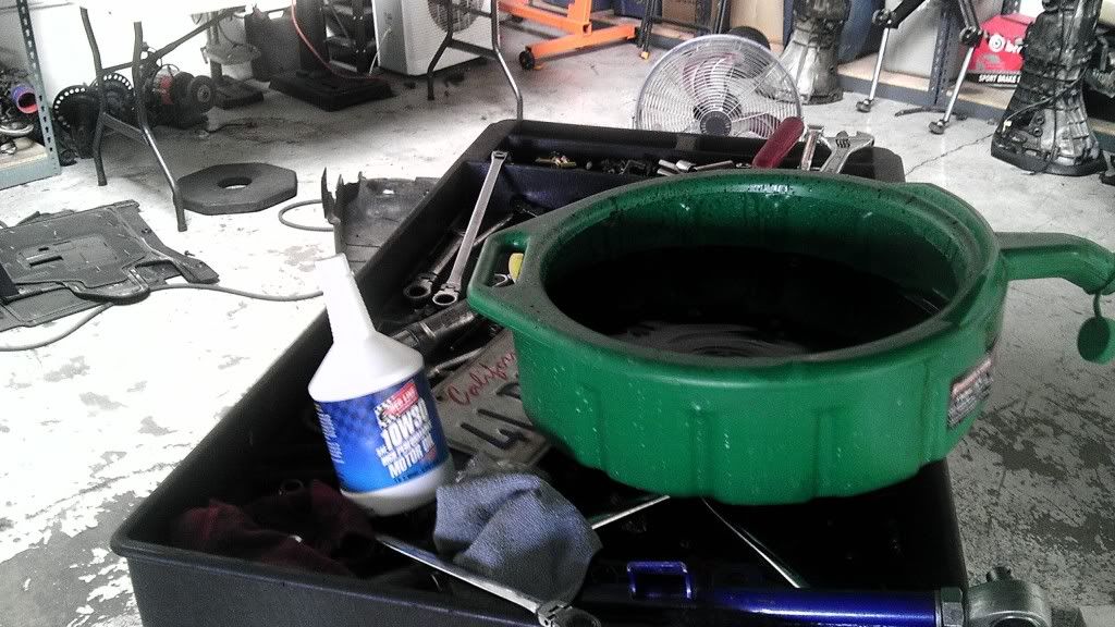

Well it is about that time to change all the fluids again. Car has 23k miles and wanted to do a full oil change. My engine oil was in dire need of a change anyways. This time I changed all the fluids with Red Line Synthetic Oils. The engine oil, transmission fluid, and rear differential were changed at the same time. So I wanted to make a review showing any differences i might have felt. So I asked my friend if I can borrow his lift and went to work this past weekend.
The first thing I changed out was the engine oil. The previous oil I had in the car was Castrol Edge Titanium. I changed it out for Red Line Synthetic 10w30 Oil. The engine oil change was a pretty straight forward. The Castrol engine oil smelled pretty bad, but that is probably because i am running a little rich and havent changed my oil in a while. Filled up 8 quarts and have 1 more for back up.
Now i moved onto the transmission fluid change. The previous oil I had in there was the Mobil 1 ATF fluid. I changed it to Red Line D4 ATF fluid. Pretty straight forward change again. The old fluid wasn't that bad, but wanted to change everything for ease of mind. Chevy was nice enough to label fill and drain screws, so there shouldn't be any mix ups lol. So I hooked up a pump and pumped in 4 courts D4 ATF. Pretty easy to do as well, especially with a lift.
Lastly, there was the differential fluid. The previous fluid I was running was the Mobil 1 stuff that is like the factory fluid. Last time i changed it was around the 2-3k mile mark. So i changed it again to the Red Line 75w90 gear oil. Everything would have went smoothly, but right after i finished cleaning the pump i used for the transmission I broke it and couldn't use it. So I improvised and used the gravity technique with a really long hose. I added half a bottle of the GM friction modifier, even though you don't have to with this fluid. The rear diff only takes 1 quart and finally I was all done.
So now for the review. I could tell instantly that the transmission was less notchy and smoother. Even after sitting all night and driving it in the morning, the transmission was smoother and less rough in cold weather. So was happy about that. The rear differential had a difference too. I changed out all the diff bushings just recently so it had some noise coming through the cabin. The whining of stiffer bushings everywhere. I could notice that the whine was less noticeable and quieter. The whine is still there, but that's what I expect from having changed every single bushing on the car and having stiff suspension. I am just happy it decreased the noise on the street and highway. Lastly, was the engine oil. Its hard to tell the differences without a dyno and if people say they feel the difference they are lying. Cause it will be impossible to feel a 1-2hp gain lol. Especially when you already have 600 rwhp. Now if your going from Dino oil to synthetic you could feel some differences I bet (Like in smoothness and what not). I did notice that my MPG went up a little, but I think that was because my oil was really old. I haven't done a track test yet, but I am sure the fluids will keep up with anything I throw at it.
So my final verdict is that Red Line has some great products. If you are deciding to change your fluids out in your Camaro or any car that Redline should be one of your top options. You cant go wrong with Red Line, they only use top quality stuff and are used by many racing teams. Overall your car will feel much smoother and be protected. A+ for Red Line.
