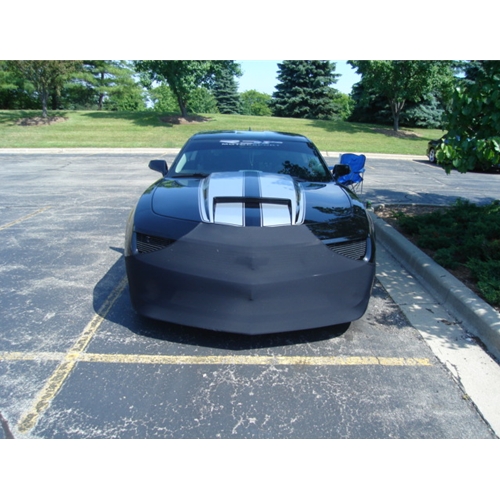

bug removal
take off, SHAKE and put it back on. all in 5 minutes or less!
