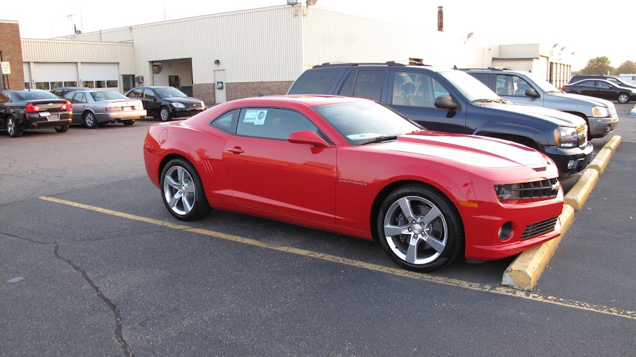

July 26, 2010 Delivery
I took delivery of the car on July 26, 2010. It is a 2010 1SS RS M6 LS3
August 1, 2010 Mileage 460
I didn't waste much time with starting the mods. Just 5 days after owning the car I started modding it and it has spiraled out of control since
Bone stock LOL

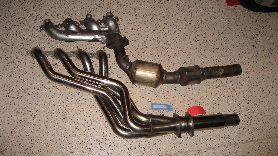

First mods were a Roto-Fab cold air intake and a set of Kooks long tube headers purchased from Marylandspeed.
I decided that now was as good of time as any to void the warranty, so I ordered an SCT tuner from Jannetty Racing and loaded Ted's tune into the car. These mods made a huge difference in sound and performance of the car.

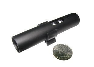

Elite Engineering Catch Can installed.

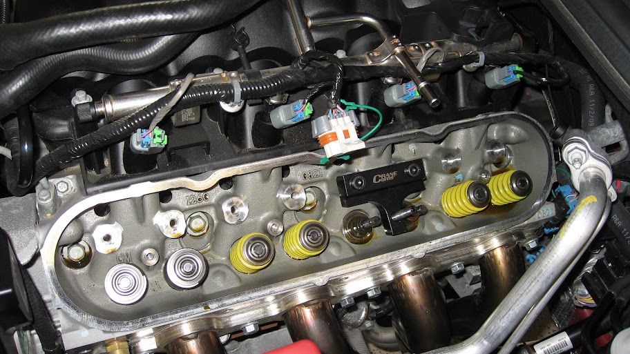

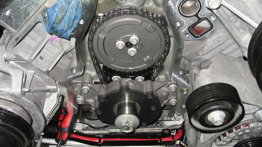

Time to crack into the motor! I wanted a cam with a nice healthy lope at idle, made good power throughout the entire RPM range, and was also blower friendly. I ordered the JRE 470 Rough idle blower cam package from Jannetty Racing.
Here is the list of parts installed:
JRE 3 bolt cam
Hardned pushrods
Dual valve springs, seats, seals, retainers, locks
Trunion upgrade
3 bolt timing gear
Katech C5R Timing Chain
LS2 Dampner
Meling HV Oil Pump
Katech heater hose relocation kit
New gaskets and seals
Here are a few pics from the install
