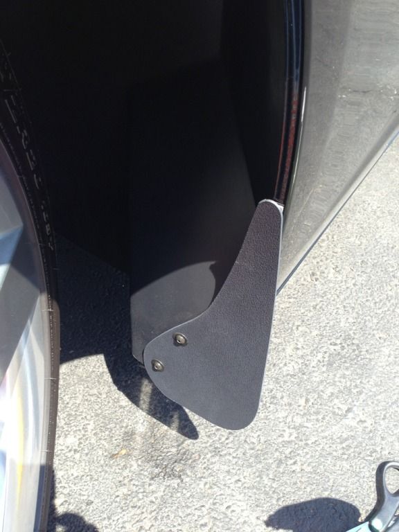

Front splash install:

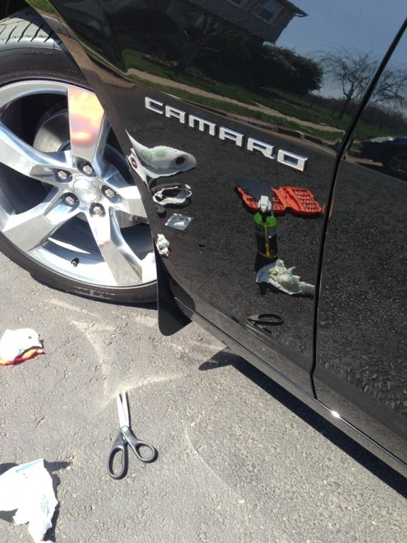

cleaned the wheel well, applied 3M mounting tape
After install:
view from the back

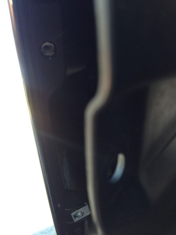

Rear Install
Removed 3 screws, pulled back liner and cleaned the area
Placed ZL1 splash guard, making sure it was properly aligned. Little holes will actually match up with holes behind the liner. There are spaces for the bottom two screws, but it won't fit like the topmost one
Placed the lining back on top of the ZL1 splash guard and screwed it on. No need to cut the splash guard, behind the liner there was a smooth surface
After install. I took the wheel off because i didn't have a tool that would allow me to keep the wheel on and remove the screws. Gave me peace of mind that i screwed it in tight though.
How it looks from the back. Little extra space sticking out from the guard, you can see the little hole as well. Nothing too bad unless you're looking for it.
Overall I really like the ZL1 splash guards, they blend right in. The front ones are ok... I only wish that they were deeper in color in the rough part. They are an off grey, and my wheel wells are black. Also wish it somehow fit behind the wheel well liner as well like the rear ones.I sprayed it with some Adam's invisible undercarriage spray and it made it much darker. Hopefully it will not fade back to grey too easily. The back side/smoother side was darker and blended in better with my black paint.
Drove it around a bit over some small rocks, and they seem to work very well! Definitely less noise from and i feel better knowing my paint will not get so easily chipped
