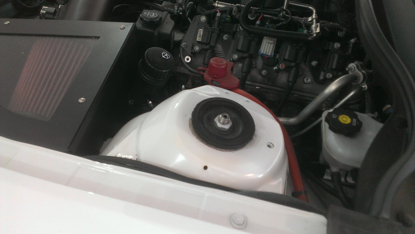

So finally made some time to get this project started:
For a reference, I used the Pedders' installation manual for their coilovers to disassemble everything properly, and Wretched Rob offered his advice too. Thanks Rob! You can find the Pedders' manual here: Pedder's Coilover Manual
First thing to do is remove adjustment knob on top by loosening the retaining nut directly below it (Rob assured me I wouldn't break it. Other coilovers I had never had the retaining nut. I was scared...):
Next, loosen the strut's top nut. I already had car on stands with the wheels off, so I used the jack to create a little pressure on the strut to keep the shaft from spinning:
When removing the sway bars, I highly recommend using another wrench to secure the back of the threaded post of the end-link. I try to avoid using the allen wrenches whenever possible:
Again, I used the jack on the sway bar to relieve some tension from the end-link so they would slide right out:
Before I removed the clevis bolts and dropped the strut by removing the top nut, I lowered the perch to free the spring and remove pressure on the stut's top hat. Wipe the threads on the strut down so there's not any debris that could get caught in the rings. I made sure to measure everything before I loosened it, so I wouldn't mess up the alignment by Back Street Performance ( gratuitous plug... ) I also removed the two 10mm bolts holding the brake line & the ABS wire:
Used a spare jack stand to support the assemble after I removed the strut:
I like to put bolts back in where they came from after I remove parts so I know exactly where everything goes and so you don't have any "Oh, shit... Where did that go?" moments:
Once out, I cleaned them up:
I then cleaned the towers, top and bottom, from any dirt & goo that had found its way up there:
Sorry I didn't get a picture of removing the strut's top hat. I couldn't work the camera and use 2 hands... I got the top nut off by laying the strut on its side (on cardboard, as not to scratch or mar) and standing on the end with one foot. If you stand on the side that you're turning towards, you can wedge it between your foot and floor, so you can get some torque on the nut.
After your remove the old rubbery top hat, replace it with the new & improved one. Remember: Rubber is for condoms, not suspension joints:
Again, I'm sorry for not getting pics of this next process, but I either need a third hand or an unbelievably patient girlfriend. After I aligned the plates from the top, I marked the tower itself on where the plated alignment marking lined up, and I marked a lower spot on the plate itself, again in line with the alignment mark. I then placed the plate beneath the tower and used C-Clamps to hold it in place. I used the mark on the tower and the mark on the lower portion of the plate to align it. I then drilled from the bottom up (used safety glasses). It was more time consuming, but it paid off. I was able to make sure my pilot holes were dead center when I drilled. On top of that, to really show off my OCD, the bolts are 5/16", and I only drilled the holes to 1/4". I then used a round file to open up the holes to exactly match the plates. If you choose to use this technique, don't do what I did and scratch the tower with the file... Still hating myself for that:
I got everything mocked fit last night, and I plan on torquing everything down tonight.
Thanks again to Pete @ Pedders, Rich @ Back Street, & Rob @ Wretched for all the amazing parts and assistance!
