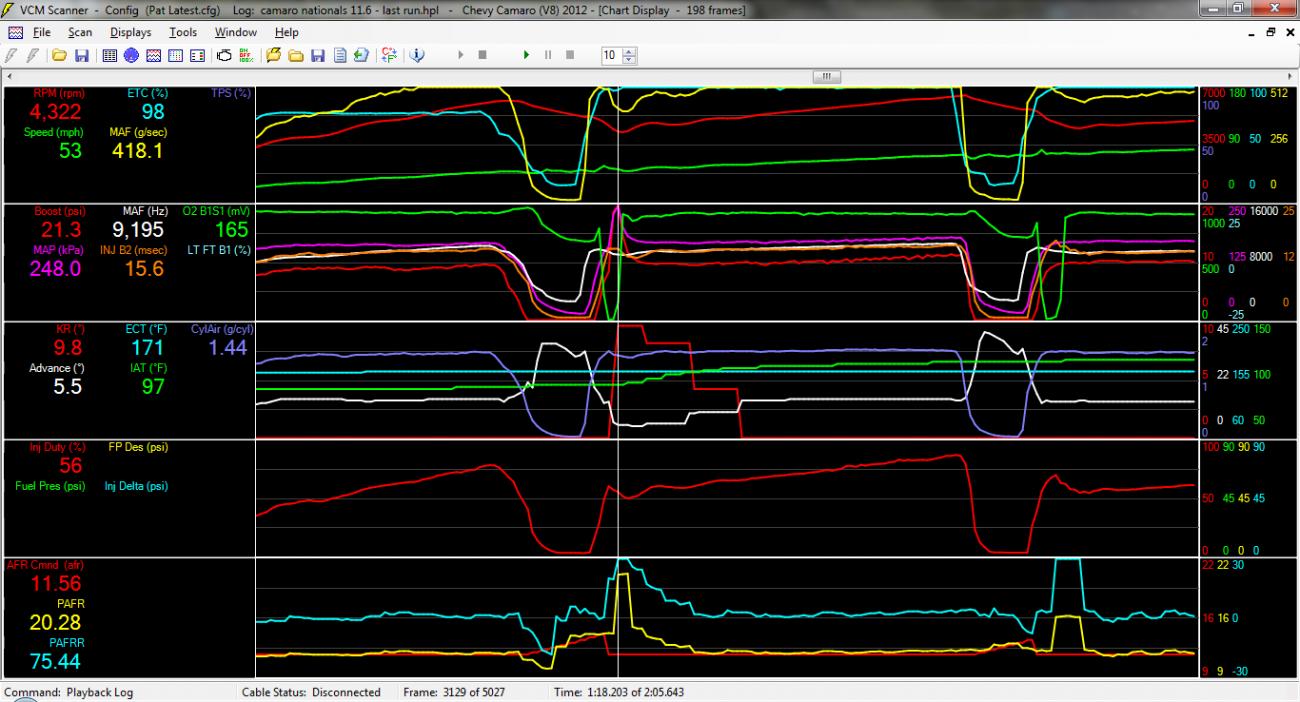

For a while I've been working on "reducing" the lean spike after a gear shift. Occasionally it will cause knocking so avoiding is ideal to avoid timing to get pulled (or something worse). After much review, I had an ah ha moment today...the lean spike isn't the issue...it’s a "boost spike".
I never noticed this before, but on a gear shift, i will occasionally see a "boost spike" like pictured below. The boost spike is significantly higher than my "normal" max boost (i'm running 15-16psi, and the boost maxes out my MAP sensor at 22.3psi). As a result I get a lean spike and ultimately detonation.
Any others with a super charger seeing this boost spike on gear shift? Has anyone solved it?

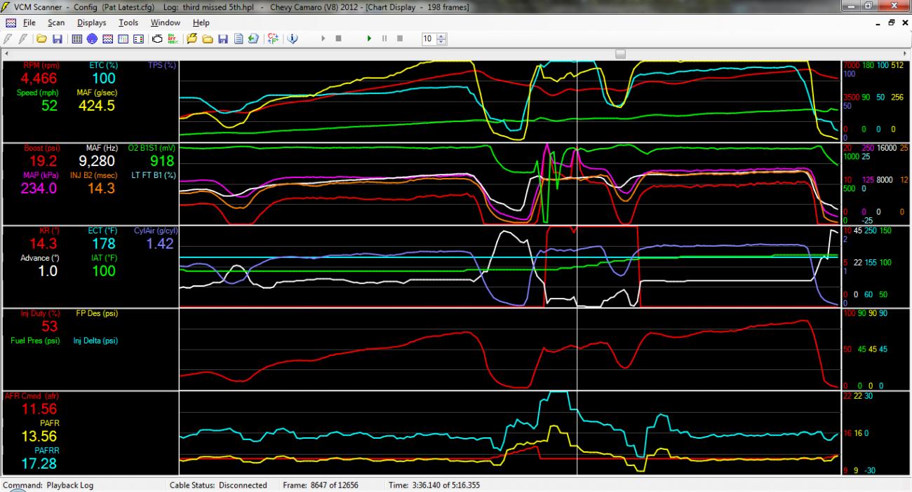

So looking back at old logs, i've had this "problem" since day 1. The first shot shows a tuning log right after the whipple install on a stock motor (4" pulley). No AFR gauge at the time.
The second snap is from a texas mile run and shows a double spike! Only one of those i found. This was while running race gas. I had a 3.75" pulley getting a little over 11psi. Street tires.
The 3rd is at the track w/drag radials. Also getting 11psi. This should have been my best run ever, but no doubt the knock made me lose a few hundredths (was a better launch than my all time best that same day).
Last was another run at the texas mile. This was going into fifth gear...as you can see i had trouble getting there , i'm hoping this was resolved with my upgraded clutch, but i could never shift cleanly to 5th at 145 mph... anyway, this one surprises me the most because the blower had spooled down prior to getting in gear, but still see the spike.
Am I the only one experiencing this w/a Whipple or PD blower? Or am i the only one that keeps all his logs.
These snaps are all before Meth and engine mods.
PMJ is offline   Reply With Quote
