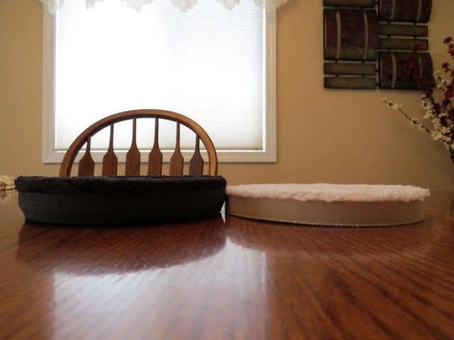

So recently I've been working with the Buff and Shine Microfiber pads. Same idea, different company. Here's a side by side, white is Optimum
As you can see, the Buff and Shine is much, much thicker. It has a lot more foam between the polisher and the paint, and the layer of microfiber is thicker as well.

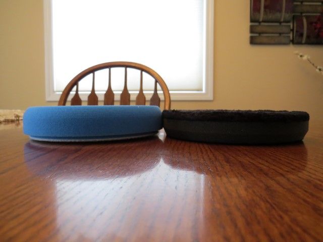

For comparison, here's a BnS next to a traditional foam pad
It's nearly as thick as foam, which is unusual in the microfiber disc market.

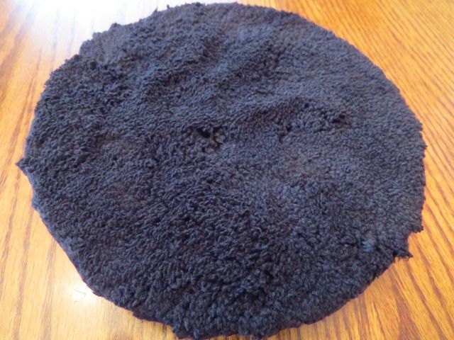

So let's look at the "business end" of each and compare
Again, you can see the BnS is much denser and longer fibers. Running your fingers through that is like shag carpeting vs the Optimum. Both are very soft, so no concerns there. The Buff and Shine also just feels more durable in the hand. You can twist the pads, pull on the fibers and you never feel like you need to worry about doing damage. The Optimum is good, but definitely not on par with the level of construction. Even the velcro is so good that you have to put in some effort to remove it from the backing plate.
