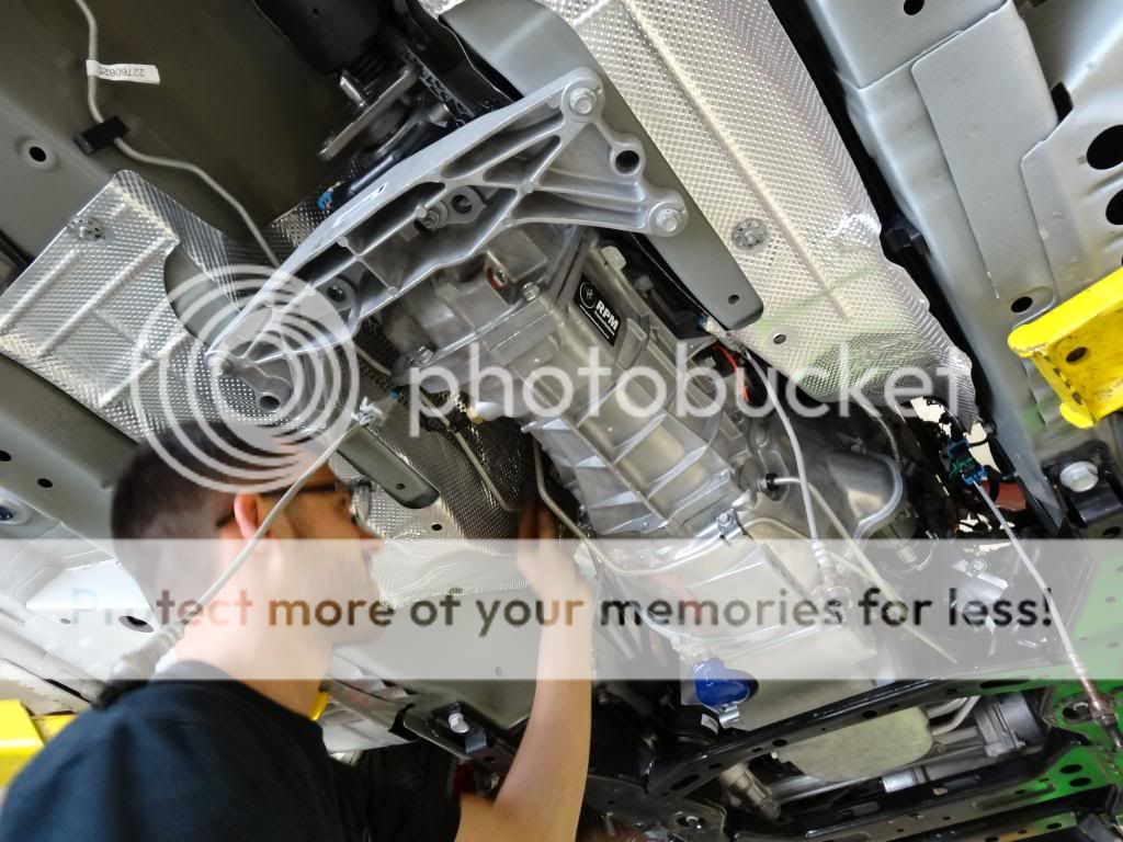

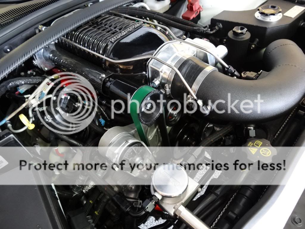

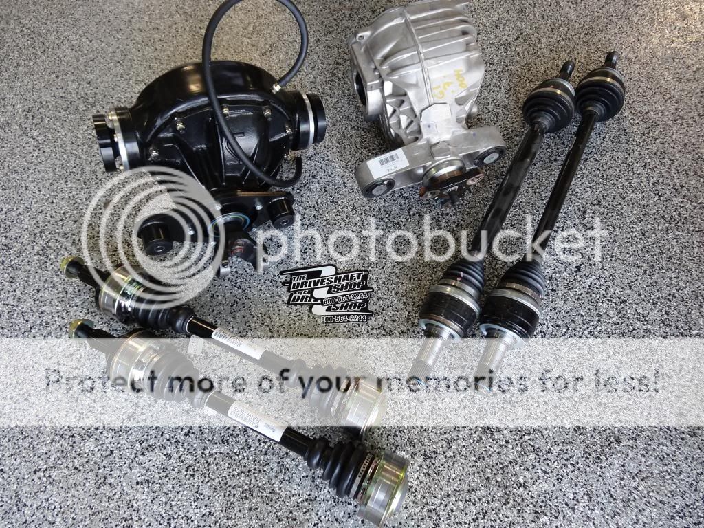

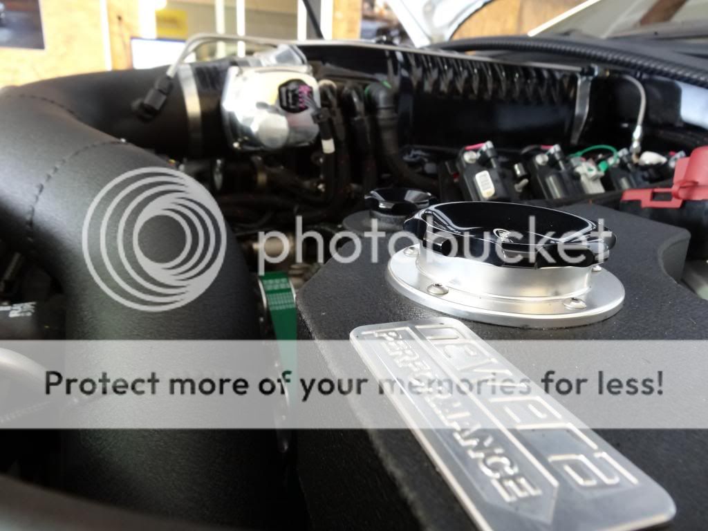

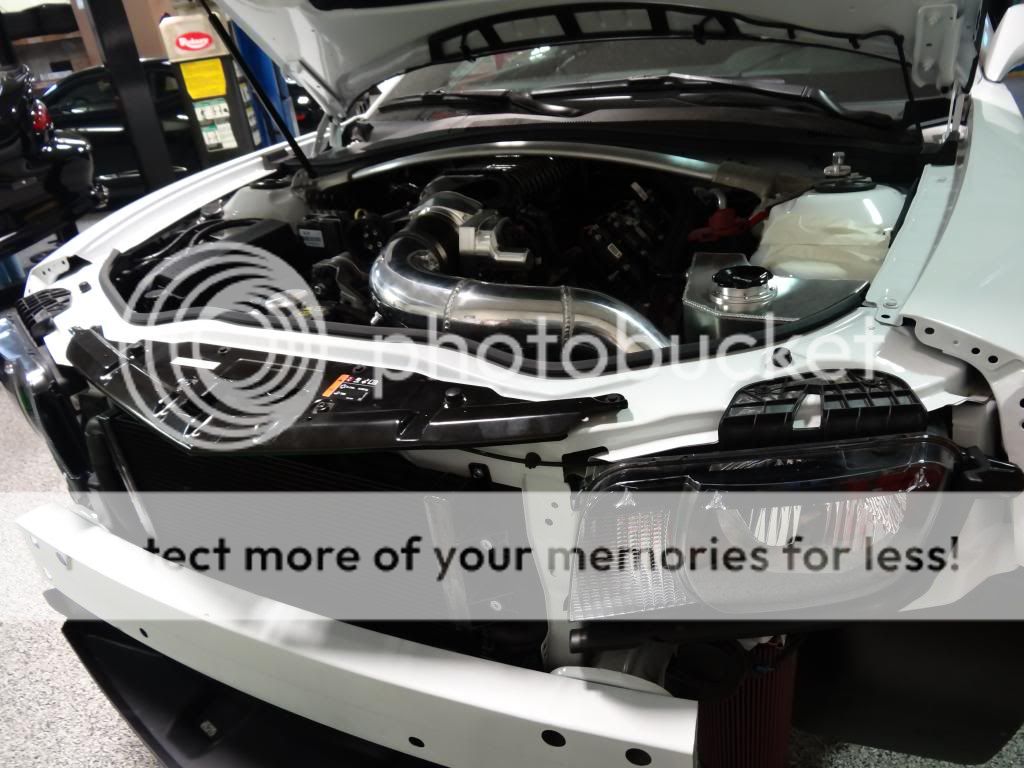

Thanks for the mention! This car is a purpose built street car, to make a lot of power reliably. While it is mostly finished, we still have a few cosmetic things that we are still waiting for to come in. I uploaded a few pics for everyone to check out on this build below.

It's 13 psi, and it has a NW 102mm throttle body.
