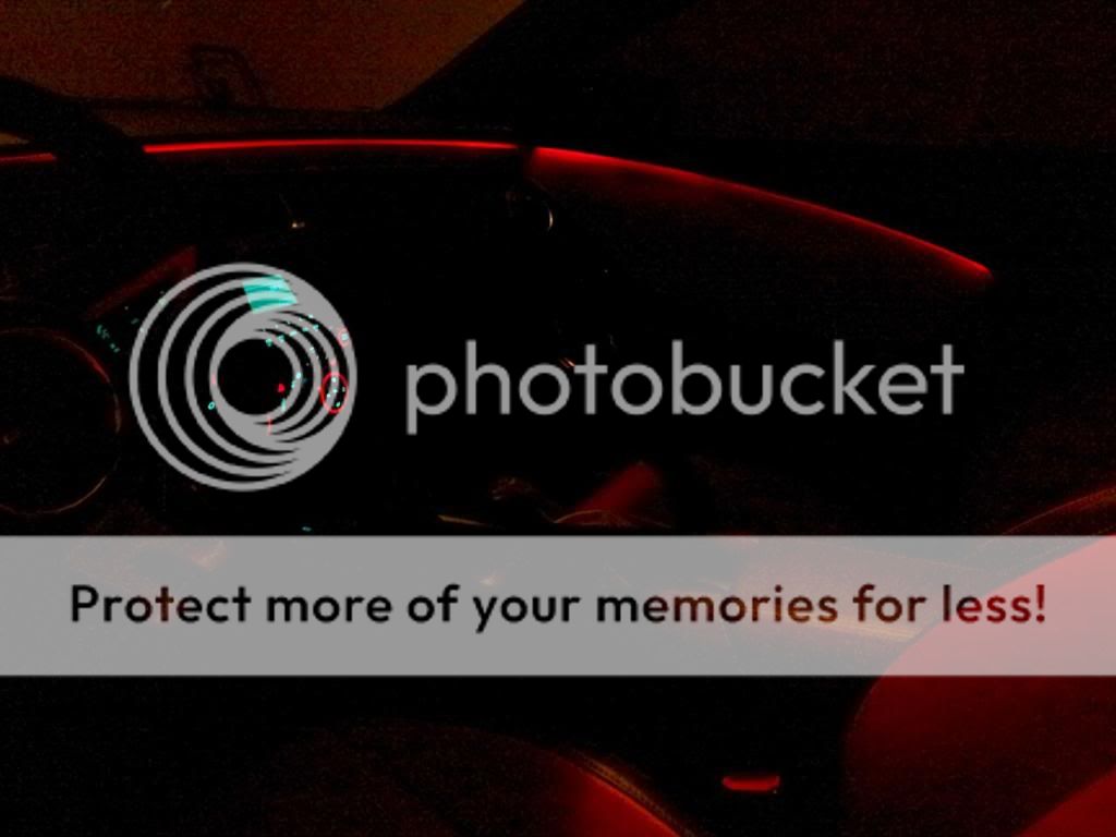

Hey guys. I just wanted to share my experience with adding ABL to my dash (Inferno Orange Metallic ABL on a 2010 Camaro 2SS/RS). When I first decided to try this mod, I had to look through TONS threads and tons of posts to find all the answers I was looking for and I thought I'd post this "DIY" with information you'd need to perform this mod on your 5th gen Camaro so you don't have to look through 10,000 posts. The steps described in this DIY are what I personally did to achieve this mod (EL TAPE METHOD). I'm not really going to post pictures on how I did it because I didn't have a camera at the time I was installing this, but I'll try to be as detailed as I can. The outcome picture is at the bottom.

All in all, it cost me less than $45 for all parts (2 EL Tape portions, 1 12 volt inverter, wiring and sanding materials) to do this entire install. I apologize if I've missed anything. If anyone has any questions on the setup, feel free to ask. I spent hours and hours looking up different threads and posts on how to do this since a lot of my questions I had I couldn't find answers to easily. I hope this helps! My next mod is to do the ABL on the bottom part of the door. Here is a picture of the final outcome. I've also added the secondary LED to the door abl, and sanded the last 6 or so inches so the abl go all the way up the panel.

You will end up regretting the el wire mod. The wire will start to break down within a couple of months that will require another installation. The inverters will put out a high pitched squeal that will drive you insane (until they burn up). I could not find a way to get rid of the squeal. Save your self a lot of heart ache and labor and just go with the LED's instead.
