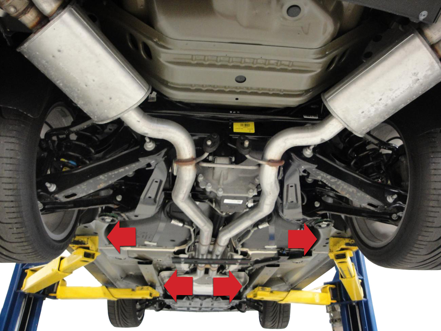

Where to locate jackstands or blocks for winter storage?
I will be storing my ZL1 for the winter soon, and I need to know where the best location is on the ZL1 to locate wooden blocks or jackstands for the winter. I will be taking the tirings/rims off to store indoors for the winter. Any help? If it helps any, I'll upload an undercarriage picture later.

Place the jack stands under the sub frame.

I found this photo of the proper lifting points in the misc gallery at the Z1 registry. http://www.***********.com/gallery.php
Basically, you just lift on the front and rear subframes.
These look like a good jackstand option. http://jackpointjackstands.com/

Do you have to remove the belly pan to access the ones in the front?

No you dont have take the pan off to lift on those lift points.
