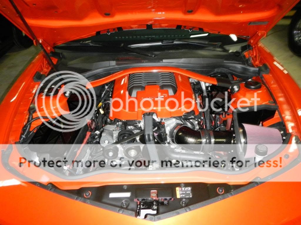

Many people on the forum will tell you that the Roto-Fab CAI is the best bang for your buck mod. Installs easily with no modifications to your vehicle.
Nets huge whp gains for those of you that decide to keep stock ecm tune.
Has been installed on many 700+whp ZL1s so the Roto-Fab can handle any other power additives/mods you decide to add.

I agree we use the Roto Fab intakes on all our camaro packages, even our 800hp FlameThrower package.
