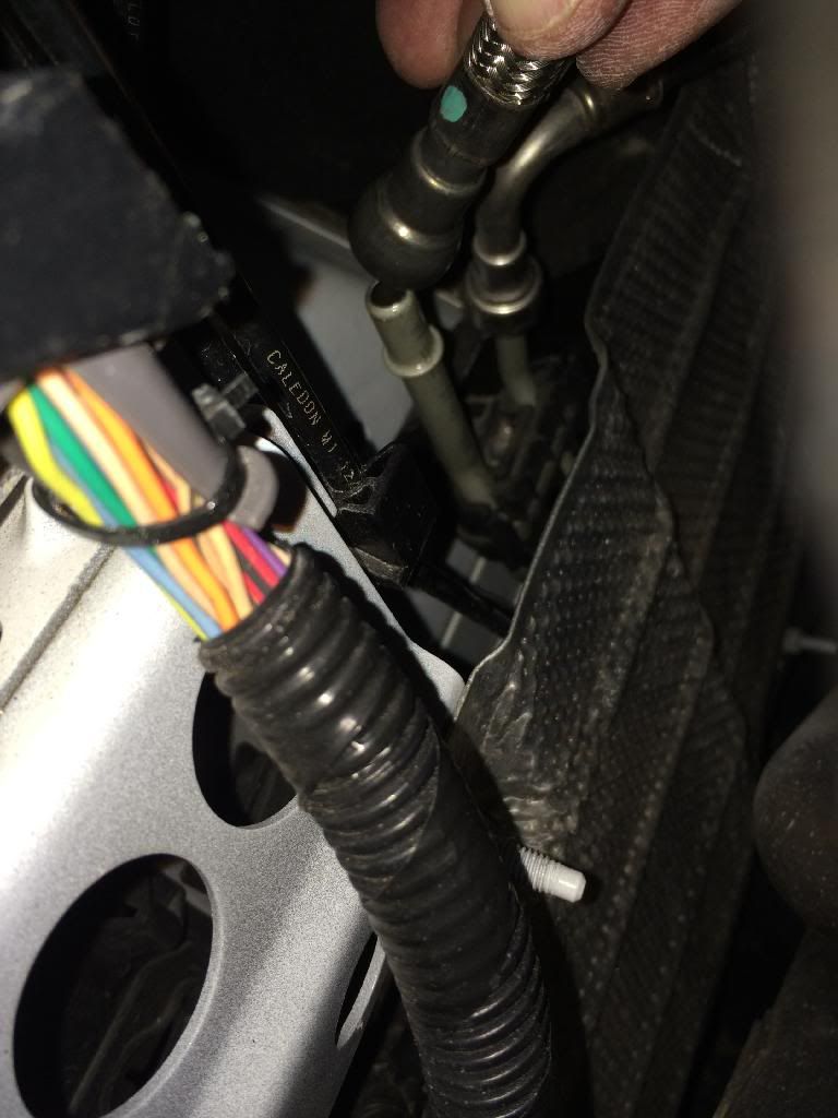

Just flipped my fuel rail and the new line purchased from JDP is too short by 1 to 1 1/4" at least. Pic below:
Any solution to this and if there isn't can I just hose clamp a rubber fuel line in until I can get another one?
This is my daily driver so I need a quick solution.

Nevermind...I got it. I had to pop the plastic bracket that holds the fuel and evap lines at the body.
Then connected the new fuel line to the main fuel line and then pulled up to connect to the fuel rail.
It's tight, but both clips are in place =)
Rob

Originally Posted by LSX Camaro View Post
Flipping the rail and using the C6 fuel rail is a great looking upgrade. It is a snug fit with the fuel line but fully functional and will fit when properly installed.
The C6 fuel line with the stock fuel rail is what I installed.
It's kind of difficult to flip the fuel rail and not install it properly. The fuel line is either long enough or it isn't. On the 2012 SS, the fuel line isn't long enough without popping the plastic "bracket" on the body that holds the main evap and fuel line in place. It was a little uncomfortable pulling on the main fuel line to snap the new fuel line to the rail but I did it.
I think later this week I'm going to get in there is little further and inspect what kind of pressure is being put on the main fuel line. I'm not 100% comfortable with it but I'm not too worried considering the number of people that have done it and haven't reported any issues.
Rob

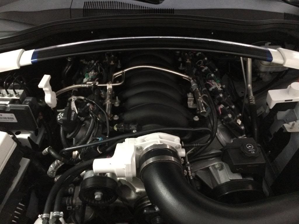

Here's a cell phone pic of the final install. The plastic intake shell is removed and I didn't bother putting it back on.
Rob

Looks good!!! I'm doing this in a few weeks. Itll go nicely with my new engine bay set up.

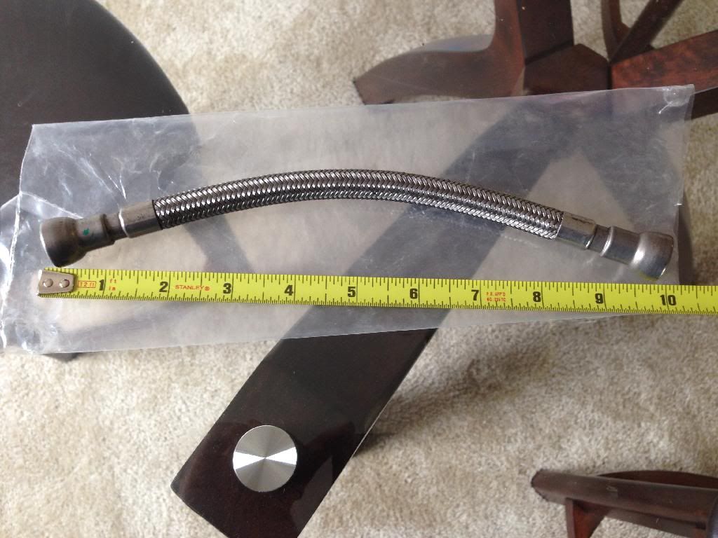

Originally Posted by Denis View Post
Just got one delivered today!
Hey Denis, can you measure the length of the C5 hose you received?
thx in advance
thx in advance
